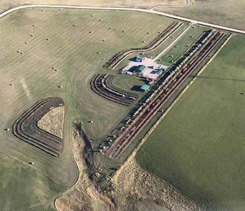

I have posted before that I am upgrading my tiller this spring. I am pretty much down to a JD 681 or a Landpride RTA3576. I have miles of shelter belt rows to till. I have been using a King Litter 72 inch tiller for the last six years. The reason I am upgrading is I am adding a 1/2 mile four row shelter belt this spring. The KK worked great, but I thought with the new shelter belt I would be asking to much of it.
I actually sold the KK to a neighbor for his garden.
Several friends of mine have the JD and it is very heavy duty. Both of those were used commercially.
The LP an the JD are actually about twice what the 84 inch KK would be.
I think the KK would work fine for most gardens.
But the others would too, just more money.
I'll include a picture of my old tiller and what I used it for in another post.
/ Roto Tilling #15
This is my old tractor with the KK 72 inch tiller. Ironically it is a JD too and I loved it.
The aerial photograph is my property and the shelter belts I have been tilling with the KK.
Best of luck to your neighbor. It is sure fun shopping for attachments.
