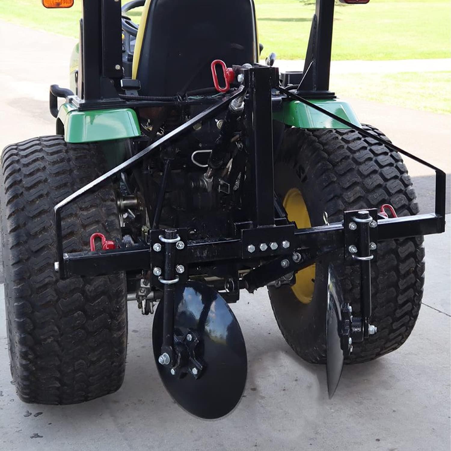

My wife grew up growing a garden using raised rows which are a lot of manual work if you don't have a machine to make them. There may be an attachment for the tiller that will make them or you can buy a 3pt hiller attachment if you want to do raised rows with the tractor. The 3pt attachment can also plow the furrow for planting while making the raised row which saves a lot of manual work.
That's a very good idea. Raised rows would be ideal for many kinds of plants. I'll look into that. Thanks.
Here you have to do a lot of math :)
think about distance between wheels and wheels width.
here a picture that I stole from an online store
You have to understand, how big rows you can do and how big gap will be between rows
If that fits to your concept - SA will be great machine
