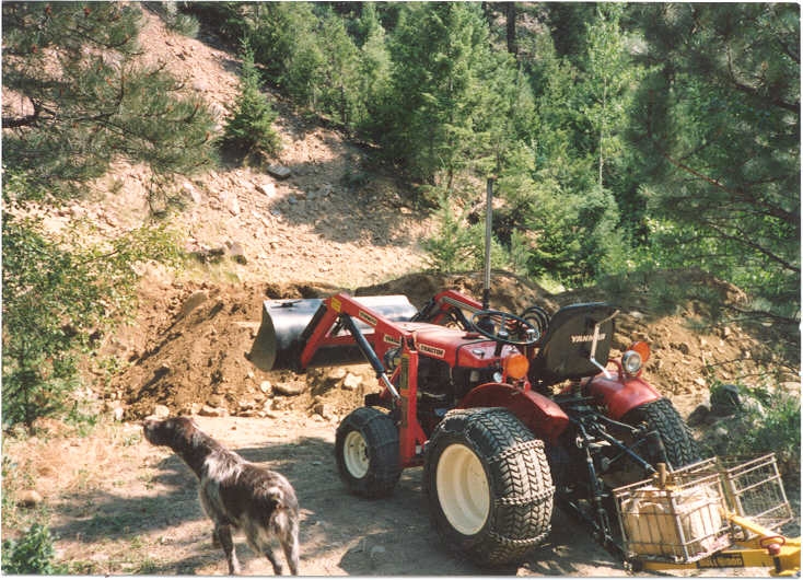

We built most of our place with a 16 hp Yanmar - including foundation and septic. It took longer, but far easier than if we had to do it by hand. The time that a bigger tractor saves is offset by limited access, and tractor time is rarely most of the time in a project anyway.

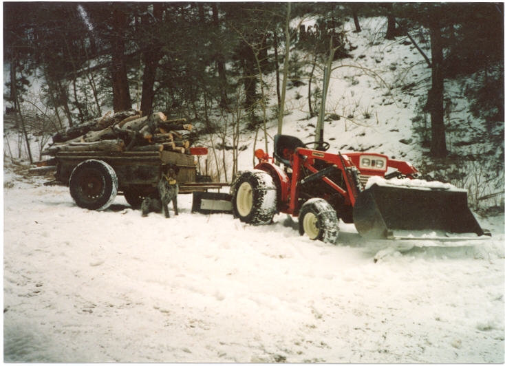

Instead of loading the tires, I made up a very minimal set of rear tire chains. Started with several sets of the smallest automotive tire chains I could find - used ones of course. Then a vise and pliers was all it took to make some custom chains. Even small ones as shown probably triple the traction. I often ran them year round.
