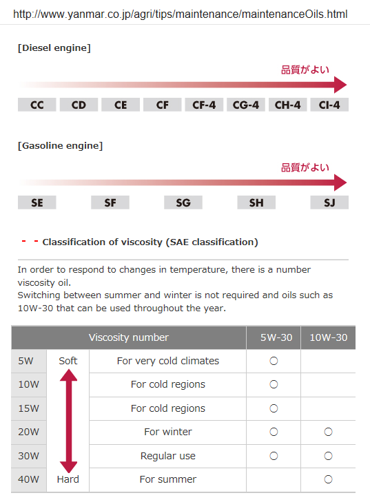

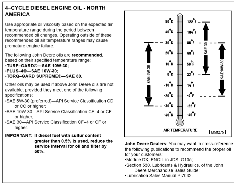

Not certain really.
The vintage Yanmars of the YM, F, FX, RS, KE, era machines are 5W30 winter and 10W30 summer. This is per the Yanmar and Deere docs.

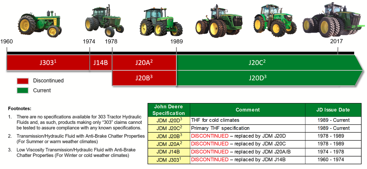

Reviving this thread. Has anyone had any issues using 5w40 or 15w40 in their tractors? I have seen some posts on TBN that we should only be using 10w30 and not a 40 weight oil due to heat retention. Is this more important in the thermal syphon systems or all Yanmar tractors? I have have been using Rotella T6 5w40 since I got my tractors and haven't had an issue, but I also don't want to have any negative side effects down the road either. I am willing to put 10w30 in them if that is truly the case. I live in Nebraska and the summers it can get over 100 degrees and long stretches of 90+ degree weather.
Open to any suggestions or experience negative or positive, let me know.

From old postings in the YTOG archive (GeoCities 1996/Yahoo) up to 2019, using 15W40 has caused over heating retention and heads warping with gaskets blown. More often with the 2-cly engines. It does happen with the 3-cly engines too.
Both Deere and Yanmar point to 10W30 and SAE straight 30W for summer uses. Yanmar vintage machines, key word is vintage, are engineered to JIS specs and not SAE. Thus the oil passages and clearances are much tighter.
I use Rotella T4 10W30. And this year has been the coolest summer I can recall out in the northern mid-west. I would swap to the SAE 30W if it got hotter.
This is the official Yanmar 10W30 oil for our vintage YM, F/FX, KE, RS and other series machines before 2001. (y)

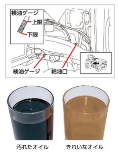

Some of the Yanmar YM domestic manuals do have errors using the wrong oils. I went to the official Japan site to get clarification. This is the reason for the screen captures I posted here from pre-2018.
Likewise, Yanmar manuals also state to use Deere 303 hydraulic oil, yet it's banned in several counties do to it being SPERM WHALE OIL.
When Yanmar teamed up with Deere and created the John Deere & Yanmar Engineering Co. in Japan, they began review old fluids to make improvements.
