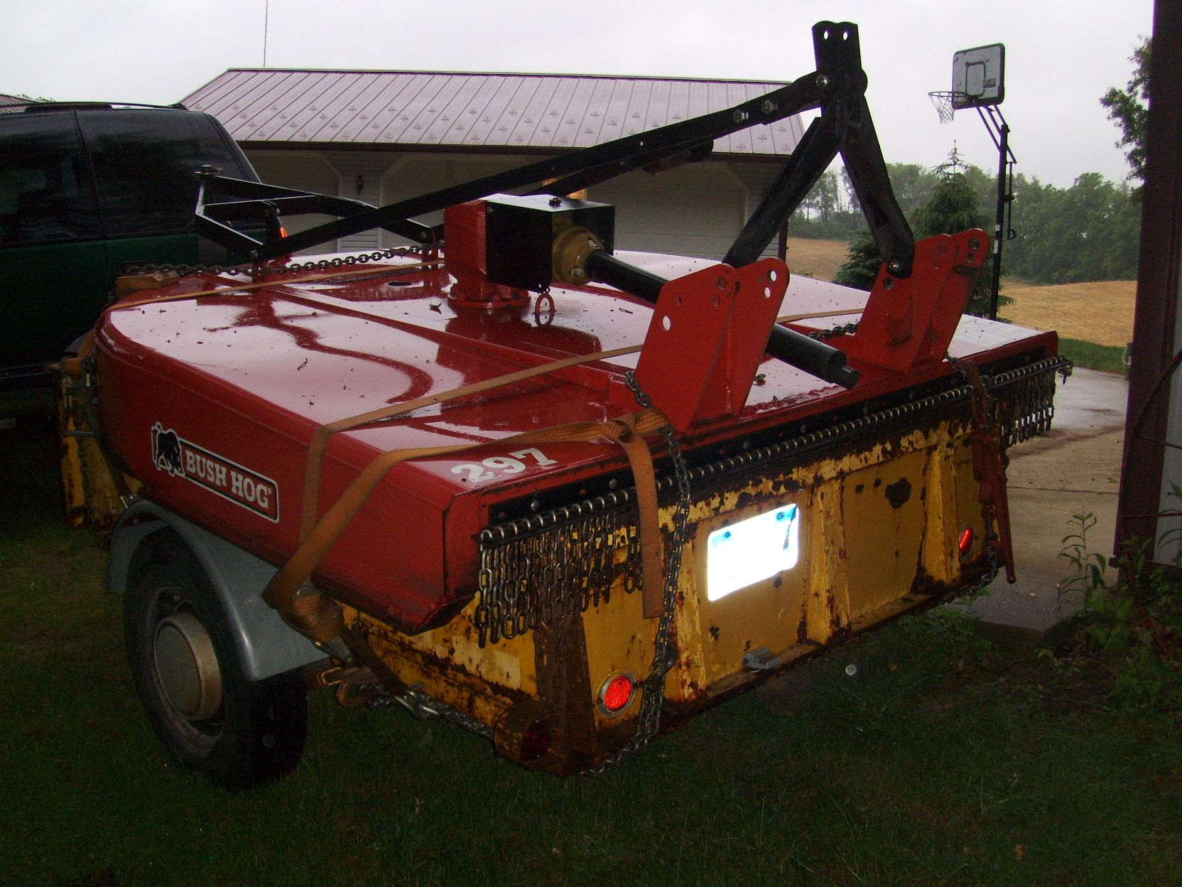

I bought used so brand was not main consideration.I did want a HD top of the line model. I would have bought Bush Hog, LandPride, Rhino, or Woods. I really liked Woods ease of blade removal. I found a Bush Hog 297 for a great price and bought it
