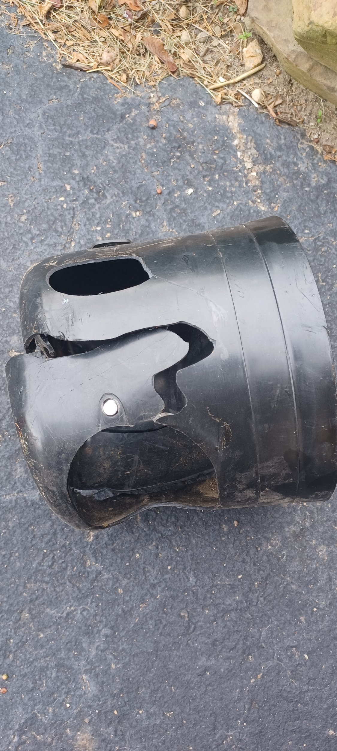

OK blew up my shield on my rotary cutter at the back end of my drive shaft where the shear pin is.
Shear pin broke and blew a hole and completely shattered tre shield. Pics attached.
Where can I purchase a new shield?
Rotary cutter is a Titan 1206.
Btw went thru a bag of shear bolts clearing some heavy over tractor cab high brush. Bout 10ish years old (the brush).
Any help sourcing the shear bolt cover greatly appreciated.

If it were mine, I’d just wrap duct tape around it if there is enough plastic material left to do that. A new one would probably end up in the same situation, and they’d probably charge you an arm and a leg.

Shouldn't be too hard to find. I found this in about 30 seconds...
/ Rotary cutter rear u-joint shield?? #5
Contact Titan and ask who their PTO parts supplier is. You may be able to buy direct.
Your local tractor dealer probably can help.
/ Rotary cutter rear u-joint shield?? #6
Titan won't sell direct, but most any tractor supply will have one. Also, going through sheer bolts like that, I think I would consider a slip clutch.

Tried that the after the first 2 times I blew it up. Useless couldn't even get the customer support person to understand what I was asking for even tho I gave her the part number from their website and helped her locate the webpage with the part number. Yeah wow....
I hear you!
I'd take the assembly to the tractor dealer to see if they can find a match from their PTO suppliers. If you have some sort of mystery chinesium product you may have trouble.
I find telephone customer support to be iffy these days and I'm lucky to find a knowledgeable support person on the other end. I'm lucky to have a few go-to guys at my local dealerships that are willing to take the time to help.
