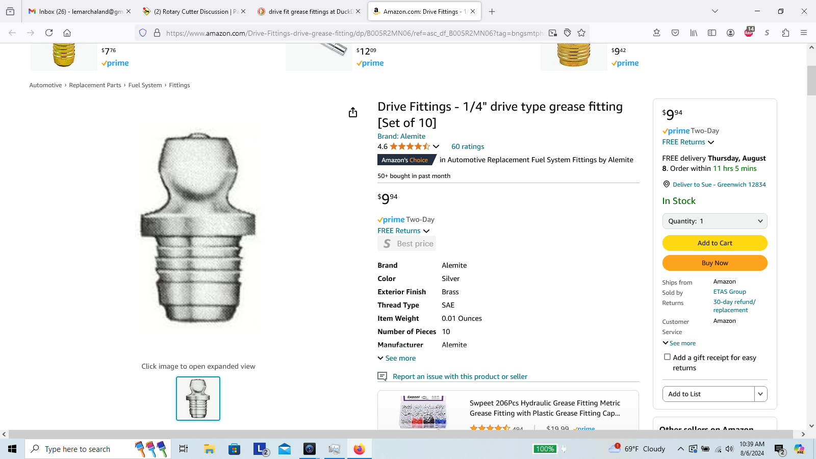

There are 2 types of threads on grease fittings, SAE and Metric, so they may not be stripped, and you may already know this but just in case there it is, also Harbor Freight sells a kit of both SAE and Metric grease fittings, I have one of each and it has been invaluable.

You may not have stripped threads for your grease fittings, much of the lower cost implements may have drive in grease zerks they will look similar to threaded ones but just drive in, more like a barbed hose fitting.
/ Rotary Cutter Discussion
#52
@LouNY
Thank you for this! Now that you say this, that is exactly what I have. It was missing, so I had no clue. Much appreciated!!!

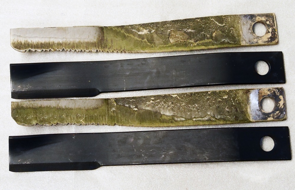

I mowed a bit more this past weekend, broke two sheer bolts (pins?) within the first 30 min... granted, this was MY fault, not seeing dirt clumps.
Kind of surprised to hear about the broken shear pins. I've been using my General (Rhino SE-6 clone) for 25 years now and have broken only one shear pin in all that time. And that was not from hitting mounds of dirt (my place is covered with huge mounds created by badgers, the mower just levels them out) but from inadvertently engaging the PTO when the tractor engine was turning at speed and the cutter not rotating at all.
Here's a pic of my old mower blades versus a set of new ones...those old blades mowed a lot of dirt and rocks!
I'm running at 2300 engine RPM on a 55 hp tractor, 47 hp PTO... don't know if that makes any difference. This cutter has sheered 3 since I began with it. I'm surprised as well, because I really don't think I hit anything out of scope... Good thing it's super easy to change. I'm definitely looking at adding a slipper clutch... 👍🏼🇺🇸
