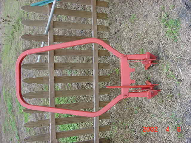

/ ROPS Pictures/specs #39
Here is an image of a ROPS mount that uses the top 3 point mount to spread the forces. I welded a plate with bolt holes in it to the top 3 point plate. The ROPS will unbolt from the tractor and does not connect to the axle housings. The lower mounts bolt to the side of the differential case. I had to buy some metric bolts ;<( The tractor is a 1500D

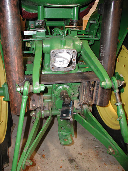

/ ROPS Pictures/specs #40
Another image of the ROPS 3 point bracket before it was done.
