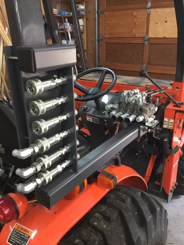

#24
Finished the bracket. Showing front armrest/brush guard. The standoffs are slices of 4x6 tube.

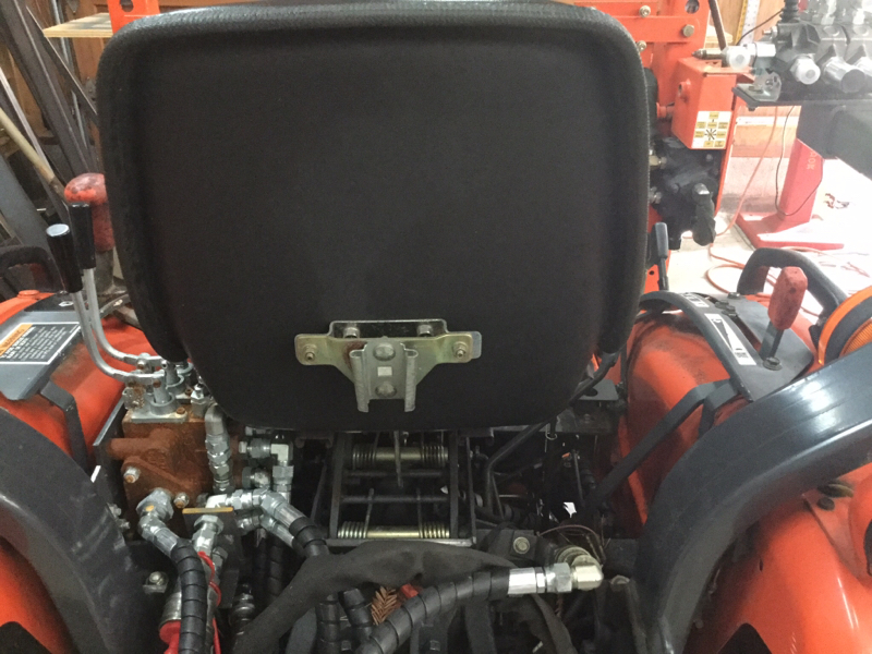

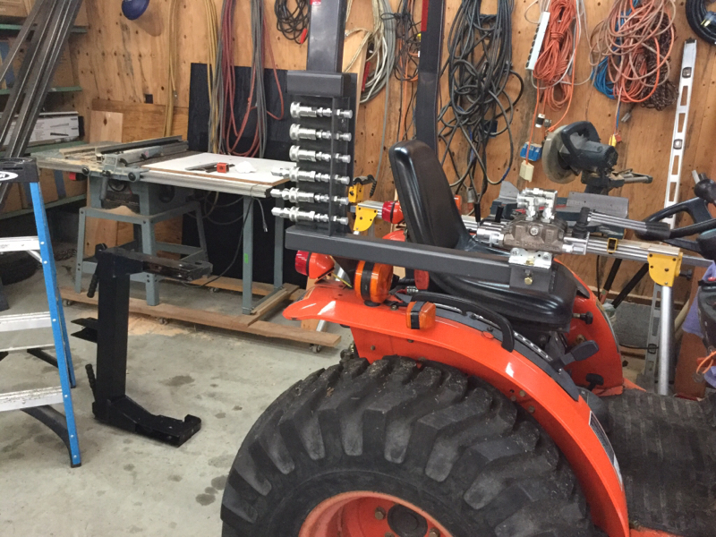

Got the first set of hoses installed. As planned can slide the valve about 8 inches so accessible with seat forward and backward.
/ ROPS Mounted Auxiliary Valve #30
Not much room on a B21 for extra valves. I tucked a two spool valve on the left side between fender and seat. It is equally accessible from the seat facing forward or backward. But there is no room on the right side. So I mounted this one on a bracket that attaches to the ROPS. It can be adjusted up and down and the valve slides back and forth to get the best location. Fully forward is good when the seat faces forward. It can slide back to be accessible when the seat is facing rear. View attachment 456162 View attachment 456163
