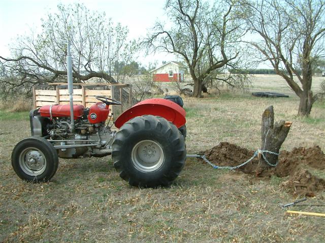

My first tractor was a new 2005 Kubota B7510HST with 4WD and the LA302 FEL. Not a good tractor for working on steep slopes. In fact, I nearly rolled that tractor while using the FEL to scoop loose dirt in a pile on level ground. The right front wheel dropped into a wheel rut and I had to drop the bucket quickly to prevent a rollover.
If your slops are more than 20 degrees, you need to find a tractor with a low center of gravity and wide wheel stance. Take a steel tape measure with you when you go tractor shopping. Measure the width of the rear tires from outside to outside and measure the height of the center line of the rear axle. The ratio of width to centerline height should be ~4 for working on steep slopes.
My 1964 MF135 diesel has a 4.15 ratio. These photos will give you some idea of what that ratio looks like on a low slung tractor that is set up for work on slopes.
Good luck and be careful out there.

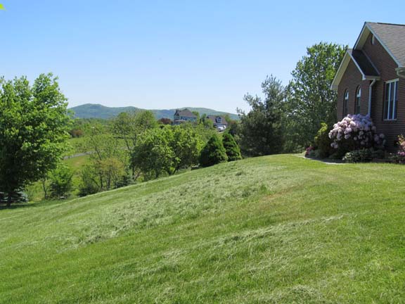

Here is a picture of the worst slope, at the top of the hill where the house sits. It does not look as steep here as what it does in person. What percent slope, can anyone tell? The worst part of it is the swath right after it falls off from the house, in line with those two evergreens.
Except for that little piece maybe, I used to mow across a hill like this on my John Deere 970, 33 hp. 4WD with weights on the front and filled rear tires. In my came-with-house JD lawn tractor, I am afraid to mow a lot of it going across and have to run up and down. Climbing is interesting.
Not sure this is a BX or a B hill.

photo of slope
Trying to post it here. As I say, it looks worse in person, especially after it first falls off. The hill has a series of plateaus between steeper slopes, and random dips and rises.

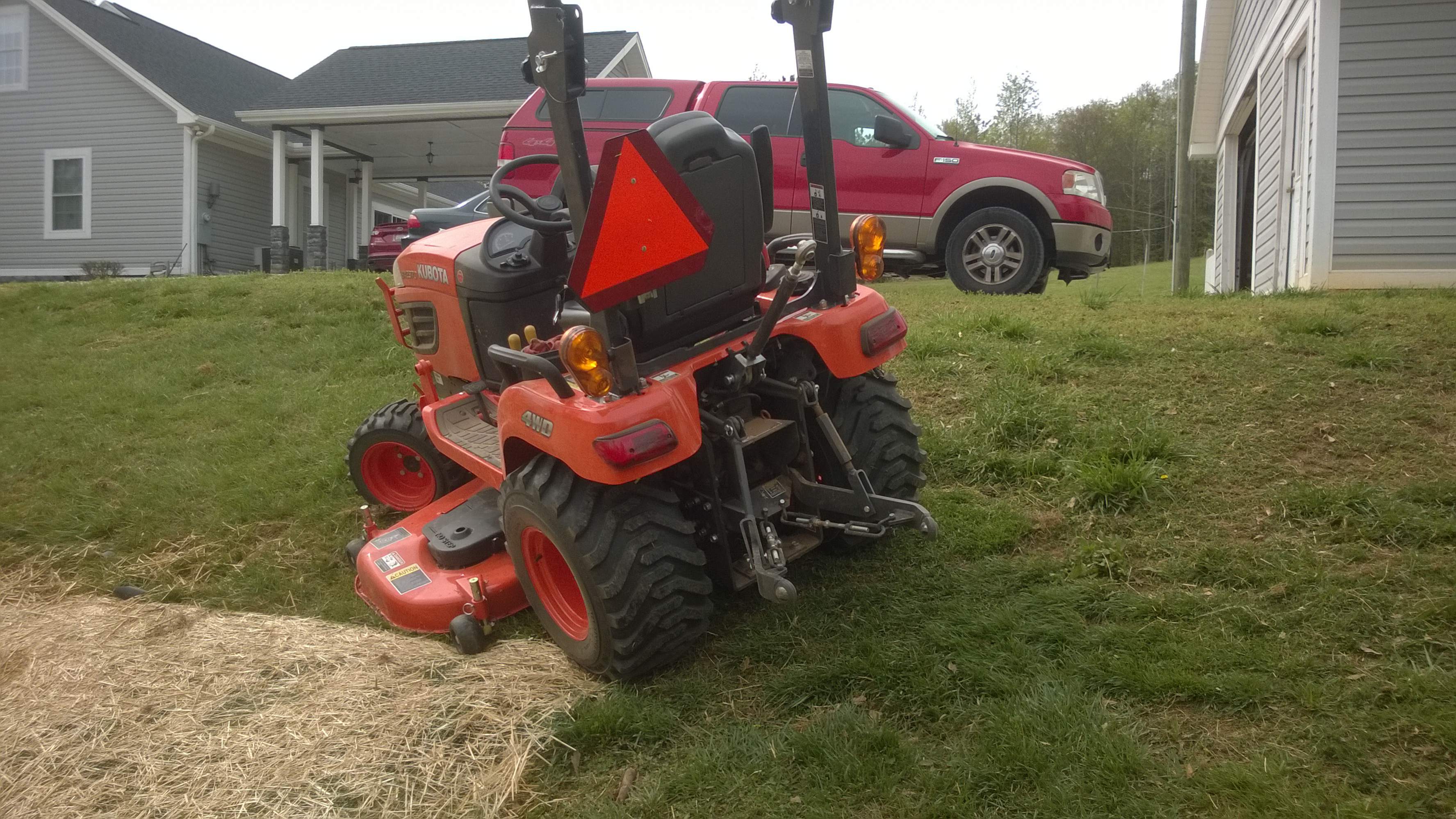

My BX-2370 does very well side-sloping and from the looks of your photo, I'd very comfortably side slope that all day long. I have my rears filled. This tractor is so much more stable than my JD L118 lawn tractor was. I feel very much more comfortable and as an added bonus, I don't feel the need to lean out over the uphill fender. It doesn't need it. It's heavy enough/low enough COG already, that my body weight doesn't have an impact. The steepest areas that I used to only mow going up and down with my lawn tractor, I now will side slope with the BX. It's much much faster for many reasons and I'm really glad I made the change from L3800 tractor and JDL118 lawn tractor to BX-2370. If I miss anything, it's not the JD lawn mower. Good riddance to that thing.
I don't have a B, but had an L and the BX is way less tippy feeling than my L was on the same terrain. I will side-slope stuff on the BX with no sweat at all, that I never would have tried with the L.
As others said, I remove the FEL and any rear attachments when I mow.
/ ROPS height, BX vs. B, and slopes! #14
Based on the pic, it does not look too steep.
I have a BX with a belly mower and I mow what may be a similar slope. I take it slow and never mow with the loader mounted. There is one spot where I don't mow across the slope, I go N S instead of E W.
It's a comfort thing...if you are unsure then probably best not to risk it.

I have one area at my other property that I mow side-hill that is steeper than the above pictures, but those are all I had on my phone camera. I can tug on the side handle on this and the other slope to kind of slightly "rock" the machine and it's still not tippy even at these angles. Drive slow though on the steepest stuff because if you run into a hole on downhill side or hit a big rock or bump on high side, it could then cause it to become more tippy.
