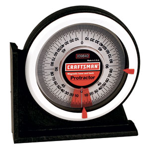

Rather than guess at what your slope is by us looking at the picture you provided, it might be best to take a measurement of your sloped lawn.
Here is what I use to measure my sloped lawn.
I got this protractor from Sears and it'll give you the slope measurement in degrees.
I took a 6 - 8 foot 2x4 and placed it on the ground first , then placed the protractor on the 2x4.
I've got 19 degree slopes that I use my Husqvarna R322T AWD on without any issues.
My old Wheel Horse garden tractors (2 wd) had traction issues on the same slopes and I had two instances when the Wheel Horse GT went over backwards, because they lost traction then suddenly gained it back, causing the front end to rise up quickly, and over backwards.
No injuries in both cases, just spilled gas and oil.
I recommend either AWD or 4wd as a minimum, in what ever you choose, but if your slopes are too steep you may want to look for something that's made to handle slopes better than a Kubota BX.
IMHO ...The first step is to figure out what you have for slopes, before doing too much tractor shopping.
