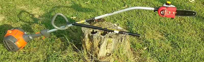

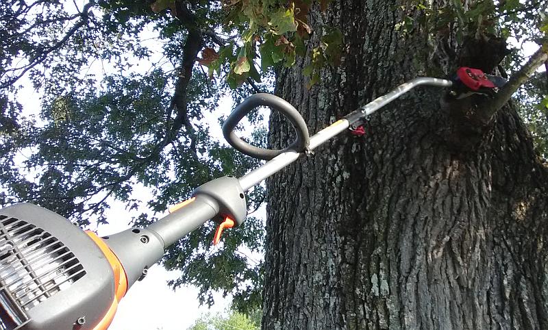

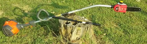

I do things a little different sometimes. Got one of these Trimmer Plus pruner add-on for trimmers with shafts that will take extra tools. It comes with the straight black shaft shown plus one extension boom. I gutted the curved shaft from a now-defunct trimmer head and fit it into the pole saw head. It's a quick screw or three to go back to the straight shaft as needed. Still limited to around 10-15' based on how high you can lift the whole thing once assembled, and it does got a little difficult to manage. Better than the blade/rope type pole saws for lower branches, but doesn't have their reach for higher ones.

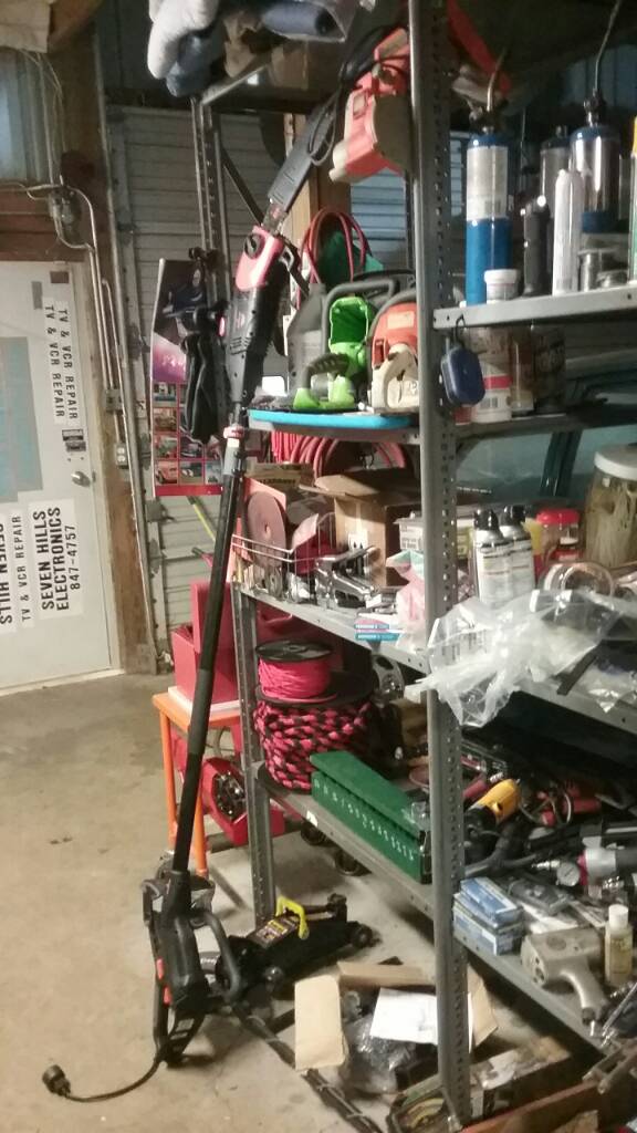

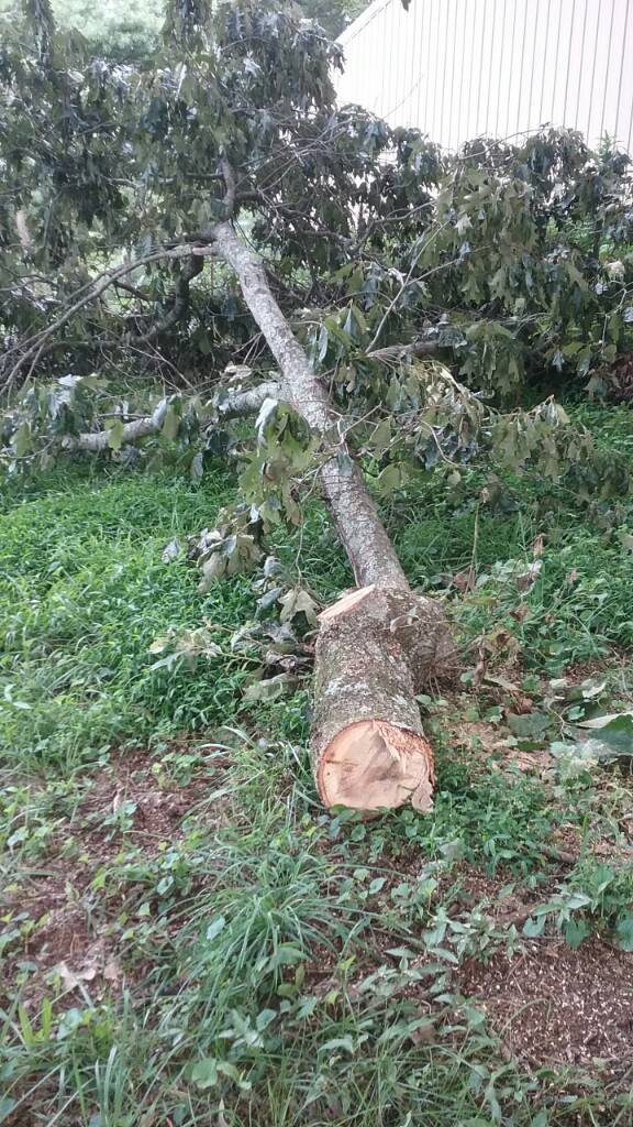

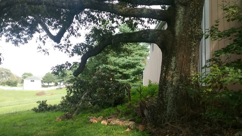

I'm really pleased with the Remington electric pole saw. I cut some great big limbs easily. It's heavy but that's an advantage cutting through and it detaches to make an electric chainsaw.
I also ordered a rope saw, Amazon.20180815_170307.jpeg20180815_170446.jpeg20180815_170501.jpeg
