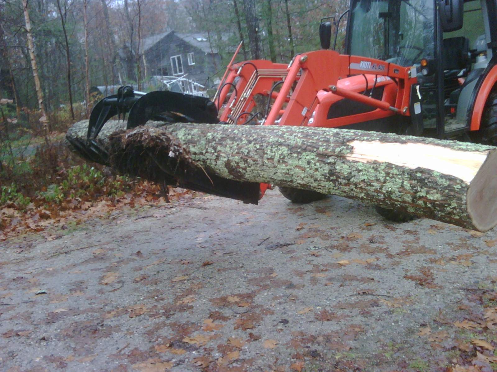

I have a 48 inch Millonzi (no longer made) that is very similar to the Gator/exMarkham. Might even be a lighter build. I beat the crap out of it and it still keeps going. A little more snaggletoothed then when I got it but it works just fine. My single favorite and most important implement in clearing land. It is mounted 75% of the time.
Main point in maintaining a grapple is to use it to dig and lift but not to twist it by putting asymmetric loads on it. You cannot hurt the grapple by lifting or pushing straight with a DK40se.

IslandTractor's pictures say it all! That is pretty typical of what a grapple can do. Only thing he doesn't show is it's digging ability (like digging out that stump) Try doing all those things with anything else. Since following his advice several year ago, I could not be more happy. One note, if you are concerned about the "light duty" label, you can (or at least could when Markham was in business) get the same grapple but with 1/2 steel. I also had them add some more spacers to make the gaps smaller between tines. This beefs it up a little without adding too much weight. My tractor is 70 horse so I wanted al little more strength. Oh, get a 48" not anything wider. I think that is important.
