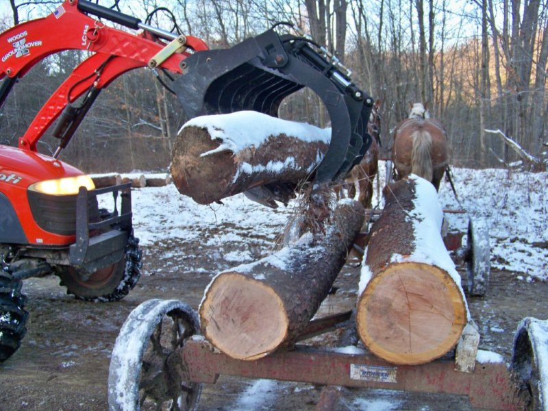

I have been searching and I see a lot of guys have designed and produced their own root grapples. Does anyone have CAD drawings they would be willing to share? Any tips/pointers as I approach the design/fabrication?

I've done the shopping, I'd prefer to fab. I need a winter project anyways.
I'm not a huge fan of the offerings on that site. I want a grapple that has hydraulics along the back like a 4 in 1 bucket. I already have a grapple bucket where the tops touch only the tip of the bucket and I don't like it. I want something more like a clam shell so I can pick up and squeeze logs and brush.

I built my own with the help of my two sons. One does computor drawings and the other has a weld shop.
The tractor is a Dk55 and i can load logs or pick up about anything.

It takes a lot to put one together.
I used AR400 3/8 material then had the drawing and the plate sent out for lazer cutting. The plate was over $600. and the cutting was $175. We layed the drawing out so I could get everything out of a 4x9 ft sheet.
I bought two cylinders and other materials , Plate, tubing, welding supplys.
The easy part was welding it together.
The hyd. hoses are 3/8 from the valve in the rear of the tractor.
Hope this helps.
