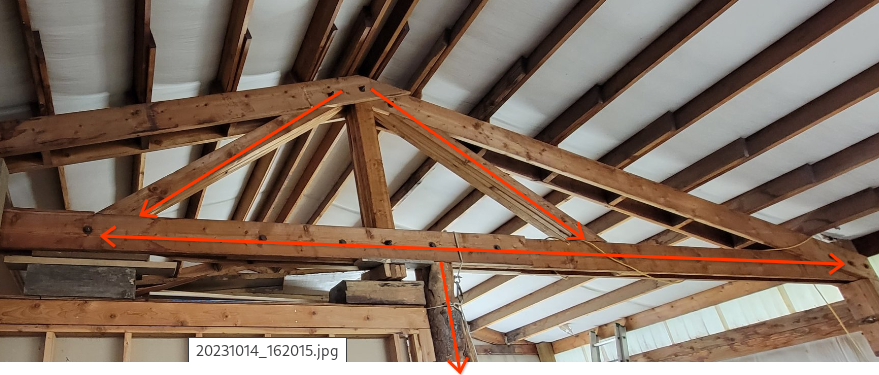

Lots of people think they know how things work - but really don't. A number of years ago I read a lengthy piece in a farming publication my FIL subscribed to. There was a big story on building collapses during a larger snowstorm. Most were caused by owners doing mods to their buildings after the buildings were completed by the contractors.
One of the main problems was making attachments to the bottom chords of trusses for walls or stall dividers. Some were homebrew "supports" that owners added. When solid attachments were made, it changed the dynamics of the stresses and didn't allow for the truss to flex as it should. The "support" created a failure point.
They had pictures of good and bad connections. The bad ones created a solid connection between the floor and the truss. The good connections were made solid to the floor and went past the bottom of the truss, going through a guide so the truss could slide up or down.

I have similar sized pole barn (36 x 50). A friend put the shell up for me in 2018. I used reclaimed materials, from a couple of my great great grandfathers old post and beam barns, to add a loft and shops inside the new pole barn.
The 10 ft truss spacing of my pole barn worked out very well for that. I attached the tops of my old hand-hewn American Chestnut loft posts to those trusses, similar to how you attached your support post, to the broken beam:
