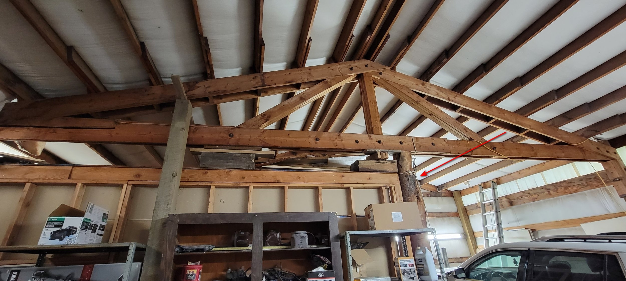

I agree with the others about the truss not being built properly. I also agree that there needs to be something connecting both walls together that will stop them from spreading apart.
If it was mine, I would move that wall so it's under the failed truss and make it a load bearing wall to support the roof.
Removing any parts of that truss can lead to other issues that I wouldn't want to deal with. Scabbing on new lumber to the broken lumber would make it better, but not solve the problem.
Then I would build brand new trusses on either side of the existing trusses. There are charts for how to design a truss for how far you are spanning. I would do this for every truss in the building. And if I got really crazy, I might add a truss between every existing truss just so I wouldn't have to ever deal with it again.

I am not a roofer so some of the terms and physics here are beyond my knowledge. Can someone explain in layman's terms what it means that the horizontal beam is "in tension"? Does that mean the horizontal beam is being pulled horizontally towards the walls (preventing wall bulge) rather than being pushed down by the weight of the roof?

"In tension" means it's being pulled on. "In compression" means it's being pushed on. The bottom cord is supposed to be under tension. Because of the incorrect design of that truss, the bottom cord is receiving significant downward force where those diagonal braces attach to it, which is why it broke. There should be no downward force on the bottom cord, other than what it's getting from it's own weight and whatever is hanging from it, like a finished ceiling. Sistering another board to it is just kicking the can down the road, not solving the problem. If your neighbor insists on doing that, he should, at the very least, get rid of those diagonal braces. They're causing most of the problem.

IMO the biggest weakness in the truss is the lack of gussett plates. The truss is secured at the joints by what appears to a few bolts.
At the outside joint the forces are being applied in line with the grain, causing the bottom chord to split and then crack.

Couple updates:
  • The shop is approx. 50 feet long, and 30 feet wide
  • There are 4 sets of struts about 12 feet apart
  • The cords are made from a pair of 2x10's
  • Both sides of that one truss cord are fractured
It looks like there was an ~18 inch piece of 2x6 nailed into and parallel to (as in vertically oriented) the 6x6 wall post. The truss cord butts to the wall post and rests ontop of the 2x6 giving it additional support.
The 2x6 failed (splitting along the grain where the nails attaching it to the wall post were). The truss cord has slipped below that under the edge of the truss
So the plan of attack now is to try to shore it up to the best of our abilities, and then have someone look at the entire roof and make some recommendations.
1. we will try to compress the 2x10 cord and compress the gap in the split as best we can
2. We will remove the failed 2x6 from the wall post and replace it with a 6x6 or similar that runs from the cord to the ground
3. we will then sister in a couple of 2x10s along side the split chord to stabilize it
4. We will replace the "tree" in the center of the truss with a 6x6 or similar.
That should help considerably and then we can look at other options with an engineer.

At this point, I concur with everyone, we don't want to remove any of the old truss and that is not in our plans. Just re-enforce it and sister it together - adding two more 2x10's to the cord, and putting a 4x4 post under the wall edge of the cord where the former 2x6 failed. Keep it simple and as was said in an earlier post, kick the can down the road until he can have someone qualified look at it!
