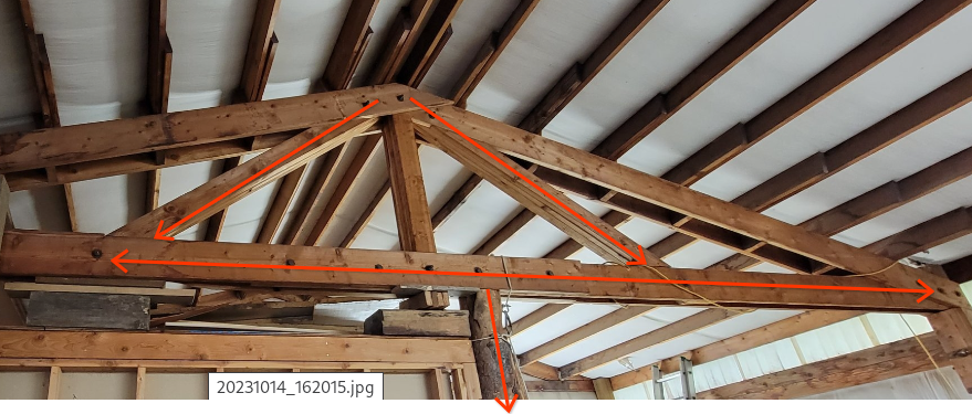

Every time you modify something, or remove part of a structure, you cause damage to what's remaining. It takes a lot more figuring out of things to know what you will end up with after the modification, then it does to do the modification. None of us know what is going on with that truss enough to suggest making any changes to it. Assuming that there is a ridge beam that can support rafters if the truss is modified isn't something I'm on board with, or willing to encourage.
Fix what's broken, make it stronger then before, and add more to it, but never do anything that makes it weaker.

This thing has already broken once and several people have already had expressed different opinions on how to make the repair and whether the truss should have been designed and built this way. That's not a good situation to step into for someone trying to make a repair.
I'm just hoping it is now stable enough that a snow load this winter won't break it.

But we do know what's going on with it, or at least those of us who are intimately familiar with that style and dimensions of construction do. 30-40 ft. wide post frame buildings are ubiquitous in the OP's area. I live in one, in fact, as do many of my neighbors. I also build them, regularly, using the same methods I've been describing. The design and methods to build them are very well known and understanding the forces involved is not complicated once you've worked on, repaired and built enough of them.

I'm a contractor and I get a lot of work fixing what others have done wrong. Usually it's removing something that they where positive didn't need to be there. Only thing worse then somebody modifying something, is telling others to modify it without actually have hands and eyes on it.

I wouldn't remove the bottom chord, because even with the left side of the (bottom) chord broken, there was still some tension functionality served with the rest of the truss - particularly once the bottom was braced:
Yes, putting in a ridge-to-floor support probably obviates the chord. Probably.
The only thing I'd consider is putting in a few extra studs in that wall right under the king post and remove the tree trunk replacement and regain that few inches.
Otherwise I wouldn't take it any further than he's already got it... but I do look forward to the next 10 pages of this thread now that the op's done ;)

In case it wasn't clear, I wasn't suggesting that the bottom cord could be removed with things as they are now. I was suggesting it could be done if there was a single, floor to ridge post, as you mention. But, as I said before, I think he's fine with things as they are now (at that truss).

The truss in question here didn't have a "designer" per se, other than whoever built that building. That's clearly not a commercially made, engineered truss. The member failed because of the "design", not because the design was modified.
/ Roof Beam replacement. #76
some people are recommending changing the truss by removing lower chord. Making center column in two pieces drastically increases stress in the joints
