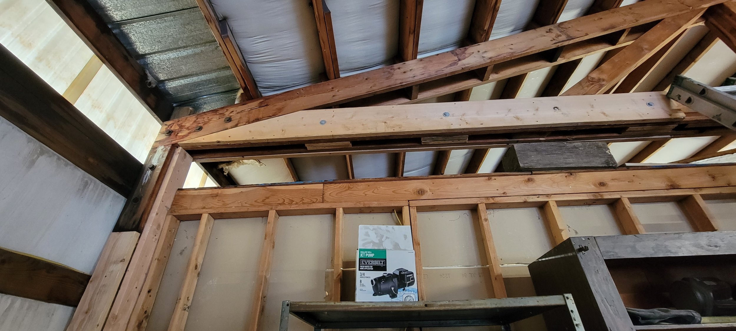

Actually I do have a photo of what I was describing from the first visit.
You can see the 2x6 I mentioned below the chord. It has split where it was nailed to the wall post (old nails in the two blue circles) allowing the chord to shift down.
I said above we would be replacing it with a 6x6 but that does not actually seem possible without removing the wall. I suspect once we get into it we will need to slide a 2x8 into that slot that runs from the base of the chord to the floor.
How was the chord originally attached in with the rest of the truss? was it sandwiched at the bolt to its left (unsurprisingly in line with the break/crack) or is there another (single?) bolt hiding behind the insulation that it was attached to? I think I see the main vertical 6x6 or 8x8 post extending past where I expected to see the horizontal chord going out to.
Are the new 2x10 chord pieces going to attach to the columns, or where are you planning to put them?

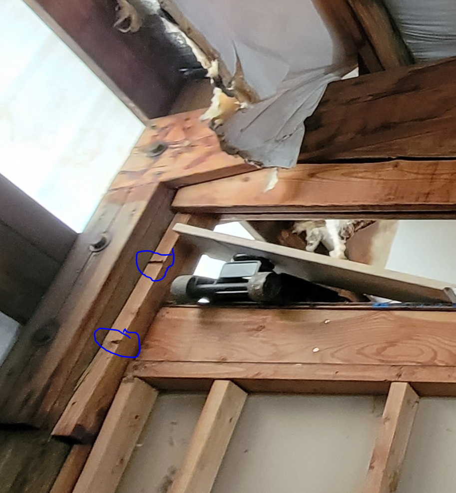

/ Roof Beam replacement. #46
The board on the side of that 6x6 is also split where the bolts go through it. I can't tell if you have access to both sides of the both of the bolts, but that would be a board to replace too. You can extend those support boards quite a bit longer, even all the way to the ground.
I had wondered why that board in your post #42 seemed narrow, now I see the split, and how the cord rafter has dropped by a few inches compared to the other end.
I always like to stagger bolts, nails, screws, etc, just a little bit, so they're not following the same grain.
If you do decide to marry a second cord 2x8 or 2x10, or even 2x12 to the outside of the broken one, I'd get some very strong wood glue (epoxy?), and try to repair the broken one the best you can before you attach the second 2x10 to it. Even glue them both together. And make sure it is all well supported. It will probably be cut into a wedge shape below the rafter.

I would like more pictures of the truss to post connection.
From your pictures the split 2x6 on the column looks like a temporary piece used during construction. Did lower chord break through support bolts. By design the lower chord should not have bending stress to break the way it failed

OK - we did the repair and lived to tell the tale.
  • First we jacked up the broken end of the chord so we could removed the split support on the wall post with a new 2x6 that ran from the chord to the floor. In hindsight we should have used a 2x8 so it would have also supported the two sister's we added - this can easily be done later though.
  • Next we compressed the split cord with liquid nails in the cracks to seal all that up. we held it in place with some clamps
  • Then we cut a sister chord and screwed it in with treated decking screws the the compromised chord.
  • We then repeated this for the split chord on the opposite side - it was in far worse shape than the visible one in the photo. It had been fully compromised and was providing little value to the strength of the truss.
  • After that we ran three bolts clear thru the 10 foot set of sisters and trusses - filling the gap between the original chords with some 2x10 spacers.
  • The final step in the repair was to add one more 2x6 to the wall post to support an existing rafter support on the truss - also running that to the ground.
  • This completed the truss repair. We were able to remove all clamps and jacks and it all held quite well.
The final step was to remove the "tree" that was near the center of the truss and replace it with a 6x6 treated post - the tree was showing significant cracking as well. Unfortunately putting it dead center in the truss would not be possible without re-doing an existing wall under the truss. We settled for offsetting it and putting a block between the center of the truss and the existing wall.
The long term plan is to replace the metal (probably next summer) to fix some leaks and at that time add some engineered trusses to beef up the roof. This was built in the 80's so it is pretty old and could stand a new roof.
Thanks to all for the advice. The plan we put in action was largely based on the feedback here as well as from a buddy of mine. I learned a lot with this project!
