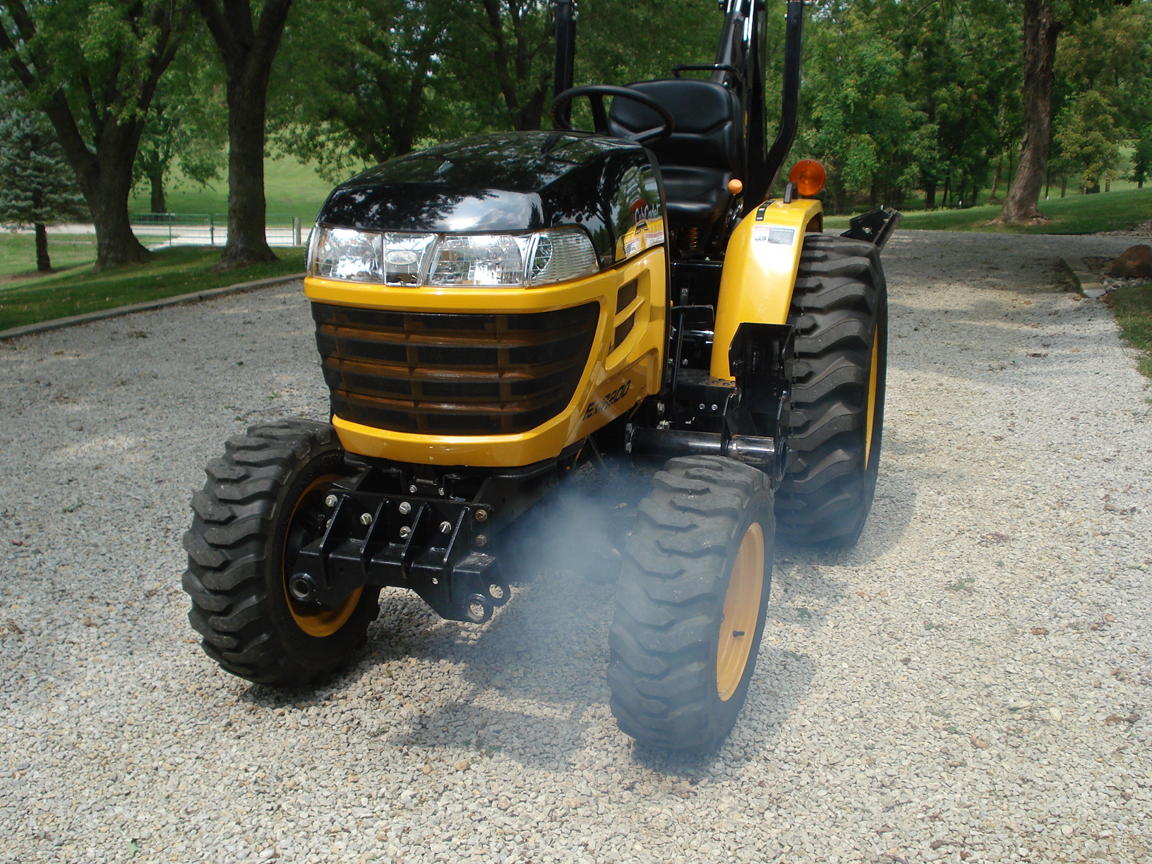

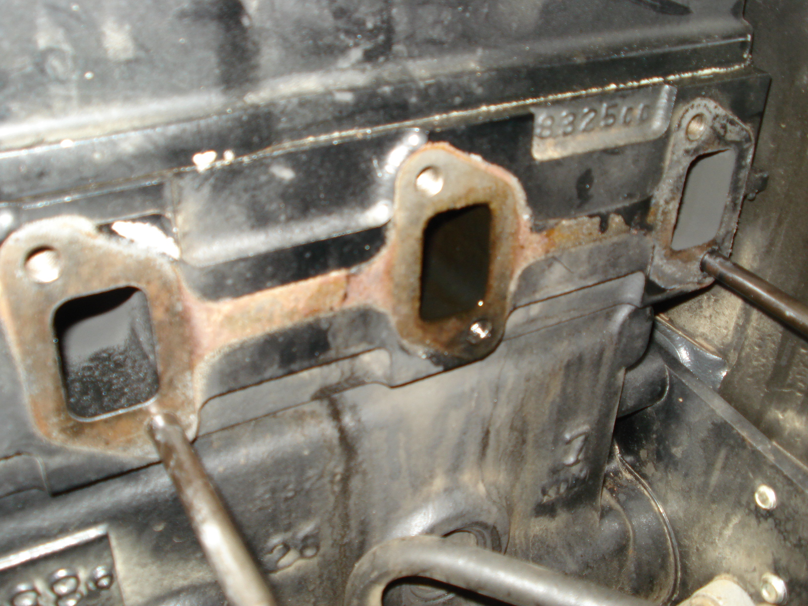

Hello all. Car Doc made a good call to confirm the crank condition while everything was accessible. I rotated the engine by hand several times with a dial indicator on the harmonic balance and another on the flywheel hub. Expected to see several "bumps" due to normal inconsistancy of paint and metal. However, I was very happy to see that the front only varied ".002" and the rear .0015". The cranks spins very freely with very little pressure required to start the spin and no areas of resistance during a rotation. I was only able to put a tiny "wiggle" dial indicator on a small portion of the main crank journal and it showed less than ".0005" movement. I have also inspected the rod bearings from the removed piston and there is no visible wear. The cylinder wall is in excellent condition without any signs of piston skirt contact. I originally ran the motor for almost 3 hours after the rollover (having hoped early on that there was only oil in the exhaust) and never felt any change in the clutch pedal.
Tonight I will pick up the new parts and begin reassembly. I will let all know the end result. Thanks again for everyones help!

Hi all. A quick update on the EX3200. Installed the new connecting rod and reassembled the engine on Friday night. Saturday morning I was SAFELY moving dirt again. Here are 3 pictures to show the smoking tractor, the #2 exhaust port and the bent connecting rod. Thanks to all for your help!
