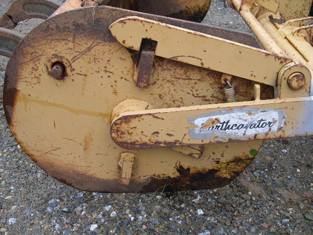

This is the side of the scraper. To the top you can see the partially engaged latch. In the middle, behind what is left of the "Earthcavator" sticker, is the actual pivot point(same on other side of too)

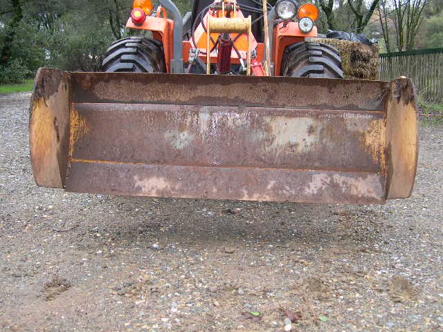

This pictures is from the back, showing the scraper portion ready to scrape in reverse, or "doze". It works soo much better for this purpose than a regular scraper box.

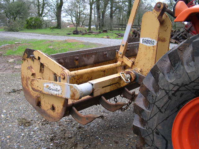

This is looking from the back tire of the tractor. It is hard to see the cutting edge. The TnT has the unit rolled as far back as possible. By dragging forward, it does a wonderful job for finish smoothing. Note the rippers still face forward, up out of the way, and the scraper itself faces rearward.
Also note, the rippers can only be used when they are in position on, for ripping. Even with TnT, I cannot roll the unit enough to engage the rippers if the setup is in the forward or backward scraping position.
