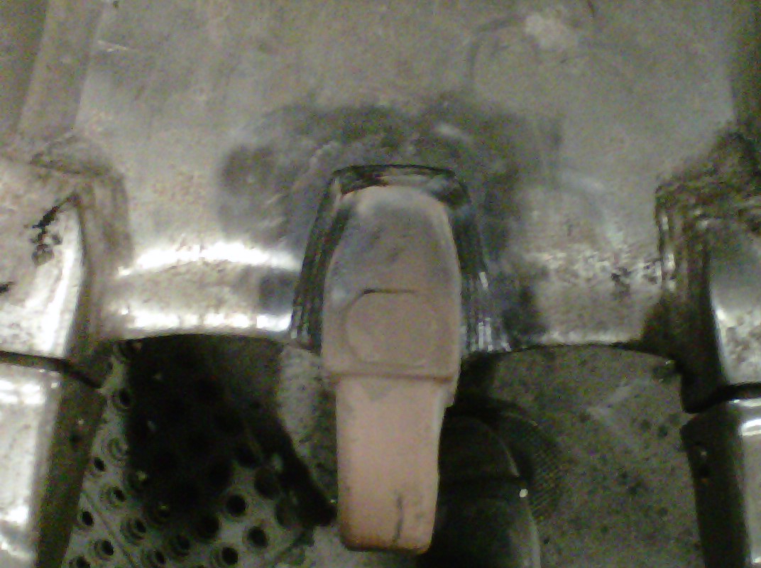

I broke the cutting edge of my bucket 2 yrs ago pushing down a 18" tree. It broke at a point where a tooth bar had left a dimple in the edge and a very short crack had developed there that I didnt see. I fixed this 1/2 X 6" edge using 6011, 7018, and 11018. I started out using just the 11018 but found I was getting voids in the root pass. I went to 5/32 6011 for the root pass and then to the 7018 and then to the extreme strength 11018. It has been durable. You need about 50 more amps to burn the high strength rods and I couldnt help gouging the root when I used them.
larry
