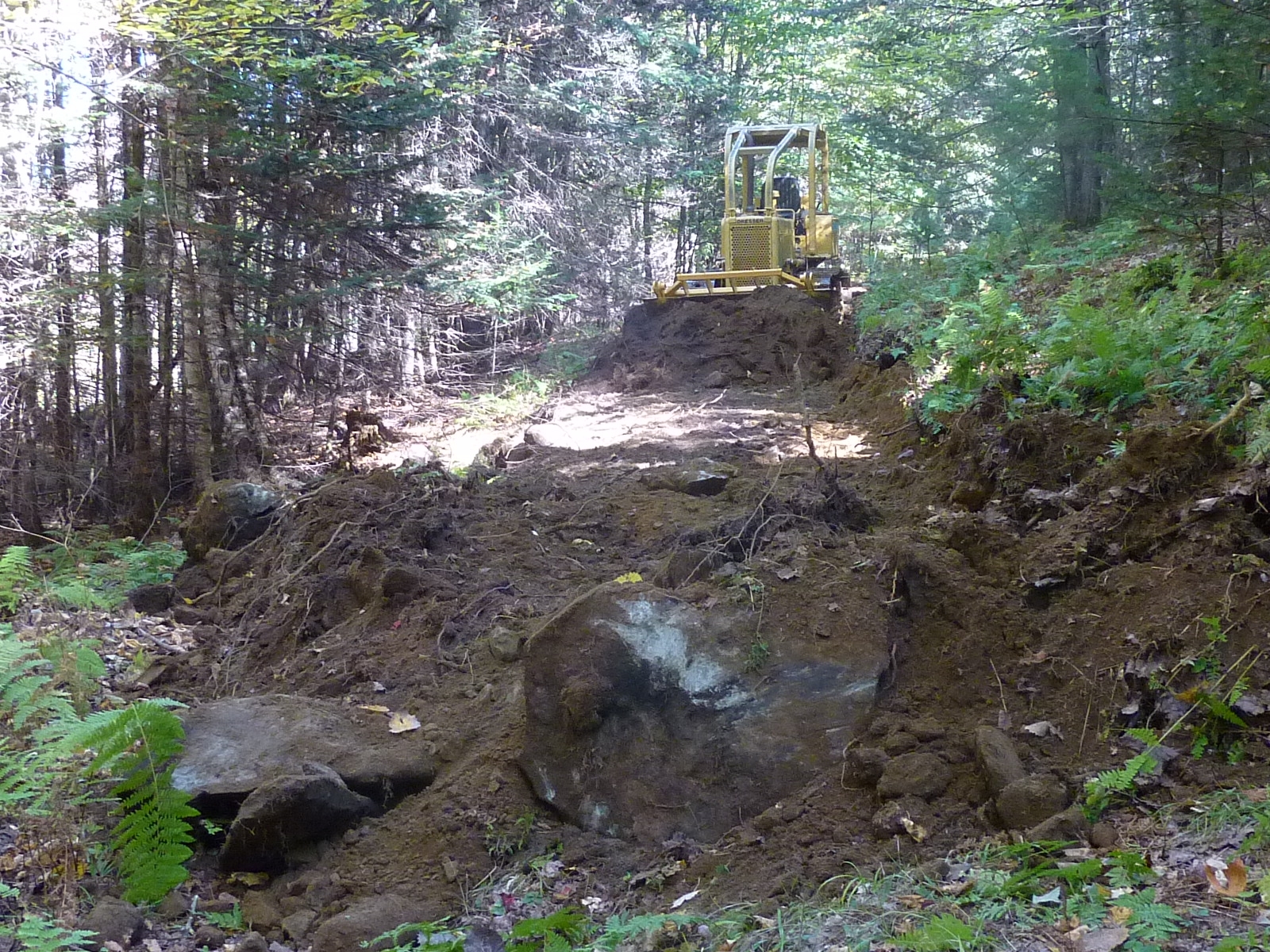

Sounds like a great reason to get a dozer and tune those trails up ! Just tell the Mrs we told you to so you didn't have a choice !

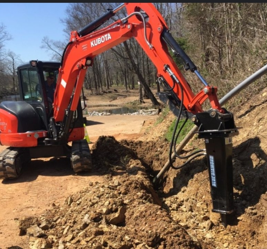

No doubt. I think my next purchase will be a mini-x to better move rocks, dig ditches and build trails.

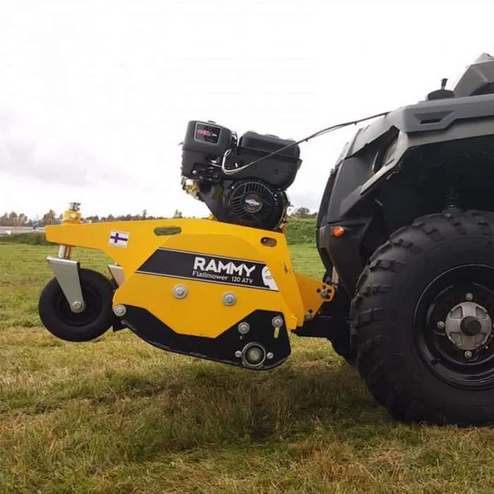

This is outta control at $4k, but the best atv solution I've seen.

I think scootr has the best idea - if you don't want to remove the rocks and clean up the trails. HD chains on the ends of bush whacker blades.
Otherwise a dozer to permanently fix the trails and the rocks.

That's not what's needed. More like this.
You're dealing with trails, roots, stumps and large rock. It's all 6"+. Nothing is getting buried by any machine.
When they did the logging, they moved some granite blocks that were the size of a VW bug.
Maybe I should turn it into a quarry instead of a wildlife refuge. Lol

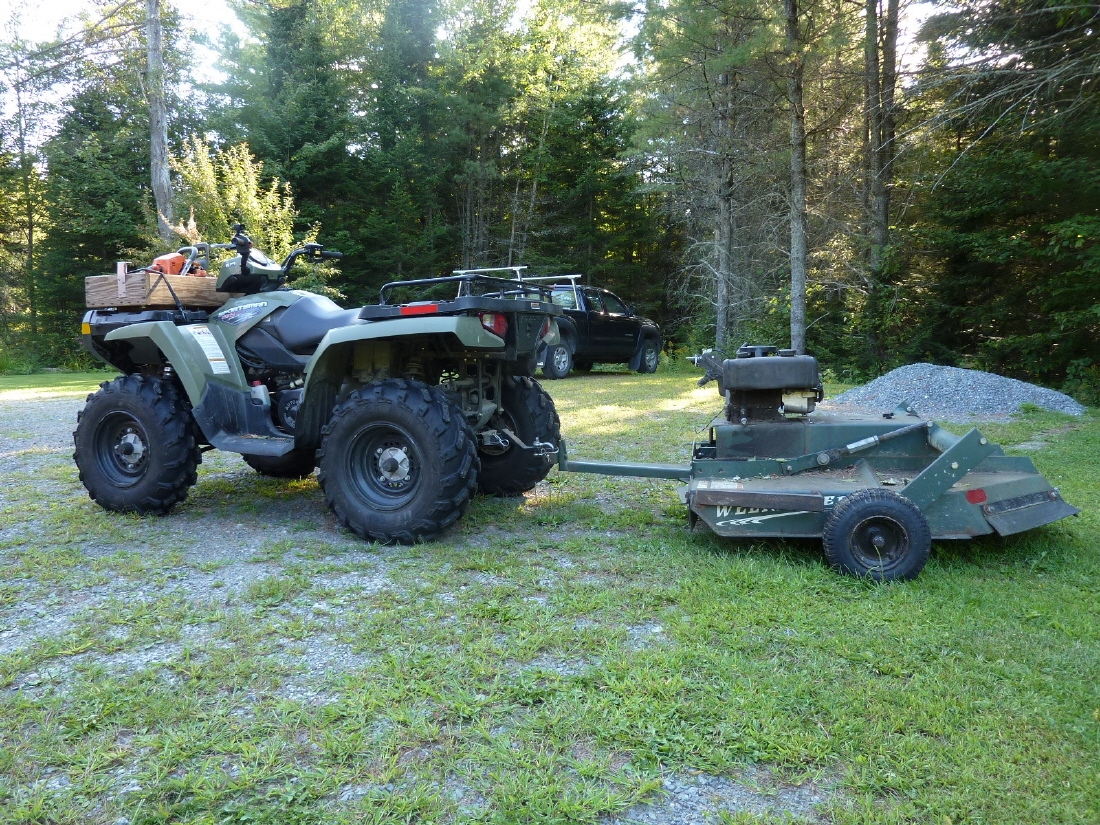

I have a similar situation - a large piece of rough, rocky, and hilly property with miles of old skid trails on it. At first none of the trails could be used by an atv, mostly because of thick raspberries, downed logs, and tons of slash. A tractor was out of the question because of stumps, rocks, logs and side hill terrain. I started building usable atv trails using my 4 wheeler and chain saw, moving stuff by hand. Of course berries, weeds, and ferns grow back. I bought a self powered heavy duty Fuerst (no longer in business) bush hog and pulled it with the wheeler. I ran the blade about 7" off the ground to keep it mowed. Any trail I wanted to turn into a tractor road I used my dozer, But like you said it is an excise in burying rocks. I cant just drop the blade and push out a level swarth. It is slow work but doable. I've been at it 25 years and there is plenty more to do.
