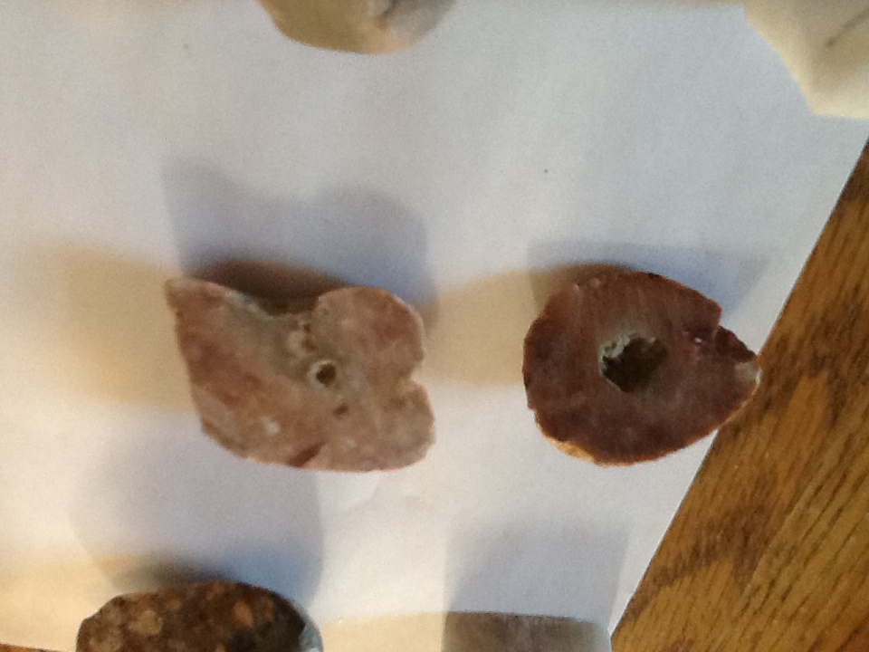

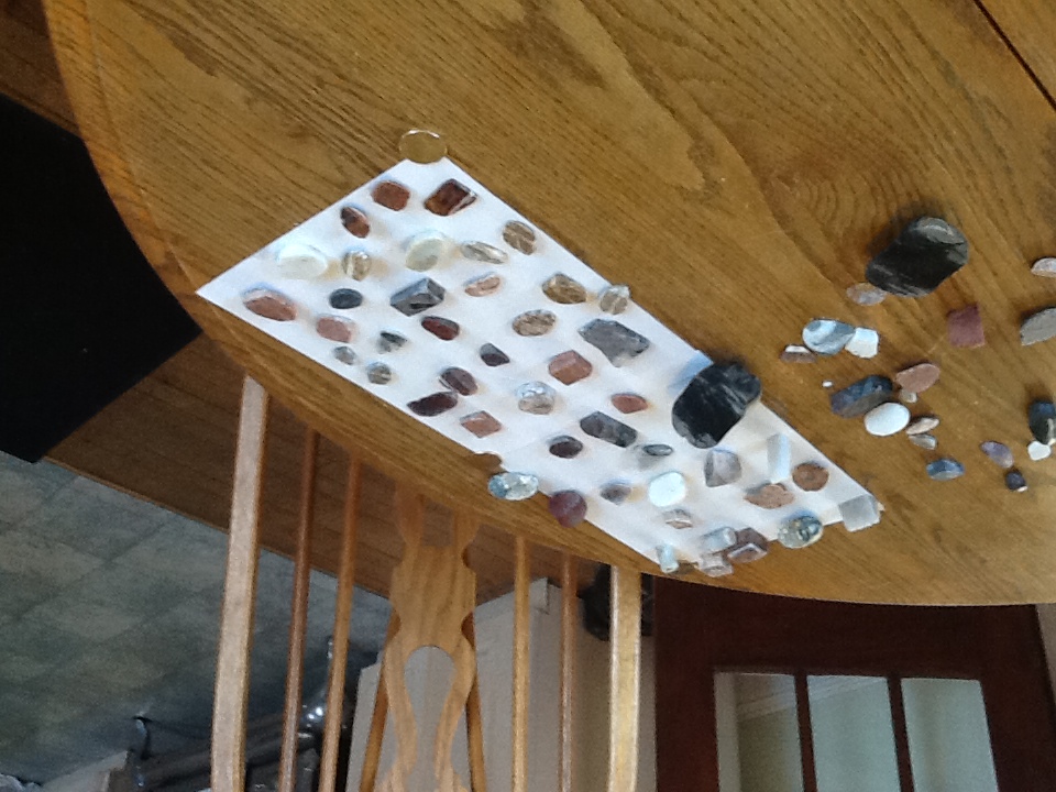

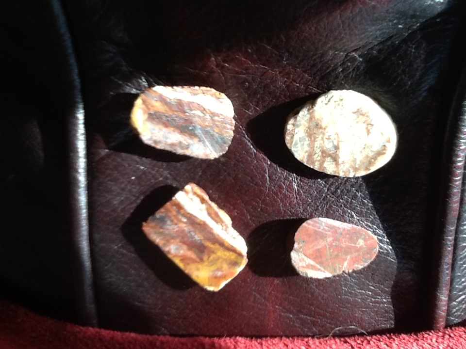

A few years back I made an attempt at cutting & polishing some interesting stones from a local beach. It was intrquing but I soon found the wet tile cutter I was using was not the best. I did have a child’s toy tumbler but it was frustrating to use. The conclusion that proper equipment would be required finally dawned on me. The experience was rather enjoyable but producing a quality product just wasn’t in my pay grade.
