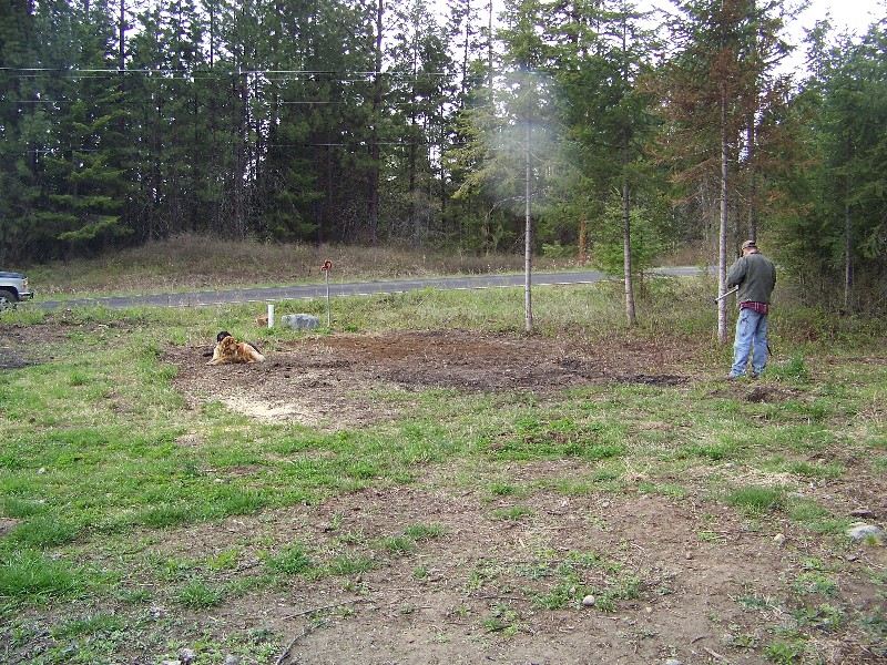

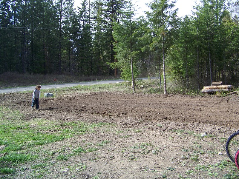

I have installed new gardens in rocky soil and after ripping the ground both directions, the rock bucket gets most of the big rocks, But can't gather the rocks under 3 inch. A rock screen might be a better way for total rock removal with a lot of FEL work. The last garden I put in, the gardeners didn't mind a few smaller rocks left after they saw all of the roots, sticks and the few stumps gathered by the bradco 66 inch rock bucket gone.
