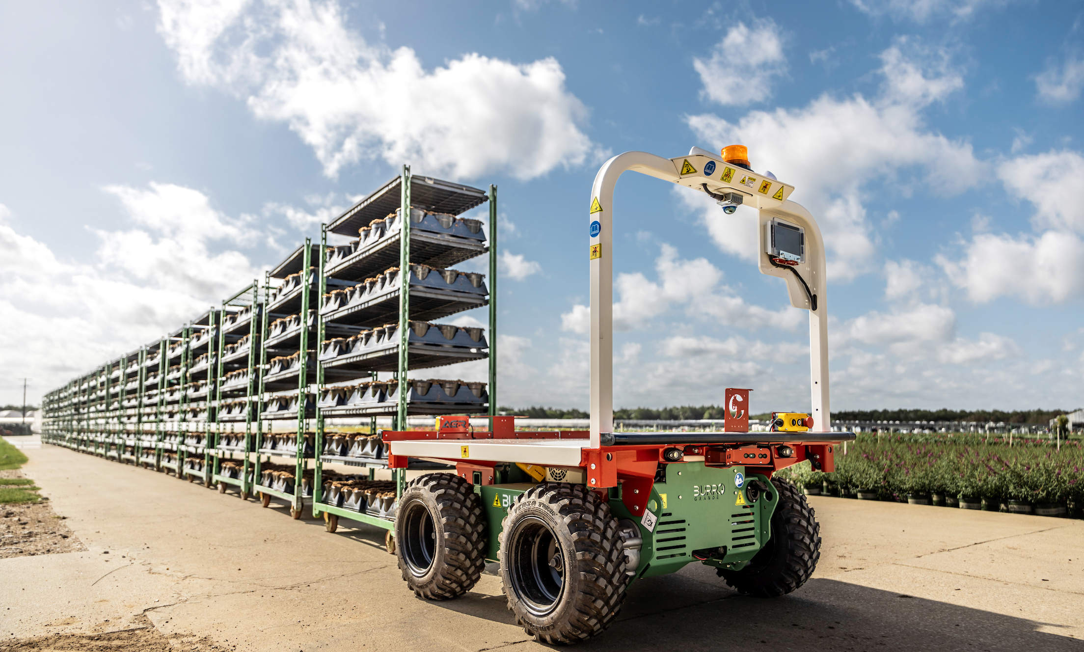

We are increasingly towing in nurseries. Below are two images - one shows our smaller Burro with a mower, the other shows our larger Burro Grande towing about 5000 lbs. Below, also, is a survey.
At the same time, we keep having customers put mowers behind these things, and are trying to figure out how to hit what people want (here's an example of a customer putting a mower behind a Burro
Should we build an autonomous mower for a system like this (Could dock to charge, and run 24/7, perpetually in rougher ag / area type areas)?
If yes, should it be smaller (i.e. something like 36 inches wide), and fit on a smaller Burro? Or larger, and only fit on a larger Burro Grande (i.e. something like 48 inches wide)?
Any / All feedback hugely appreciated!! Below is a survey link too. The nos and negatives are very helpful also!!
