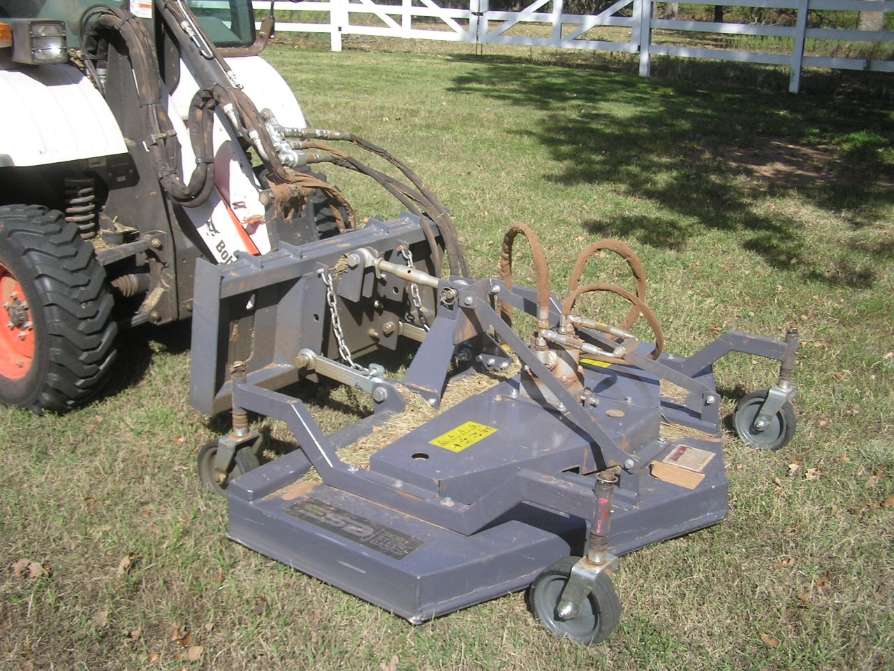

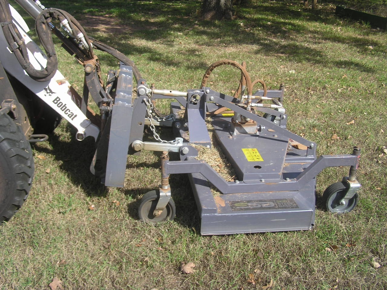

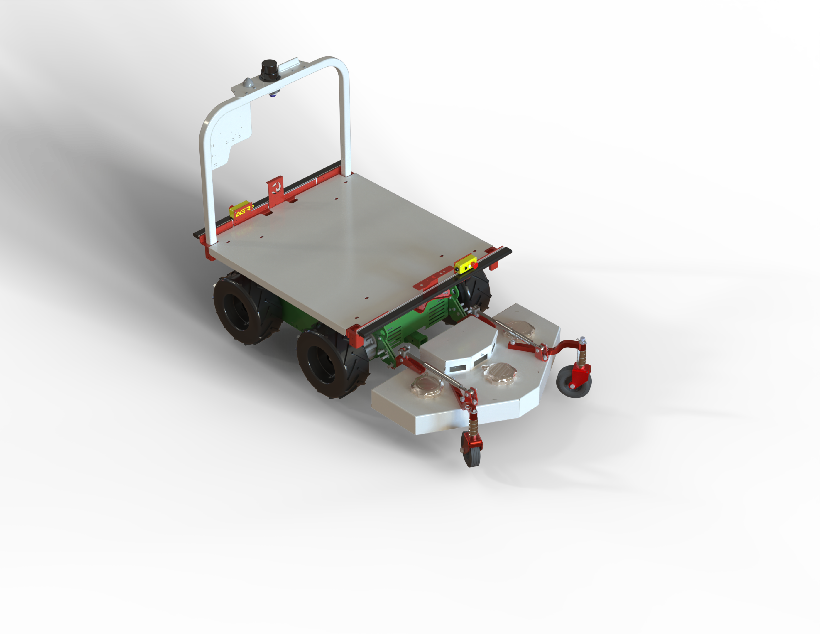

Deck setup (ballparkish)
Looks OK for level ground, but I like the deck out front and linked so it can mow uneven ground:

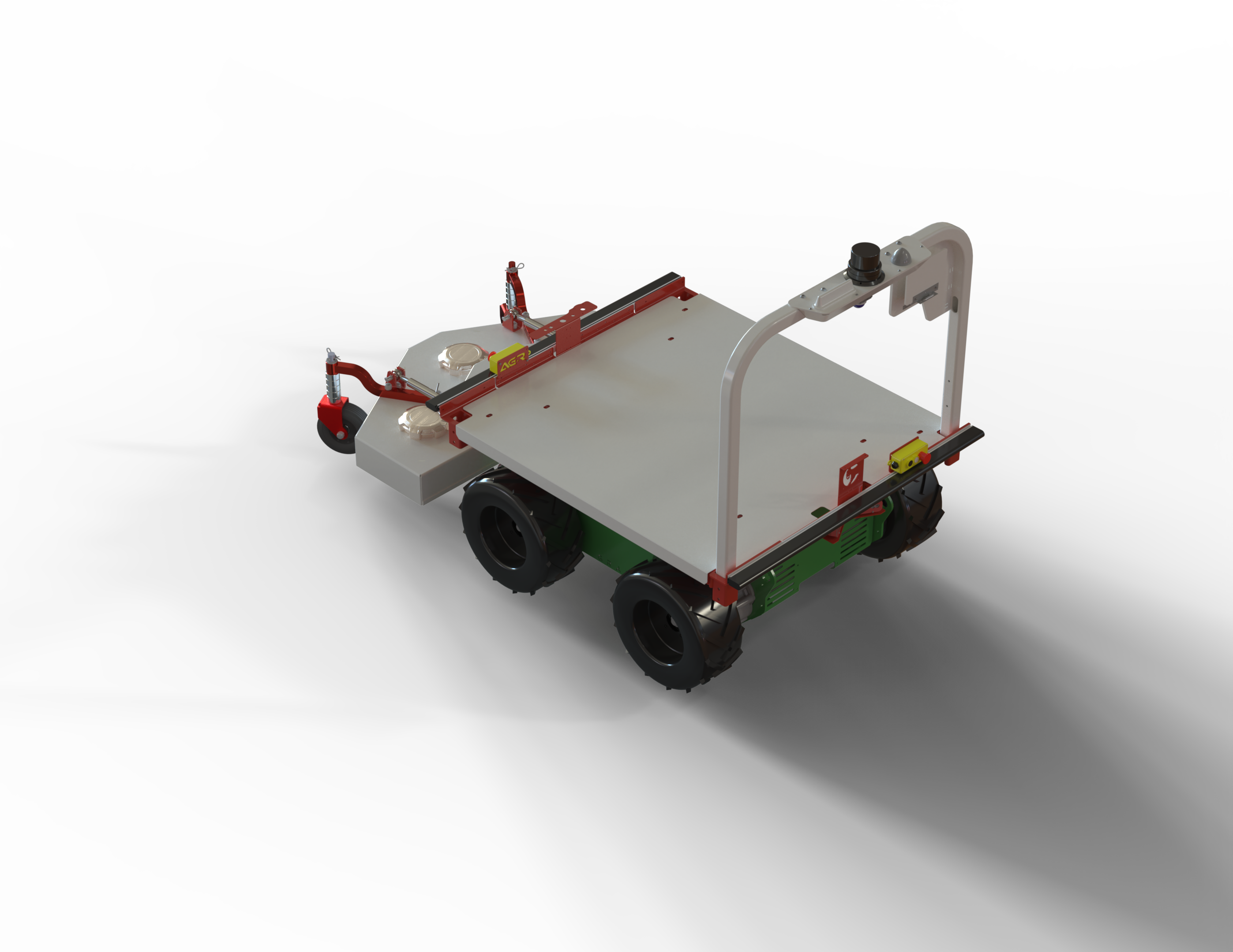

   / Robotic Following Cart to Replace Light Duty Tractor Tasks?
#333

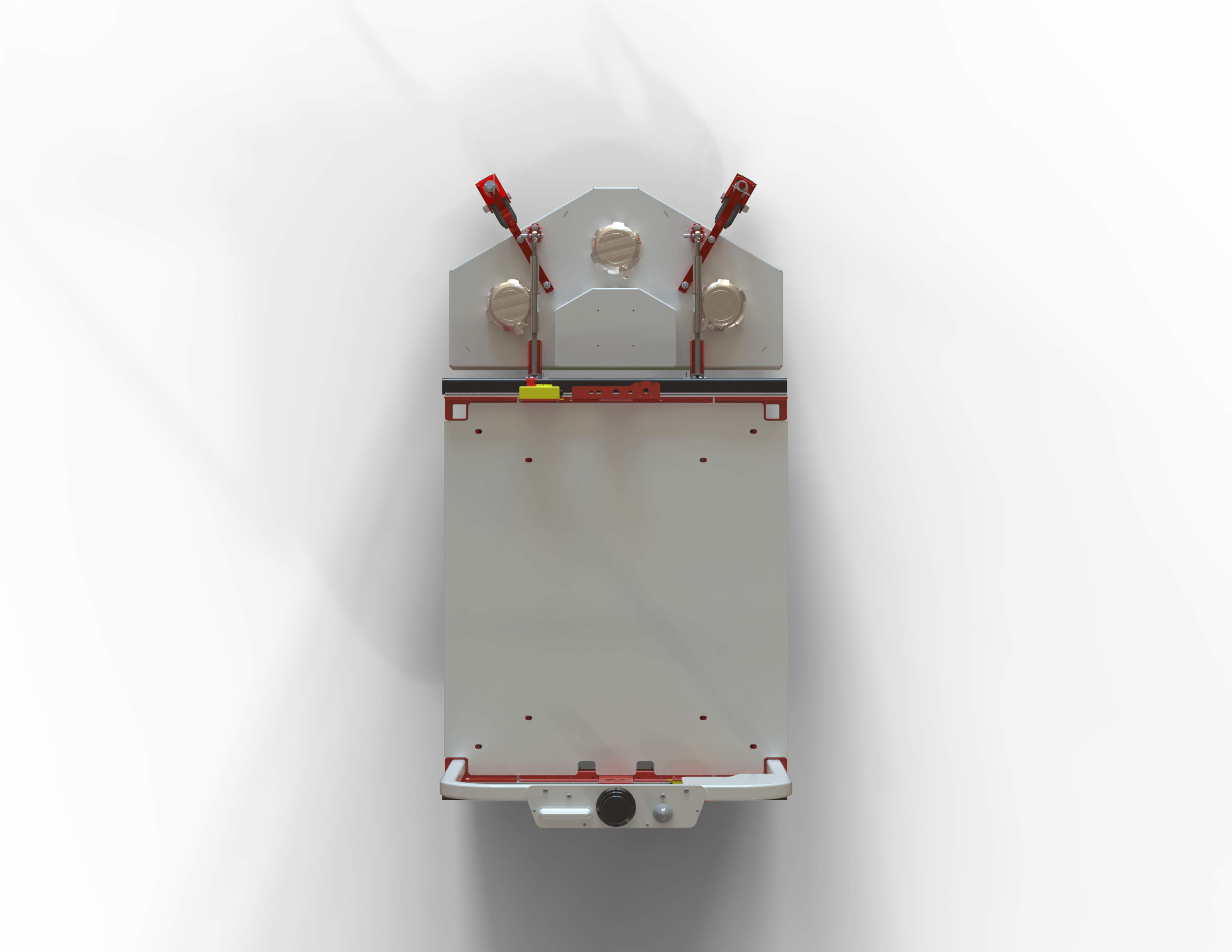

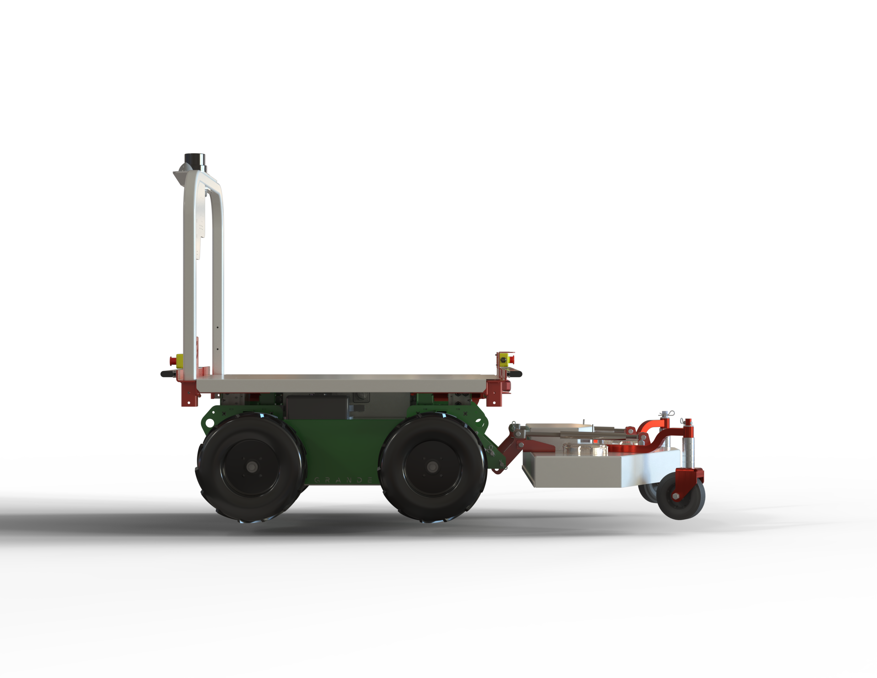

How steep are you doing? A lot of our testing has been on 25-30 degree slopes to make sure we can do rough stuff and areas

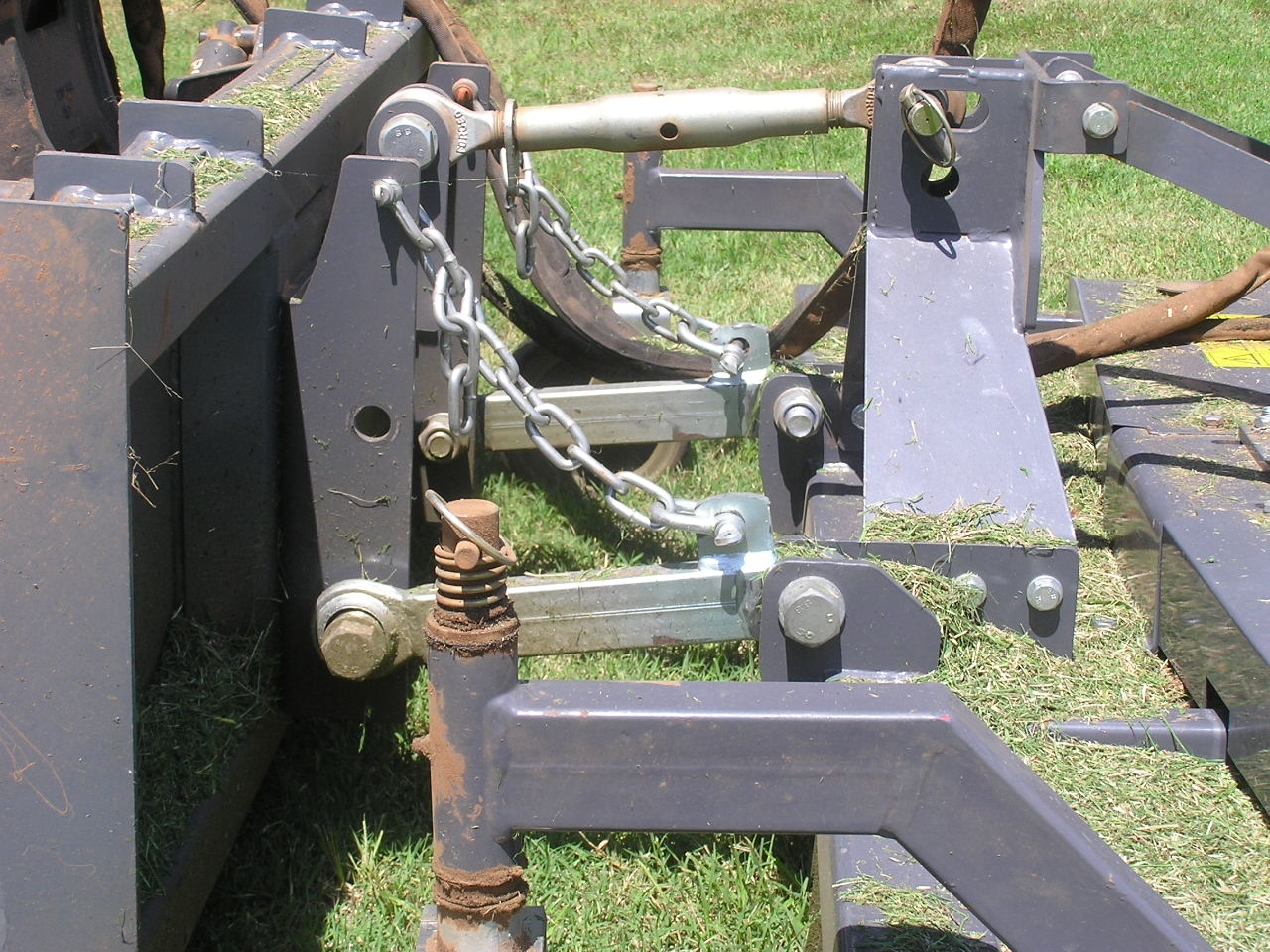

Steep is no problem. What I mow has uneven ground where the machine is still on the flat level, but one side of the mower deck is going up or down in the uneven area. It has to twist to keep the wheels on the ground.
The linkage on this deck lets that happen.
   / Robotic Following Cart to Replace Light Duty Tractor Tasks? #335
Likewise on our PowerTrac. The mower deck or brush cutter can do pitch and roll as well as up and down, all independent from the tractor that's pushing it while keeping 4 wheels on the ground.
#336
In our case, we are generally pulling not pushing (only pushing if you are using a remote control), so the design principle you guys are describing applies. Said another way, this is functionling like any bush-hog on a 3 point.
