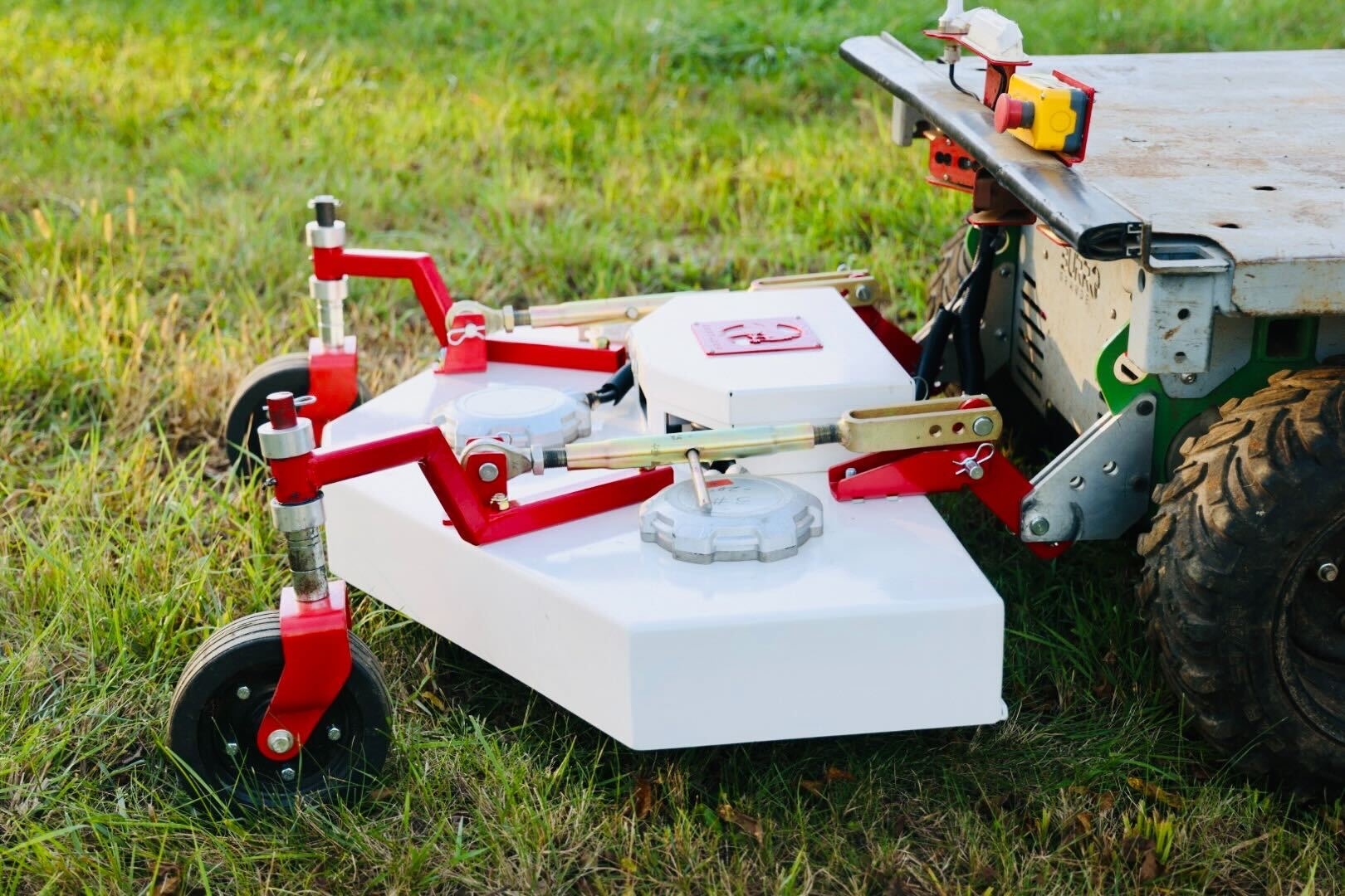

Prototype Cortador (Spanish for Cutter / Mower) system in more finalized form. 48 inch, swing blades, cuts like 1.5 inch stuff similar to a bush hog. Fully electric. 2 pins, 2 connections via our EPTO to connect to robot.
