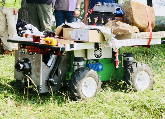

Early version of mowing raise/lower hitch prototype:
Ignore ductape and chewing gum nature. Will be refined shortly.
Can be paired with a docking station, so run/dock to charge/run
Compatible with all the BCS / Zanon / walk behind tractor attachments

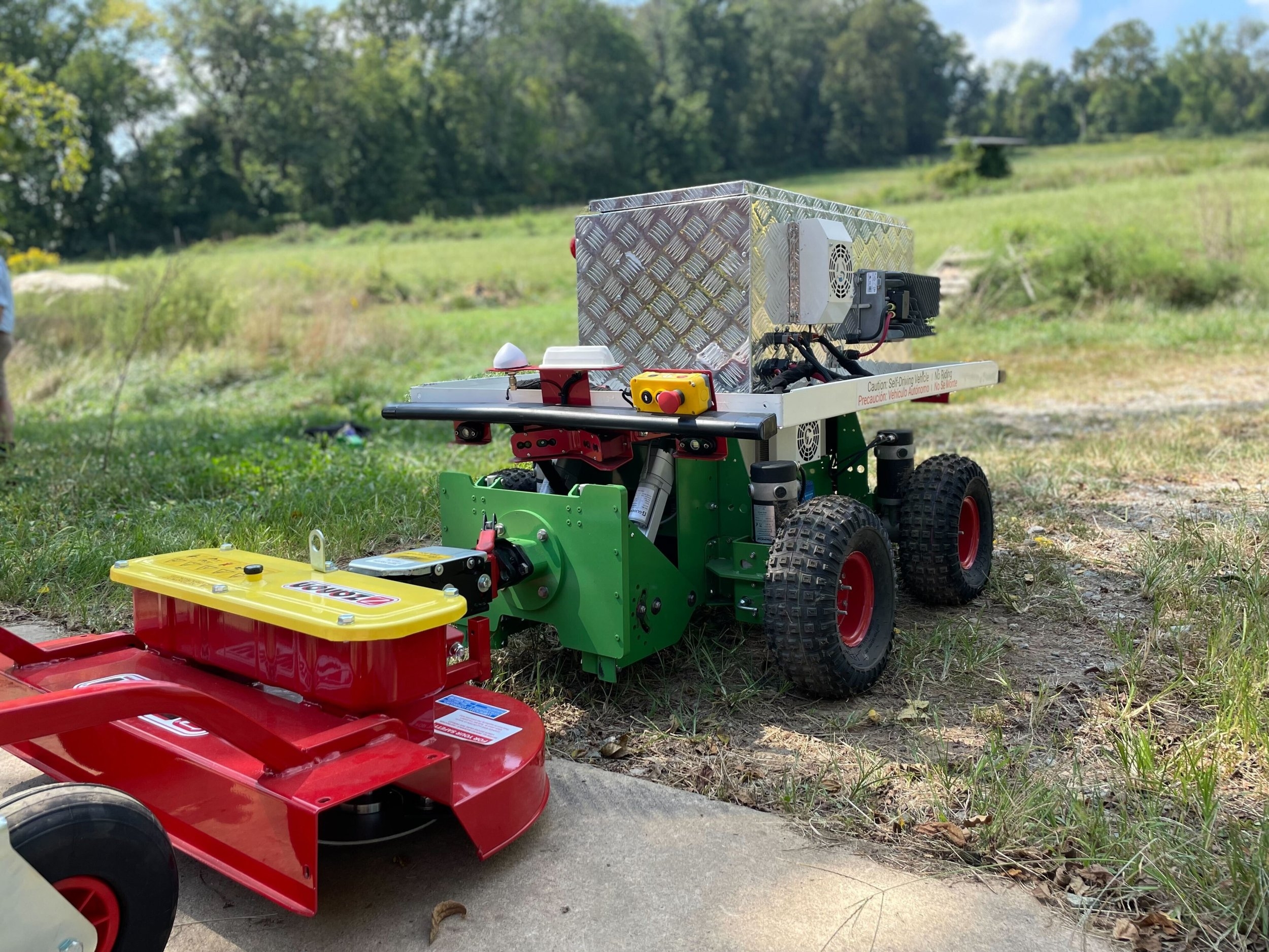

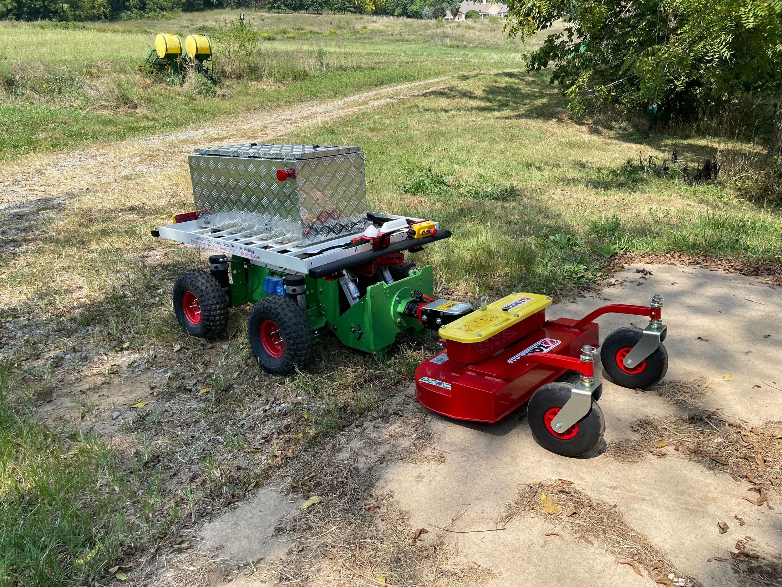

#303
Standardized mount with EPTO for any BCS/Zanon/Grillo style attachment
Mechanism can:
1. Raises/lowers
2. Can tilt
3. Can float, or can be set to rigid with some floating or rigid slots
Set up initially to mow, but could do other things in time
Will have better imagery in time also. Below kind of gives you an idea though (early prototype).
