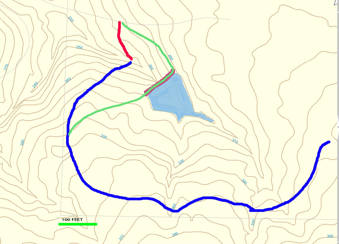

Just another thought. Peter pointed out that the first of your new road is steep. If you don't use the red part of the road and start over you can get a lot more gradual slope. Something like this.
DRL
   / Road Trail Building advice #13
It sure is fun coming up with ideas that use other peoples money.
How about a pond with the trail going across the dam?
DRL
#14
DRL
And then we can put in koi, a water fall, build some seats..... Glad you offered to come up and help out...
