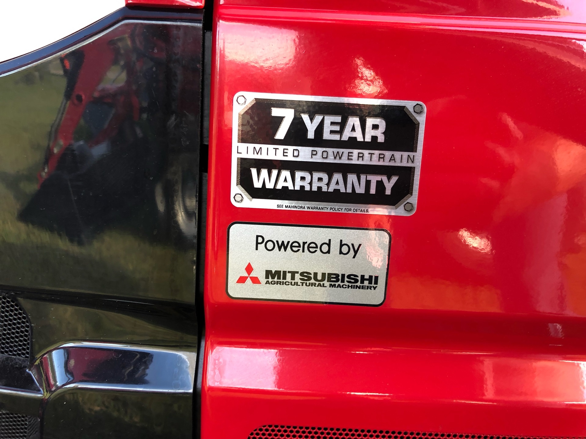

The Mahindra decals on the side of the cab.

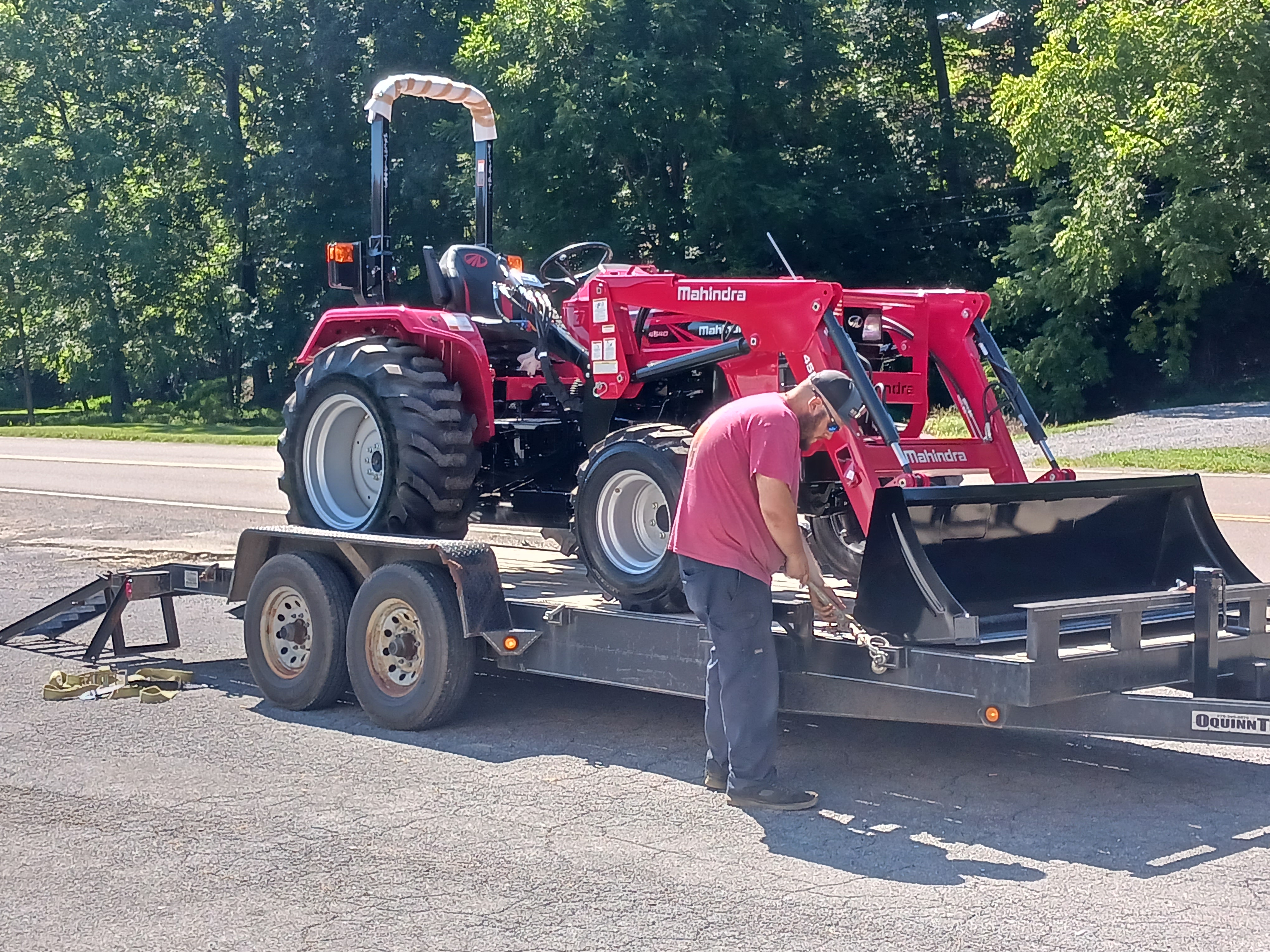

The first Mahindra 1640 I was thinking about was Mitsubishi with a Mahindra engine. I ended up going for the larger completely Mahindra built 4540 4WD which is more old school and time tested. They have built this model for years. More like the tractors I have used. fewer things to go wrong. Most of the newer features are only covered by the 2 year warranty. This tractor The majority of it is covered under the 7 Yr part of the warranty.
/ RK 37 with Yanmar Engine
#9
Is that one of the models that traces its history to the India-built IH's?
Yes heavy duty no fills just cast iron horse. Delivered today.
