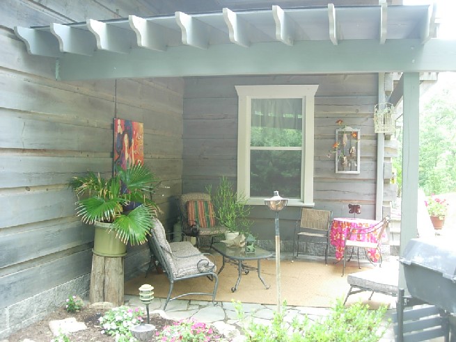

If you don’t mind I’ll toss in another idea on how to deal with this issue.
Remove the rafter that sits against the wall and cut back the sheeting to that second rafter and treat that edge the same as the opposite outside edge. That leaves a space of about a foot between that roof and the wall.
Easy to do, costs you nothing, can’t trap water so no possibility of dry rot, and I think it will look better than any of the other solutions.

Wow, that flashing job is...well...lets just say "not to code." Others have given you good advice on flashing but I think one thing was not mentioned and that is your gas line running up the wall and behind your flashing. That is going to be a problem area. In order to get a proper flashing job done that line will need to be relocated. There is no way that I can for-see to proberly flash that seam with the line as it presently sits. Also, if you decide to procede with the gas line as is, do not let aluminum flashing touch that copper gas line. You will end up with galvonic corrosion and possibly degrate the line. I agree that flashing is not needed here. Leaving the sheeting and joist back from the siding is a good option, don't trap water, you could even install drip edge to prevent water from getting to your sheeting. Unfortunitly you will probibly still need to flash the joint where your beam connects to the house.

Rich, For some strange reason your project has intreged me. Probibly because your so close to a real good job. You just need a few tweeks. I've got questions for you, what do you use this area for? Do you really sit out there in the rain?
My idea is to transform this area from a "covered porch" to a "pergola." I'd rip the sheeting off and install lattice-work. Then plant climbing plants, vines, hanging potted plants, etc. You'll end up with a nice shaded natural area and you won't have a care in the world about rain. I'd trim the vines back from the house yearly, but that's probibly optional. I'm not sure if you used PT lumber for your rafters, but the way the tails are exposed like that I'm hoping you did. If you didn't you've got another issue to deal with no matter what you choose to do. Good luck!

Boy, a number of comments while I was gone.
Fred, VERY interesting idea. I see the logic and will show the idea to the wife. It could fix a number of issues. (sigh) I just spoke to the wife on removing the first rafter and got the big thumbs down. Personally, I like the idea. I’m going to review it again with her later.
Woodlot.. I’m not sure if it’s obvious or not, but the flashing is just sitting there with a single nail tacked into it to keep it from blowing around. It’s not attached to the wall/roof in ANY way/shape/fashion other than a single nail to hold it. If you knew that and still maintain it’s not to code, I’d like to know/understand what I’m doing wrong with it.
As far as the gas line, you are the first one to notice that and that’s something I’d not thought of at all. It IS a gas line (propane) that goes up to the fireplace we have in the master bedroom.
Woodlot II: Do we sit out there in the rain: Answer is yes. The wife has actually taken the dogs out with her during a light rain and taken a nap while laying down on the chaise.
One reason I want it to be a solid roof is so I can get on top of it to keep my gutters clean. We use to have a retractable “sheet” we used. Kinda funny, she had a cotton tarp and had bright idea of painting UGL drylock on both sides of it to waterproof it. She also installed grommets so we (I) could hang it. During this mistake, I kept telling her “why are we putting all this work into this when you KNOW we’re just going to redo it and put a roof there”. She maintained “this might work, we have the materials, let’s give it a try”
Well, a year later, the cotton material was ripping, was rotting where it was holding some water and in general, was a BAD idea. She wanted me to keep the tarp “for future use just in case” (I tossed it into dumpster figuring I’ll react to “future use” when the time came)
Rafters are in fact PT lumber. Plywood is B/C exterior that is painted on the underside to match house.
I’ve attached sort of an after picture to give an idea of what’s going on under it today. We're going to end up with some lights under it and a fan.

Well, I thought I'd update what I've done and attach (what turned out to be very crappy) a picture.
I took the advice here & put it to the wife. At first I got a thumbs down on removing the first joist near left wall. We finally decided to move it inward about six inches inward and I then cut the plywood down that side to open it up agaisnt the wall.
What that did was allow for an open area all along that wall. I'll now not have any moisture being held issues. I won't have any issues with the copper pipe going up the wall to the fireplace.
We just had a pretty nasty storm and nary a drop showed its face on that side so it seems the four foot overhang really is my best initial defense.
Took it up to the top and put some copper flashing there. I originally had aluminum but she wanted it to look pretter if it was even remotely possible that anyone would see it.
Other than perhaps a dripcap (do I really need one?), I think I'm done with the roof (pending her inspection /forums/images/graemlins/crazy.gif)
After this is done, it's on to wiring some fans in there and also some lights.
