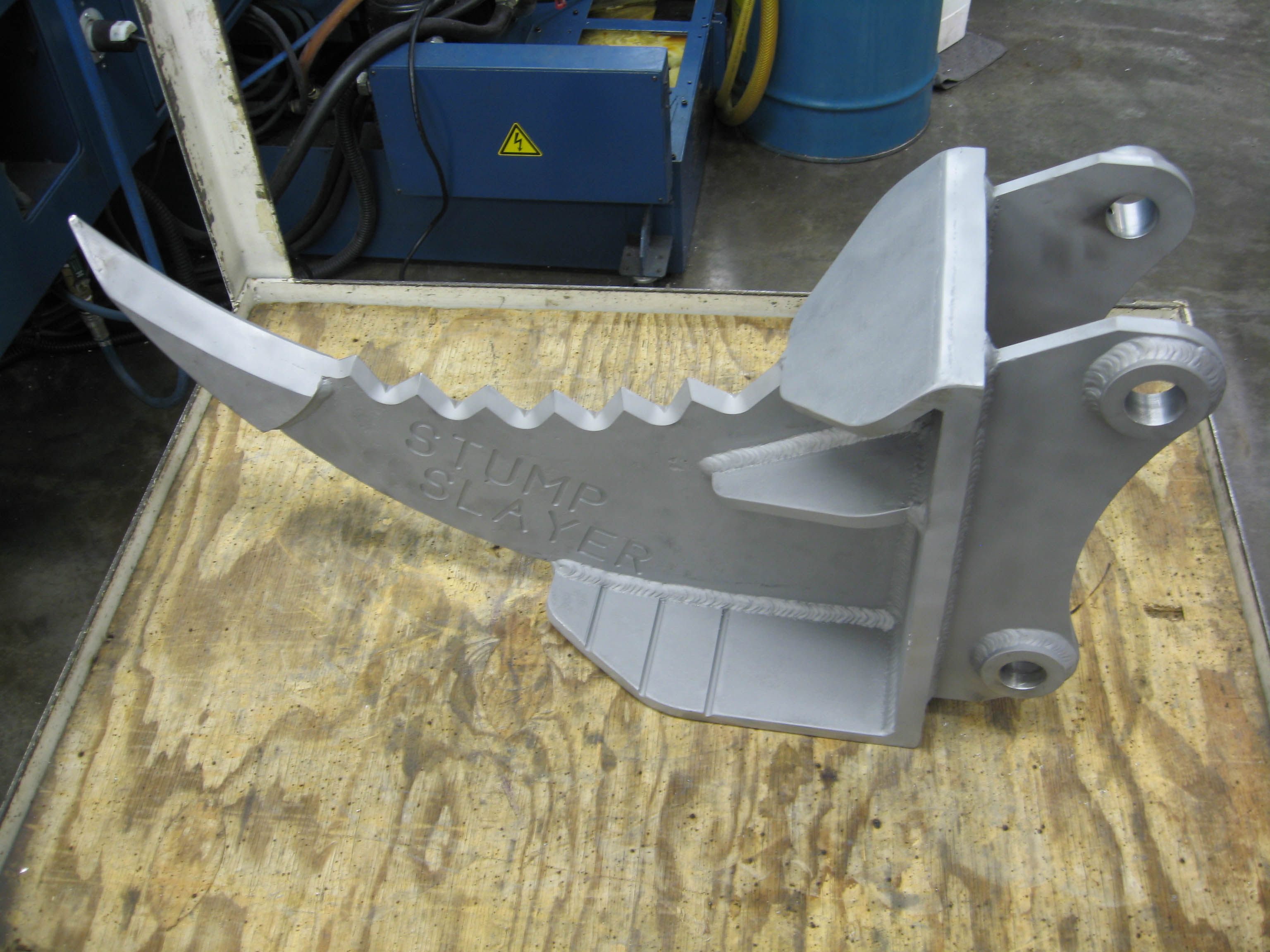

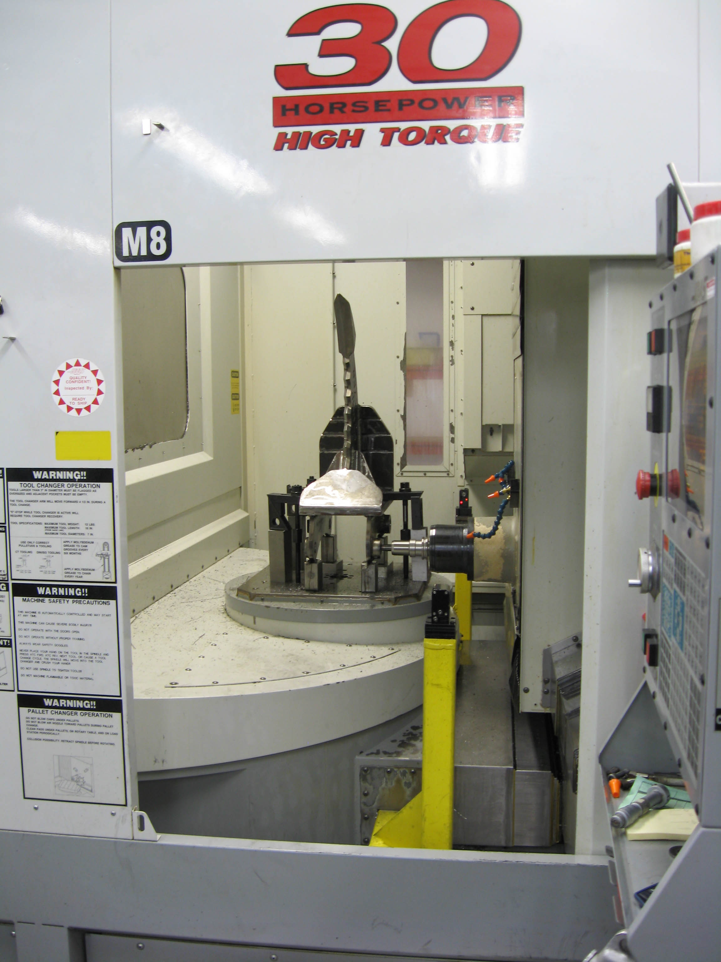

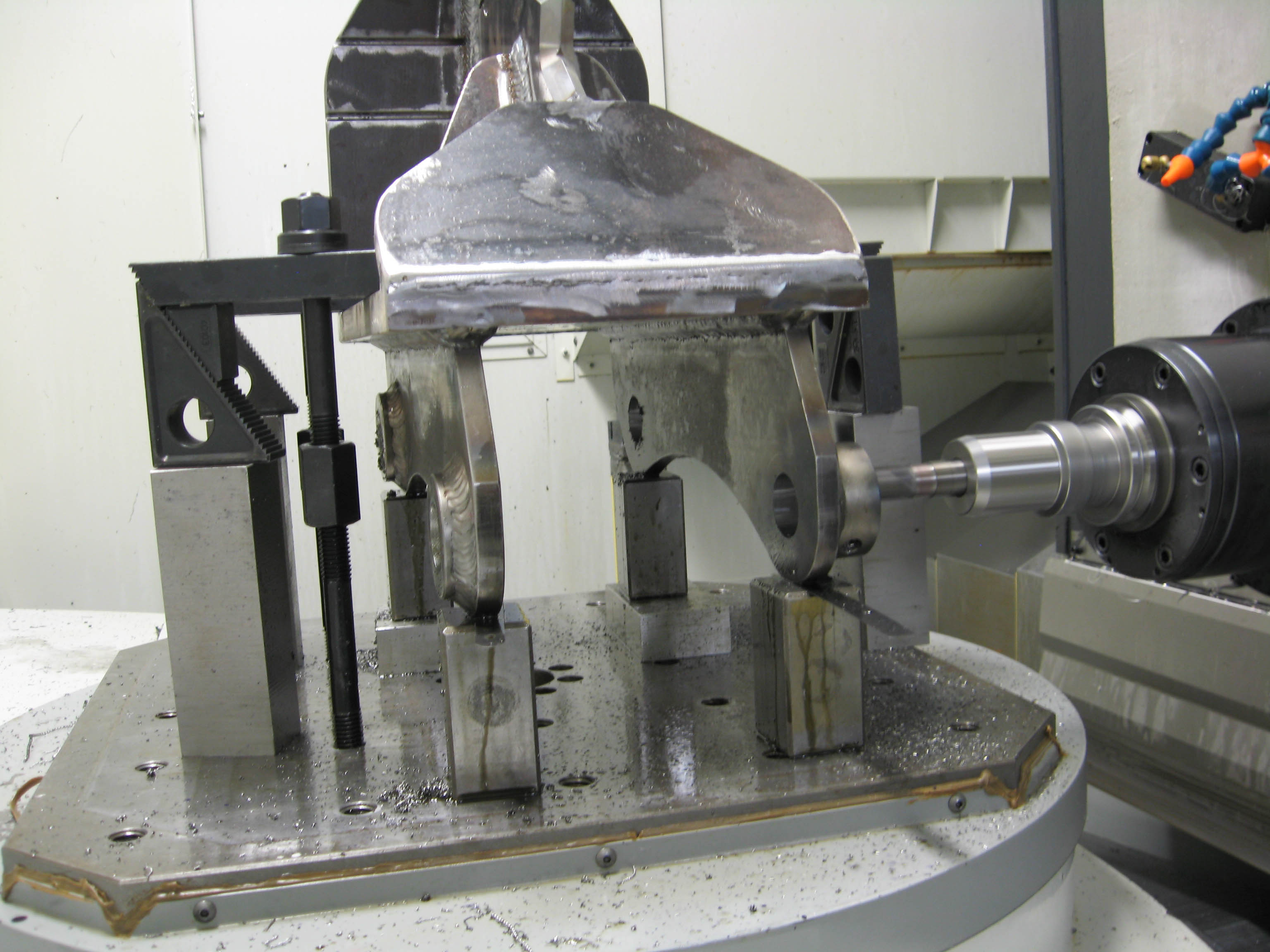

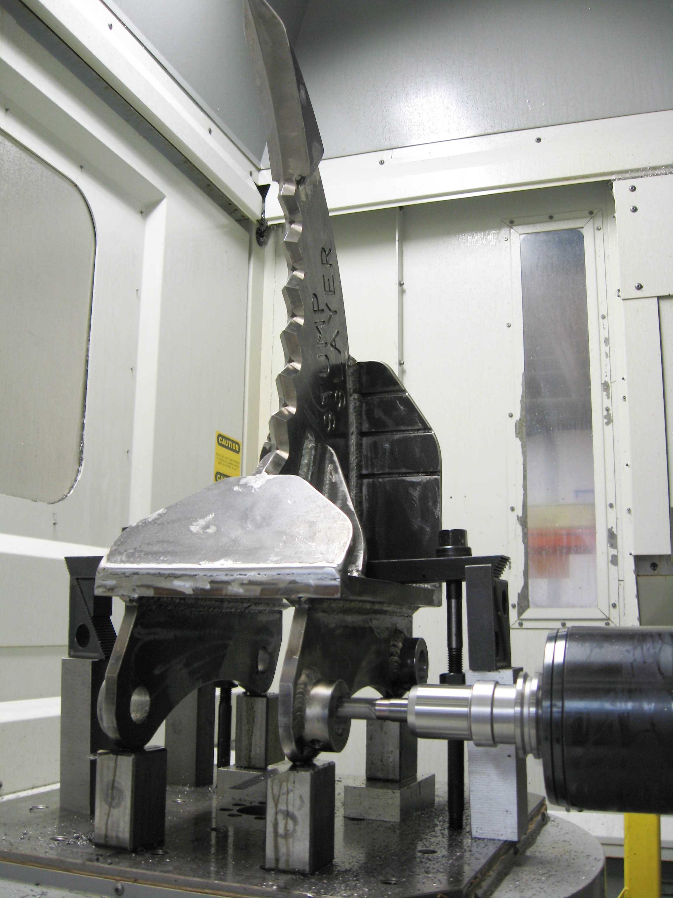

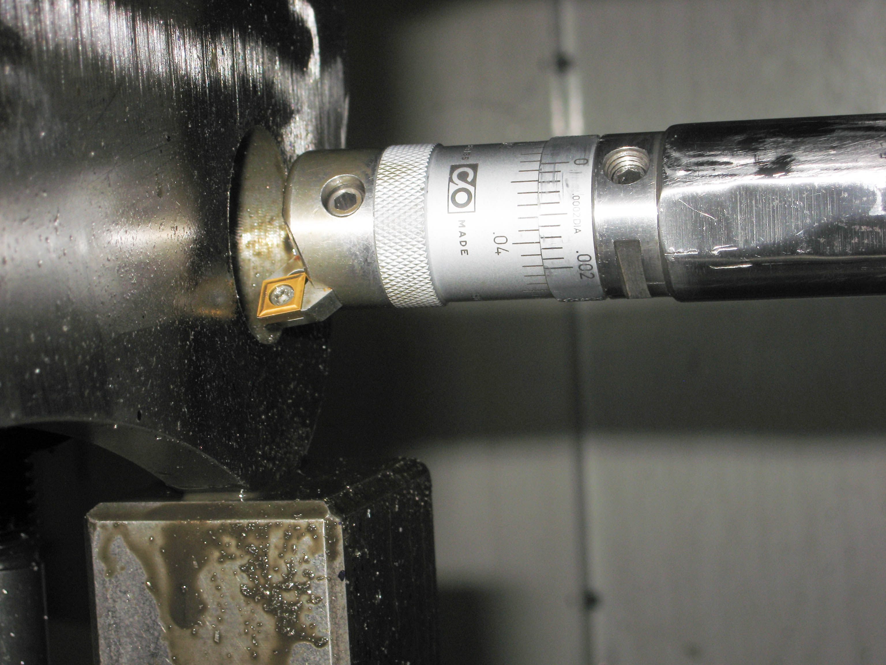

Well I completed the bore to size on the horizontal HAAS... made them the same as my bucket which is 1.260" (.010" pin diameter clearance). The closest bores to the spindle had the interrupted cut of the locking bolt clearance holes for the bucket pins. So I circular interpolated those with an endmill to size them. The further bores I completed with a boring head and although it took longer due to rigidity of the tool... got it done and to size. Hind site... should have left more stock in the bores before welding! Then I sand blasted it. Here are those pics.
Ripper_9D.jpg Ripper_9D-2.jpg Ripper_9D-3.jpg Ripper_9D-4.jpg Ripper_9D-6.jpg Ripper_9D-5.jpg Ripper_9D-7.jpg
   / Ripper tooth design - need your advice #85
Well I completed the bore to size on the horizontal HAAS... made them the same as my bucket which is 1.260" (.010" pin diameter clearance). The closest bores to the spindle had the interrupted cut of the locking bolt clearance holes for the bucket pins. So I circular interpolated those with an endmill to size them. The further bores I completed with a boring head and although it took longer due to rigidity of the tool... got it done and to size. Hind site... should have left more stock in the bores before welding! Then I sand blasted it. Here are those pics. <img src="http://www.tractorbynet.com/forums/attachment.php?attachmentid=340973"/> <img src="http://www.tractorbynet.com/forums/attachment.php?attachmentid=340971"/> <img src="http://www.tractorbynet.com/forums/attachment.php?attachmentid=340972"/> <img src="http://www.tractorbynet.com/forums/attachment.php?attachmentid=340967"/> <img src="http://www.tractorbynet.com/forums/attachment.php?attachmentid=340970"/> <img src="http://www.tractorbynet.com/forums/attachment.php?attachmentid=340968"/>
