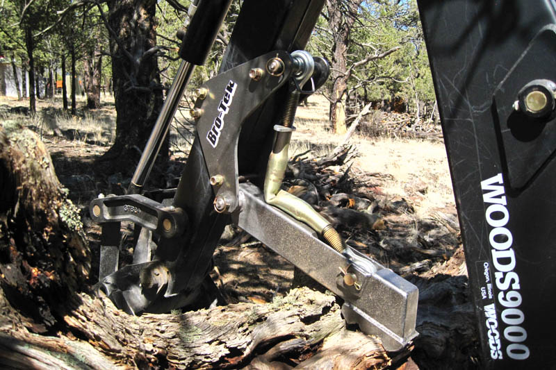

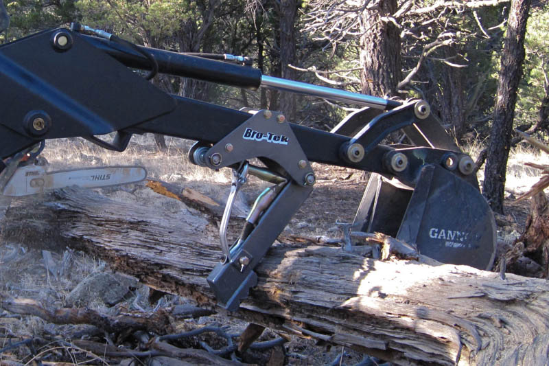

Who made the thumb thats on your backhoe ? and what did that cost ??
Coyote Machine is correct... it is/was a Bro-Tek. What I mean is I had to modify it... not so much the design but the hardware. The supplied support top-link was a thinwall design that collapsed on me when I put a little more bucket pressure on in that I probably should have. This caused much grief for me as I was 100 miles from a real hardware store and then they probably would not have had the parts I needed anyway. I had to make-shift a brace support with a large crescent wrench. I ordered from www.agrisupply.com the following which has held up great 11911 TOP LINK 15" LNG (381MM) H. DUTY CAT 2 = $25 got a spare as well.
Then a few trips later, one of the 4 bolts that hold the frame brackets to the dipper broke. Once again I was a long ways away from a hardware store so I used a long 3/8 socket extension to support the braces where the bolt broke. It of course bent as well but I was able to finish my trip without further time loss. The bolts provided were 1/2" grade 8 (quality stuff) but I choose to upgrade those to 5/8" size with a softer grade 5 bolt to flex a little if I got a little aggressive with it. The Bro-Tek design works well but you do have to remove the support top-link and a spacer when you want the thumb in the collapsed position. I just carry the removed parts behind my tractor seat... but it something that I wish could just be mounted somewhere on the thumb. I liked the narrow width of the thumb support with the "hardfacing" already applied rather than the wider styles that are more readily available online. It has worked very well for me since the upgrade to a heavy-duty top-link and the 5/8" bolts. Cost was a bit over $400 delivered from Canada a couple years ago. http://www.bro-tek.biz/

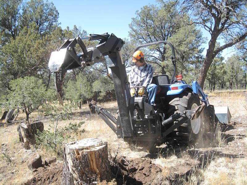

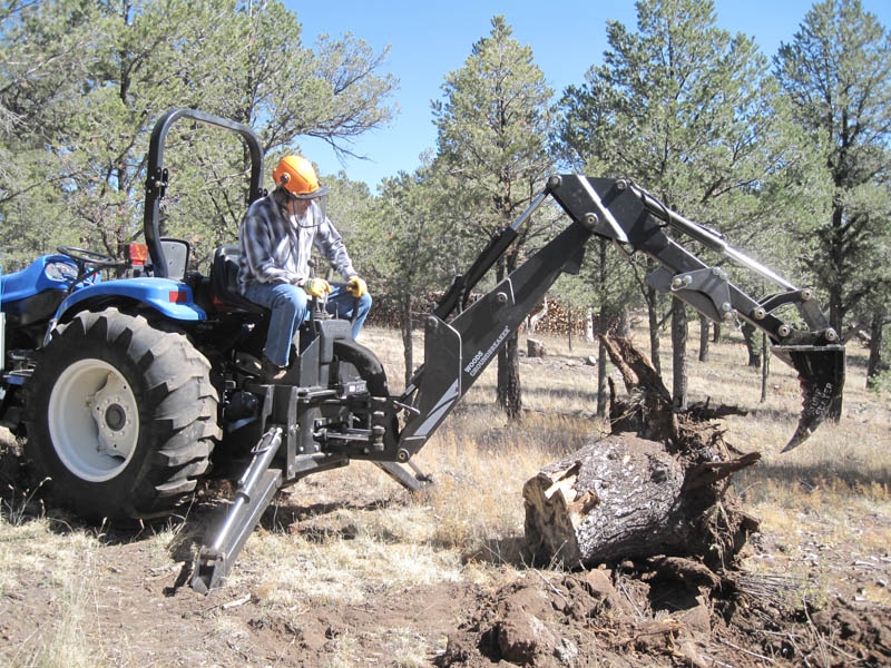

Just to let you all know I am back from my trial week with the "Stump Slayer"... all went well and accomplished my goals. :cool2: I will get some pics up in a couple days, I haven't even had time to look at them myself! Here are a few previews
