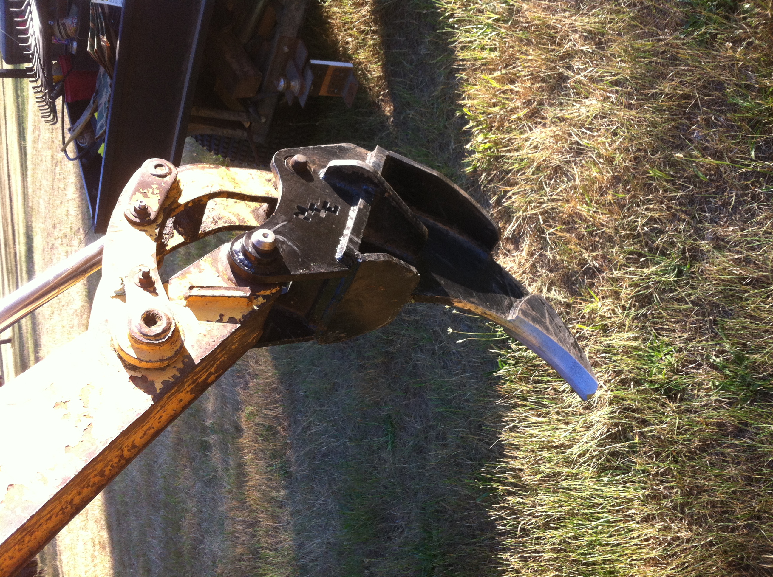

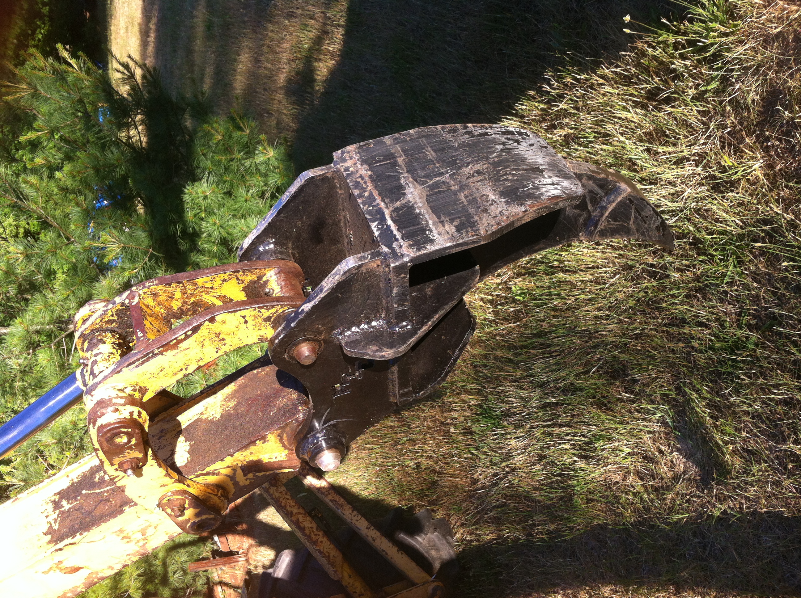

Here is the one I am working on for my KB2485. I have to fab up the mount when I get home again.

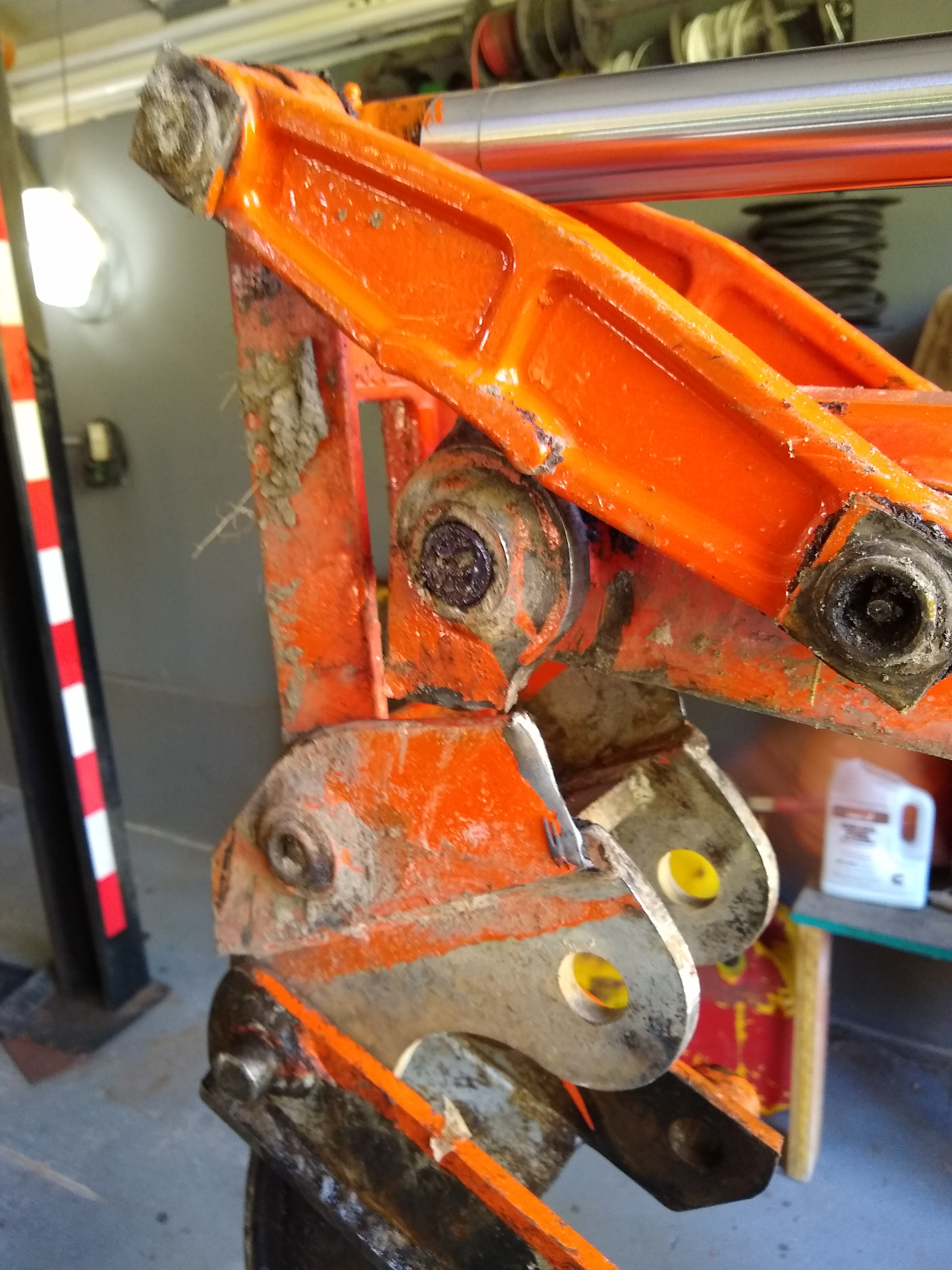

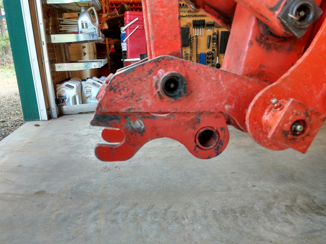

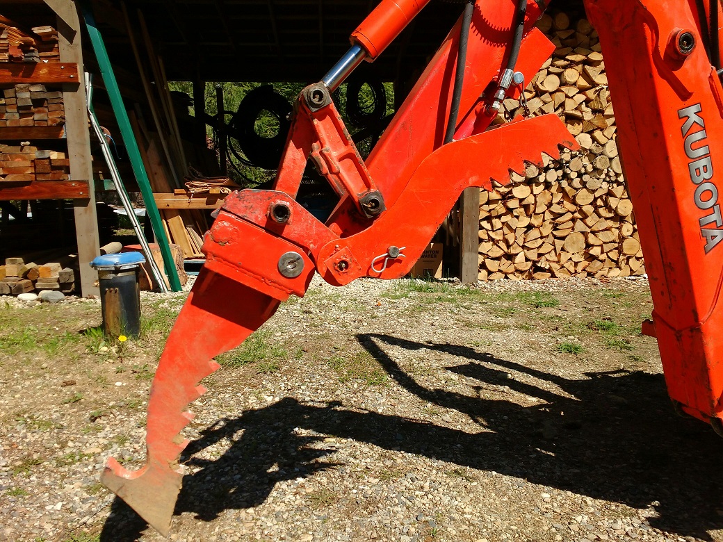

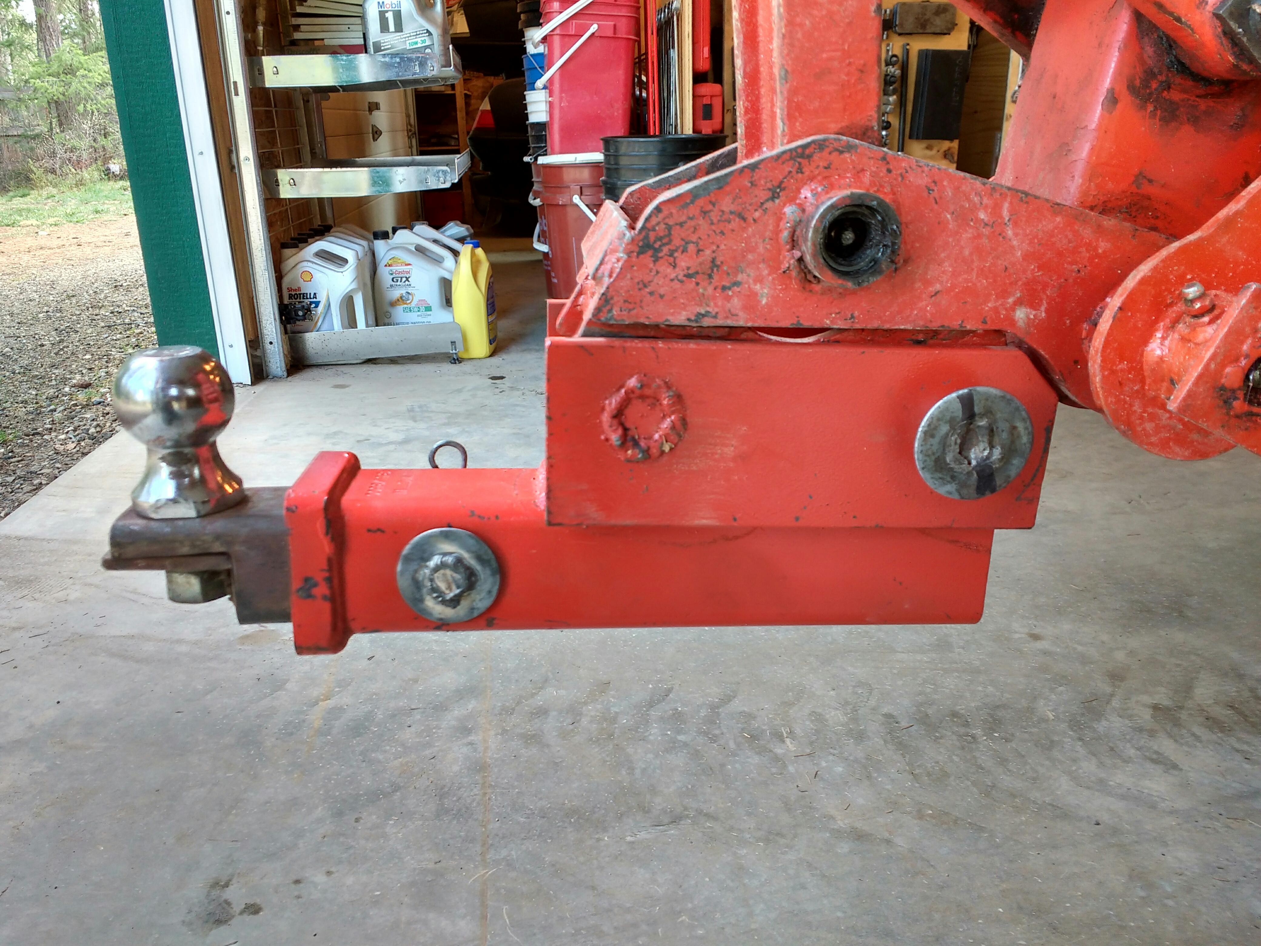

The alternative to buying is making your own, if you have the tools and disposition. These particular attachments are for the BX23.
The quick attach for the backhoe is based on the one sold by BXpanded, took a lot of time but was well worth it.
The ripper is also based on the BXpanded version, again, a lot of time and grinding and abrasive sawing.
Thought a receiver for the backhoe would by handy as well for pulling light trailers etc around the yard

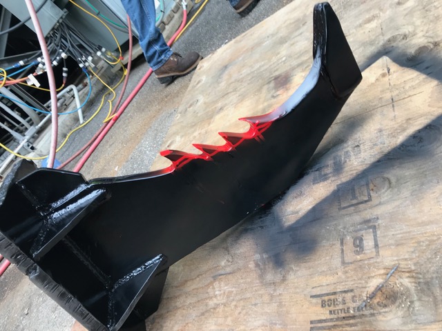

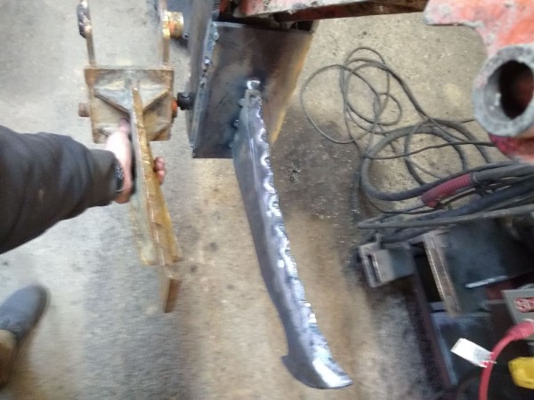

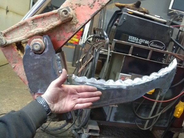

took an idea from the bxpanded company for my bigger backhoe. 3/4 inch plate cut with a plasma cutter on an angle to achieve a pretty sharp edge. Finished it with a grinder and stuffed it in my wood boiler to get it hot then dunked it in oil. I beat it to DEATH trying to break it. No luck, didn't even bend. Very pleased with the results.

/ Ripper Claw #30
View attachment 653991View attachment 653992View attachment 653993View attachment 653990
What's the fish hook on the back for? (Same question for 11B).
/ Ripper Claw #31
I suppose you could make an argument for grabbing a root on the in stroke and then on the out stroke, but really, it just looks uber cool. Its handy for grabbing smaller roots and yanking them out.

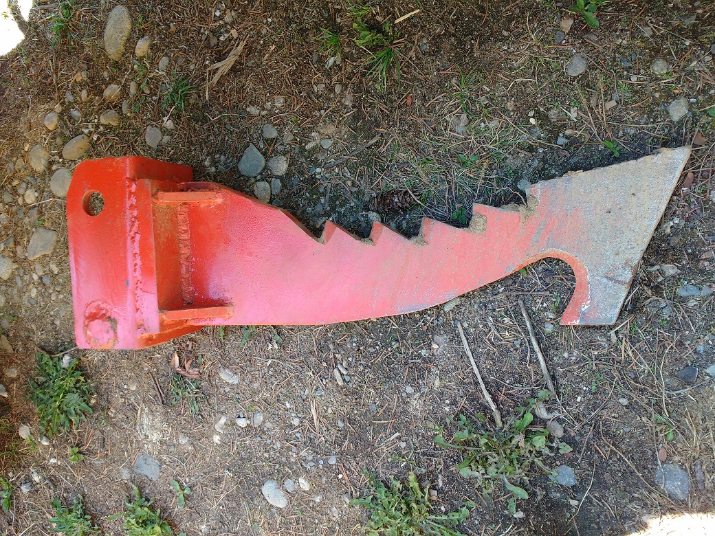

I built mine last year, may add teeth.

/ Ripper Claw #36
What grade of steel are you using that you can heat it and dunk it in oil? I see you're using 3/4" for the toothm what about the rest of the implement? Are you heating the whole thing prior to welding?

/ Ripper Claw #40
I used 3/4 for the tooth its self. Then 1/2 inch on the back plate with a 3/8 plate behind it attaching to the mounting brackets. I welded it all up and put it all in the fire then oil. I buy 99% of my steel as "throwaway" or scrap. Just mild steel stuff. I figured if it broke it broke. But surprisingly it is holding up quite well. Considering no steel company will actually tell you what steel can handle I am just finding out my own way. My plasma cutter only will cut up to 7/8 so this was about as big as I could do since I was cutting on an angle.
