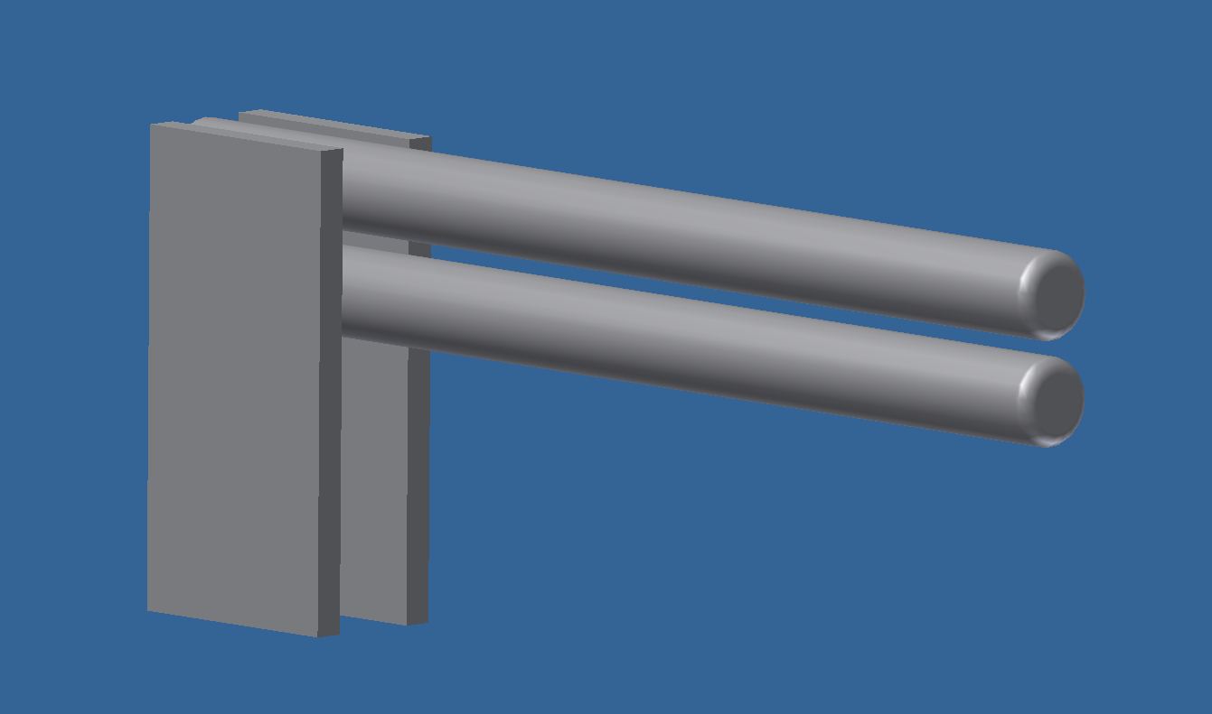

Yeah I have been thinking one of these would be good to have..............I was trying to picture rolling out the lip for a stump jumper on a bushhog.......don't know if I could get it fed in there at the right angle to end up with the correct taper/arc........anybody ever accomplished this?

A fab shop I use has a very simple tool for bending the odd cone. Two pieces of solid rod welded together with a small gap and your choice of mounting base.
Something like this. Just slide the piece in and make a series of small bends by hand. Surprisingly effective.
