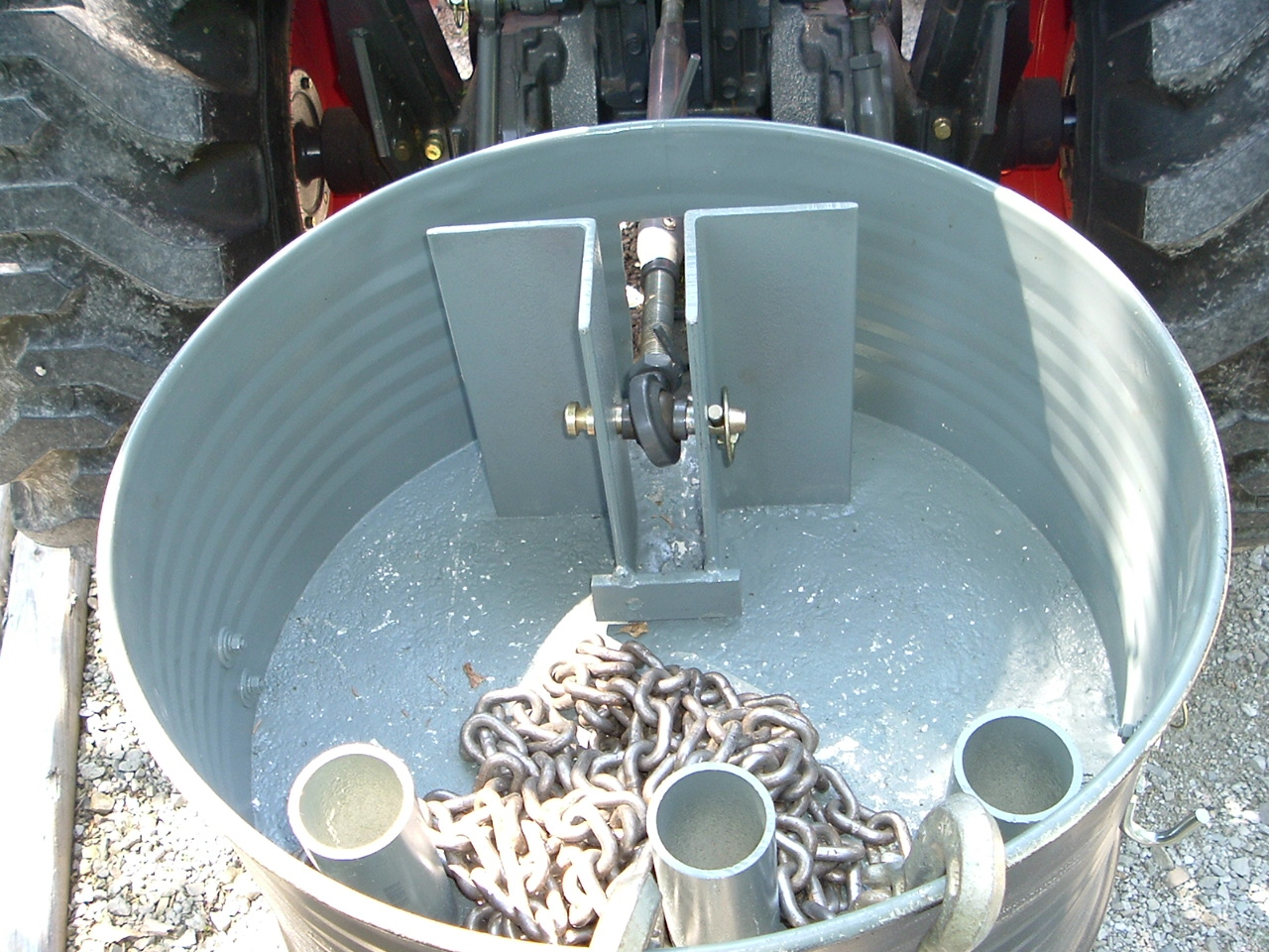

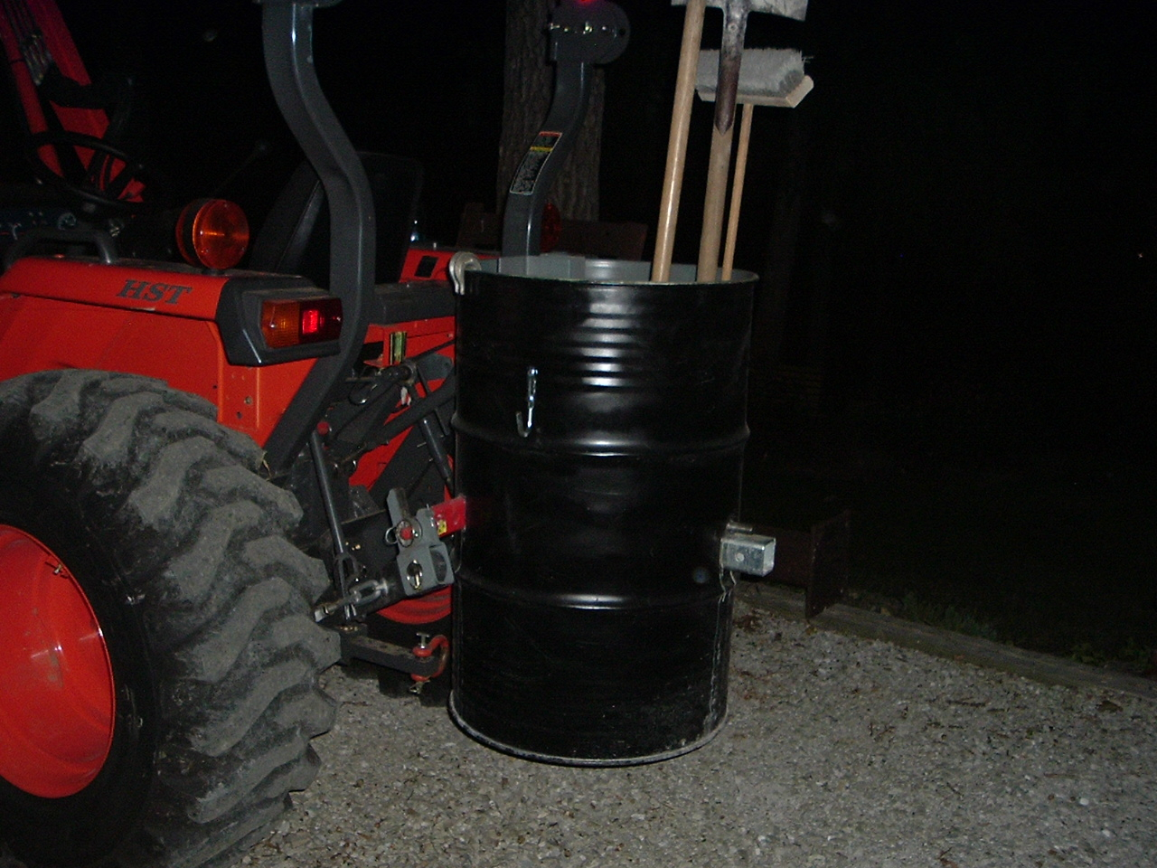

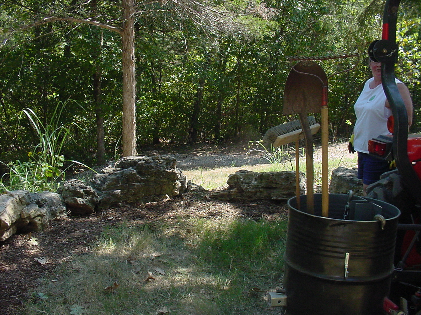

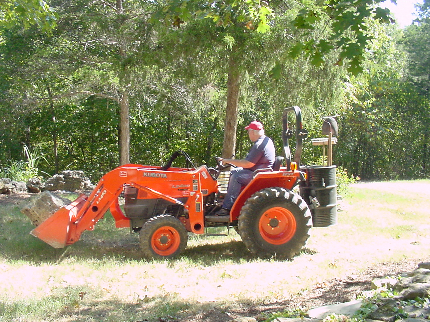

Ballast barrel here. Just some of the same reasons as given by others. Much easier to maneuver in my mostly wooded acreage. It also carries all of my hand implements in the 2 inch PVC tubes as well as several chains. Also has a 2 inch receiver on the back, and hooks on the sides for carrying things. But I can see the other side of using an implement on the back for weight. it is a useful thing on the tractor when you need it. But my rotary cutter sticks out far to much to use at my place. If I had open ground, that might be a different story.

Could you post a picture please.

Ok. lets see what I can com up with for pictures as requested.
