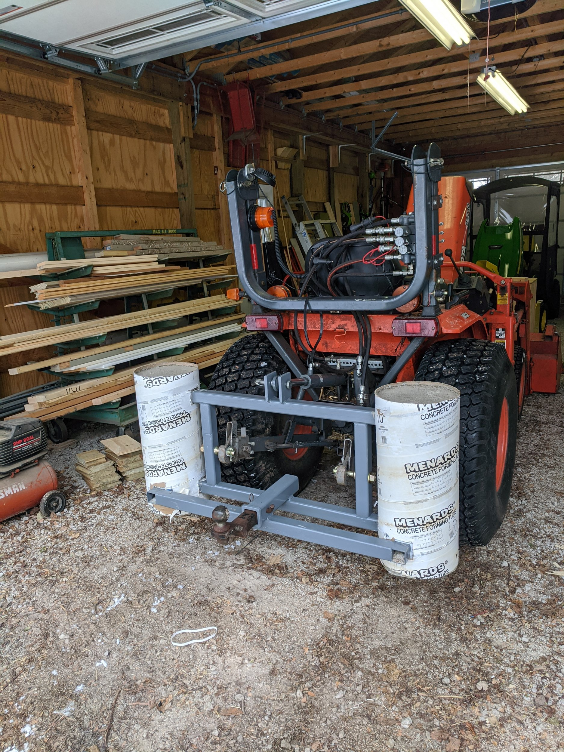

I routinely have to move trailers around and a ballast box has to be removed to do that. Here's the ballast I made, I don't have to remove it to tow a trailer and it allows me to clearly see to hook up.
