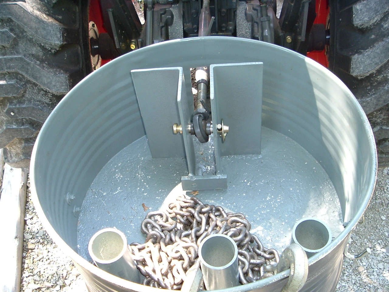

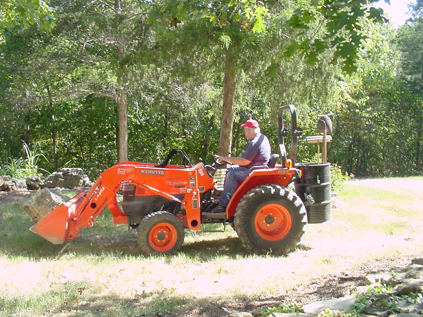

I wouldn't mind having 2 ballast boxes.
My 2720 weighs 1950 lb bare weight. It is my loader tractor and my snowblower.
For snow blowing, I found 600lbs. in the ballast box to be a good balance front to back.
When I have the pallet forks on the loader, I throw an additional 300 lbs. of steel making a 900 lb. box.
So if I had a second box I could have a light one and a heavy one and I would not have to throw 300 lbs. of steel by hand.
But I'm tight with my money so I am sticking with 1 box......until I get "jay leno rich" :)
