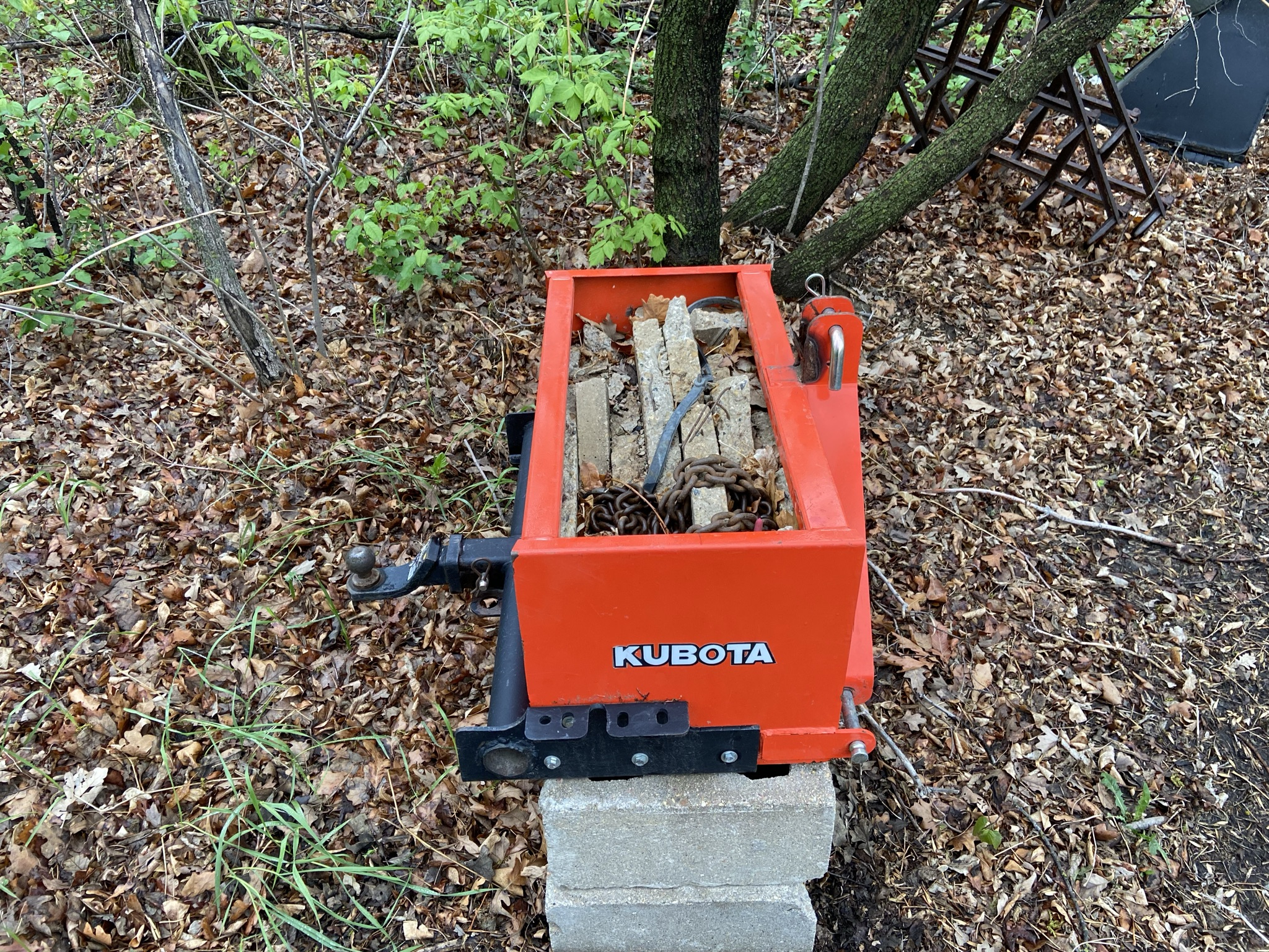

The only time my ballast barrel isn't on the tractor is when I'm brushogging. I poured concrete in a 55 gal barrel and left it down about 4'' so I have room for 2 or 3 chains with me all the time. There is also a place for shovel,rake,chainsaw and gas &oil. Also have a receiver hitch. It's tucked in tight so I never run into anything so why take it off.

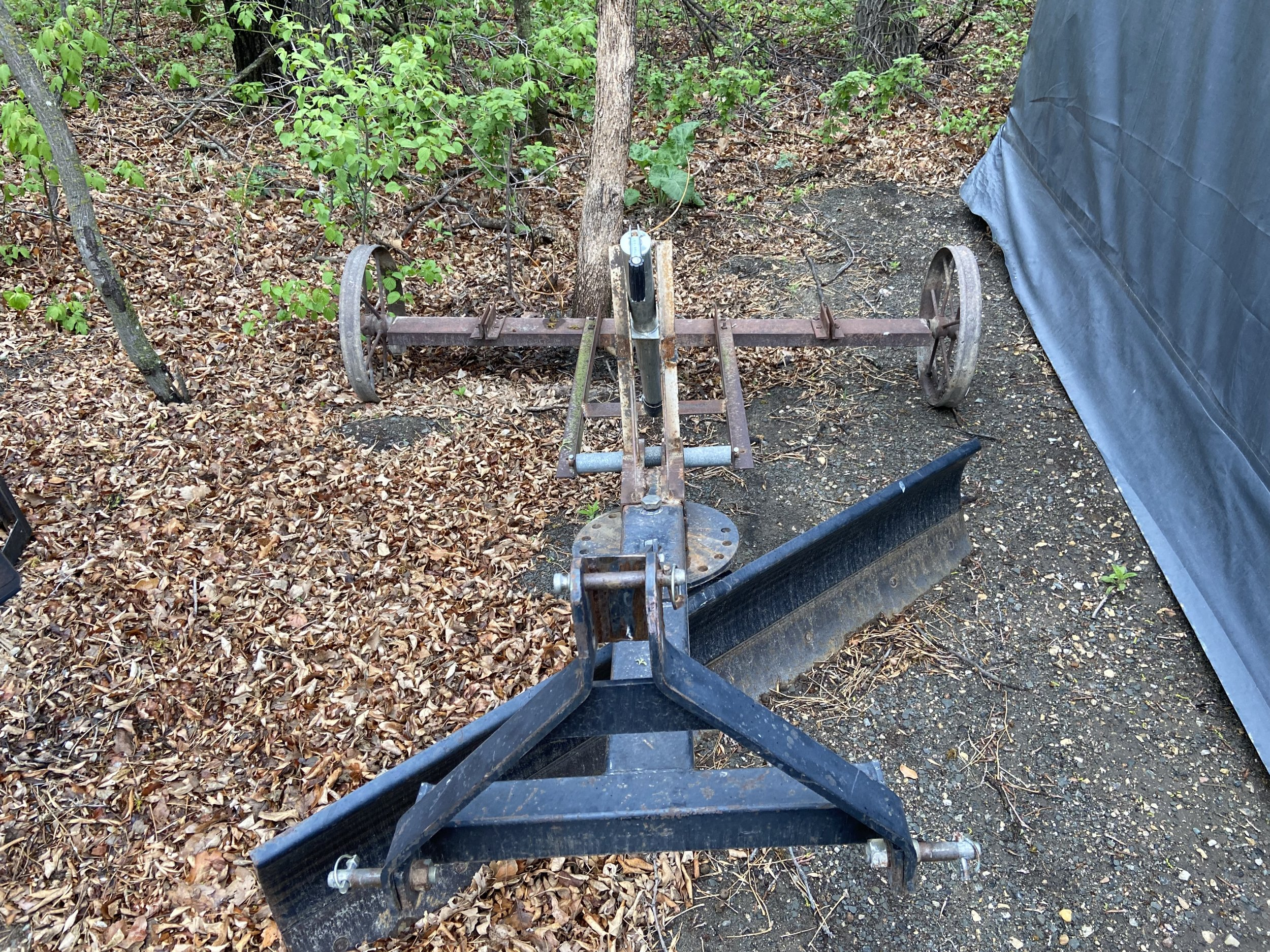

I use a box scraper with added steel plates on for weight and a shelf ontop for my chainsaw, chains for yarding logs etc. A ballast box unless empty to carry things in for me is useless. I also put tubes in and fill my rear tires with calcium.

I use a ballast box because it came with the tractor when I bought it. I attached a hitch to it to move trailers and other things around. I don’t mow with mine and I use a 3pt blade to fix the driveway

Biggest advantage of a ballast box is a lot of weight in a comparatively compact size.
I've got a Deere brand box I've had for years, along with 600-700 lbs. of sand that was in it when I bought it.
Although I haven't had need of it since moving to Vermont (2012), I'll keep it
Some guys use implements like rotary cutters, rear blades (which aren't really that heavy) and such. For loader work, one wants to concentrate on the loader, not what's on the 3PH, especially in close quarters.

A box blade really isn’t heavy enough for sufficient ballast on its own without liquid tires or iron weights.
My BB weighs 1100-1200 lbs. I have 1500 lbs of rear tire fluid. I'm guessing the BB hanging off the 3pt adds more weight than the fluid. But I'm not going to take the time to mathematically prove it. :)
