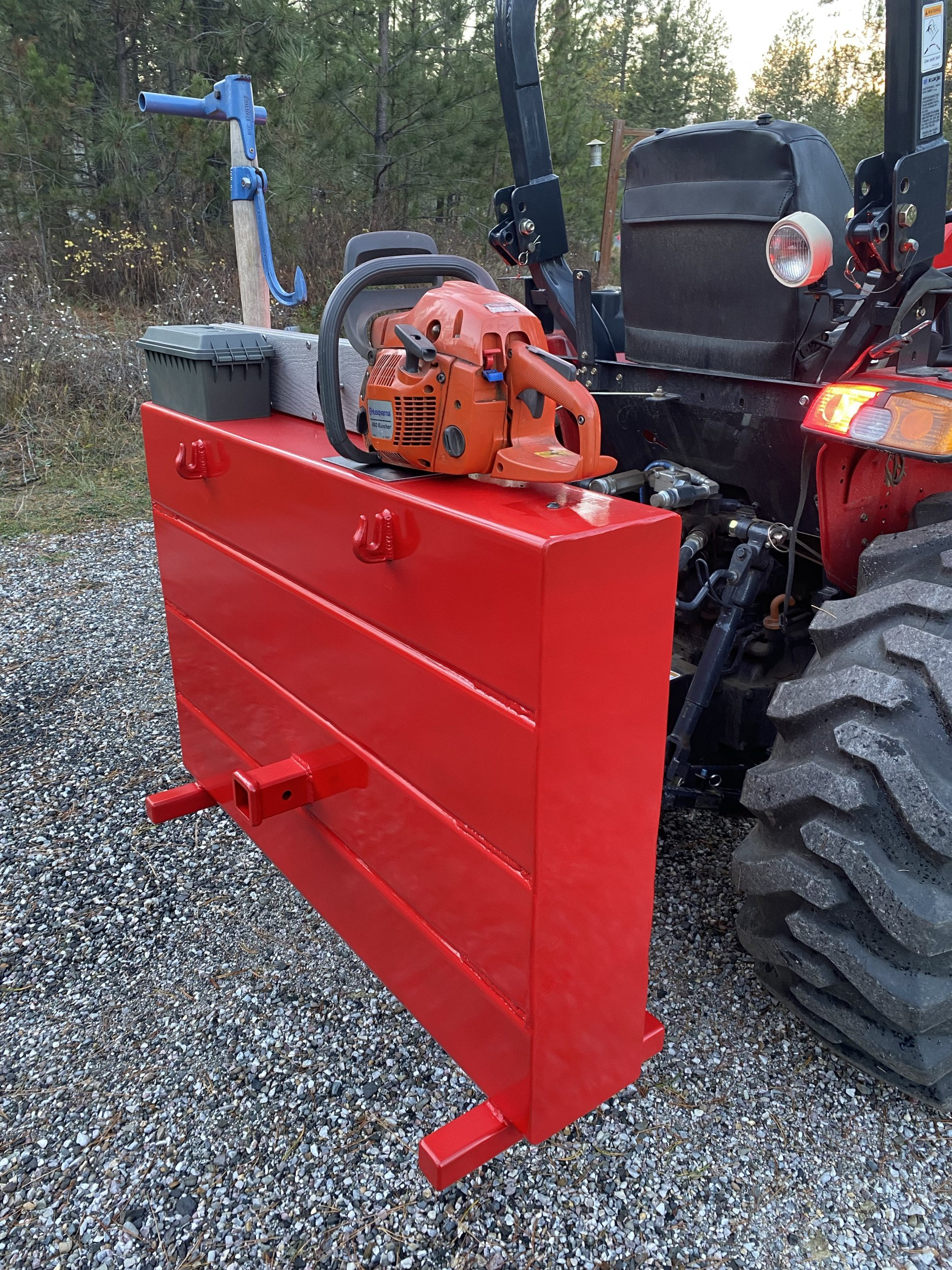

Don't have box blade..... Had enough steel to build the ballast box and the 8 or so bags quickcteet was not that expensive....
20190513_134544-jpg.673989
ballast-box-jpg.660959

I see a lot of people buying 3 point ballast boxes or making ballast containers out of drums to attach to their 3 point hitch.
I have never really grasped why not just keep a box blade on the back so you could have not just a weight, but something that can be used should you wish to drag something? I have seen some weld a section of railroad rail onto the top of a box blade to make it heavier.
Also, rimguard is something I have considered, but I am also not sure about this because it seems I can do everything I need to do without rimguard and it will just increase the amount of weight when I trailer the tractor or perhaps increase ruts when on soft lawns.. I have thought rimguard would be good when using my ditch bank flail mower, but so far, I haven't found myself in any situation I would consider to have been tippy.
So, is there anyone here that added rimguard to their tires and regretted it?

I usually use a box blade for ballast, but bought a ballast box for one job, leveling out a barn floor between 6x6 posts on 12 foot centers. My box blade is 60" the ballast box is about 28". Effectively rounding the corners of my tractor as I brought in the fill material for rough grade and finish grade.
   / Rim guard or not? Why a ballast box instead of boxblade? #14
Ballast barrel here. Just some of the same reasons as given by others. Much easier to maneuver in my mostly wooded acreage. It also carries all of my hand implements in the 2 inch PVC tubes as well as several chains. Also has a 2 inch receiver on the back, and hooks on the sides for carrying things. But I can see the other side of using an implement on the back for weight. it is a useful thing on the tractor when you need it. But my rotary cutter sticks out far to much to use at my place. If I had open ground, that might be a different story.

Because a box blade can’t tow a log splitter, carry my chains, chain saw, pike, logging tongs, and small tools while providing the same amount of ballast in a small footprint.

I’m pretty sure if you have the equipment to build that box that you’d be able to weld a receiver and a few other options on a box blade.

Sure I can weld a receiver on a box blade plus a few options but that’s like putting a dress and makeup on a pig.
