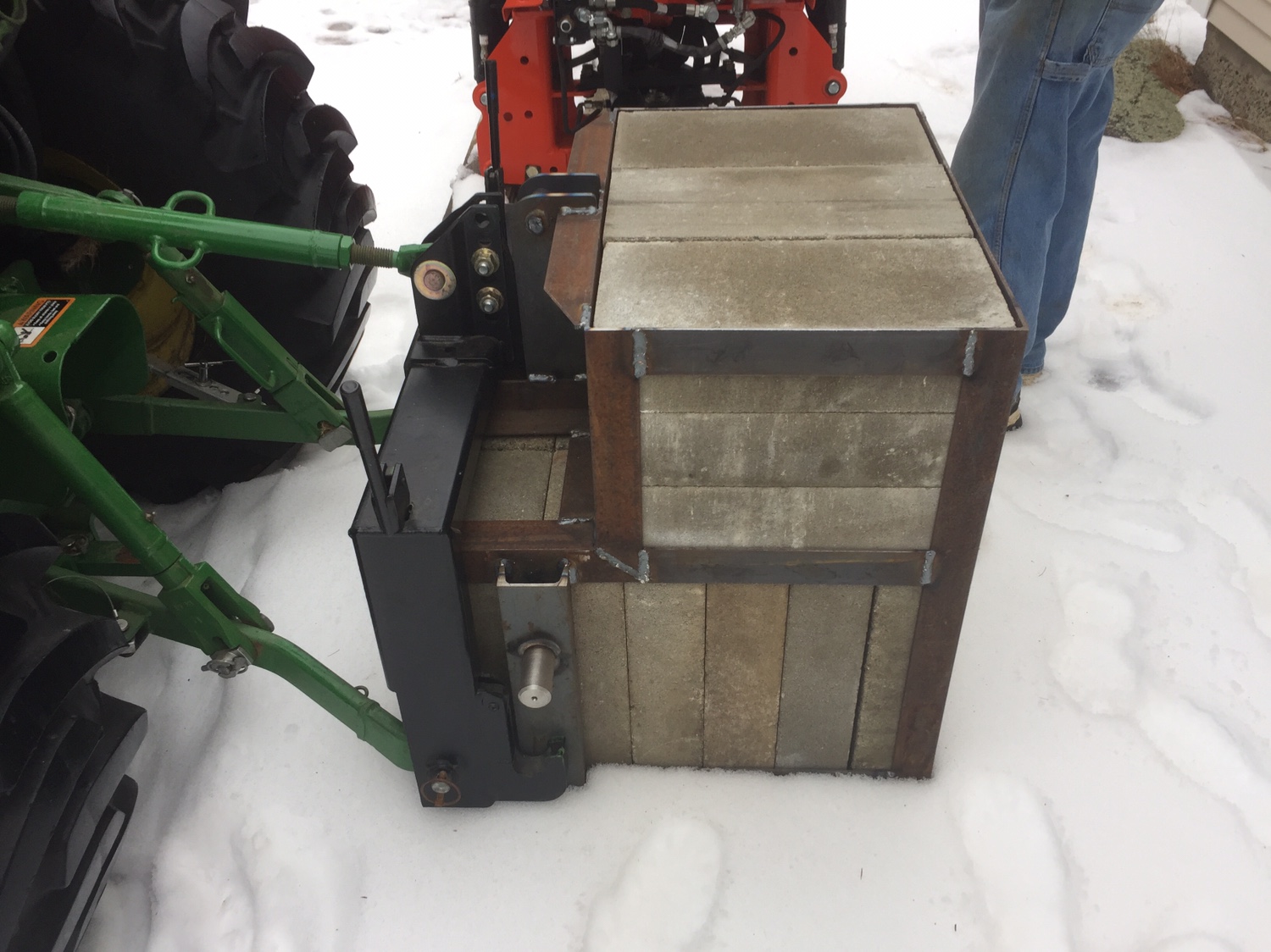

For general use my tractor doesn't need a counterweight. It has loaded tires - Rimguard I believe - bought the tractor used... As noted, extra weight is deeper ruts and i suppose extra wear, though with the low hours I put on, can't think it matters. However, when you are picking up the max, I need more than a 500lb extra on the back. I offloaded a new to me drill press last year that is a full 2000lb, and i was surprised the tractor would even pick it off the trailer deck. Without a counterweight I'm betting i would have just face planted when picking the load.Mine is 1000-1100, give or take, and you can take the blocks out and move the frame easily if needed, but I just let it sit outside as-is. it literally takes seconds to attach and it was cheap to build since i already have the equipment to weld. My backhoe would be a suitable counterweight, but it's got an awkward tail swing and takes a lot more time to put on. Still haven't got around to painting it yet...

I see a lot of people buying 3 point ballast boxes or making ballast containers out of drums to attach to their 3 point hitch.
I have never really grasped why not just keep a box blade on the back so you could have not just a weight, but something that can be used should you wish to drag something? I have seen some weld a section of railroad rail onto the top of a box blade to make it heavier.

I have all of the above and I just think it depends on what exactly you are doing. Why not have all of the possible options. I have a 1200 lb. ballast barrel and a 750 lb box blade set up. Most times for dirt moving activities the box blade is more than able and a welcomed tool. If we are talking about moving big wood in the forest you might as well have the ballast barrel with built in chainsaw sheath and cant hook.

Good points about maneuverability. I have used my snowblower for ballast when lifting 1/2 cord totes of wood ...it weighs over 900 lbs. Plus, I have loaded tires. But I have dented the blower once so far.
I am looking at a ballast box and the cheap ones are under $300. Say another $50 to fill it with 800 lbs of stuff...not very much money.
I have looked at adding a box blade. The HD one was 500 lbs and $1300. I might use the BB once every 2-3 years. It would be nice to have but hard to justify.
You need to think about your situation and see what makes sense.
I recently found a place to buy tractor stuff and much more, called VEVOR.
First bought clamp on bucket forks for about $180. they worked really well, wish I'd bought a set years ago. Then before Christmas they had a weight box on sale for $162+frt.tax. My wife got it for me for my big present, came in looks great, haven't used it yet but will soon as we get a good snow here. I do a fair amount of fabrication so I know I couldn't buy the steel to make it myself, plus labor etc.!!
