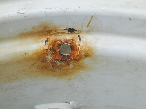

Plus I have seen all kinds of pictures posted here at the tractorbynet site with corrosion damage done to rims that have used fluids in the tires. Cast iron adds no corrosive value to the rim itself.
Still some mighty good reasons for choosing wheel weights over fluids if you ask me. This is just my two cents worth mind you.

Kelvin I have seen a lot of discussion regarding damage done to tractors with acid splashing on various tractor parts. In these cases most opt for a sealed battery such as the Optima to eliminate further damage to their expensive investments. If there are known problems most folks find a solution that will reduce or eliminate the likely event of further damage.
So back to the damage at hand caused by fluid filled tires, will I be putting this stuff in my rims with the investment that I currently have? NOT very likely in this lifetime. While I am sure that there are some very good arguments for fluid filled tires vs. wheel weights I can't justify carrying the load 100% of the time not to mention damage that could result to the tractor itself.
I wish you the best of luck and hope that you never encounter any of these problems yourself.
