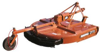

LoneCowboy said:
driving it onto a trailer should not (and has never with a bush hog) bend the entire wheel sideways.
I would have liked to see a video of you loading your cutter. You can say what you did, but if it bent, you must have been doing something incorrectly.

With ONE out of three bent wheels narrowed down to PROBABLY being done while loading, but unknown as to exactly how, and the other two totally unknown as to when, why or how, NOTHING can be ruled out, including the POSSIBILITY of operator error. But until it's known when and where they're being bent, all is pure conjecture. And if I'm reading Brians (LC's) post correctly, he THINKS one was bent while loading, but not knowing how would indicate that is more a guess than a given.
All things being equal, I'm still at a loss as to why a brand with great marks from almost everyone would continuously cause troubles for one person. Brian, we need (at least) a photo of the aftermath. Maybe that would give something to go on.

I think you have your toplink adjusted improperly (too long). I don't think it's allowing the tractor to acheive enough upward angle in relation to the mower, without all the stress being transmitted into the tail wheel (this would be evidenced by the damage occuring when you put it on the trailer) The Rhino I have has a rather small amount of travel in the toplink, in relation to some other designs I've seen. If you don't get the toplink shortened enough, then the toplink "bottoms out", so to say, when the tractor begins up an incline.

With an open eye, compare the tailwheel on a rhino to a bushhog, the difference is notable to the naked eye.

Are you just mowing a level field and you look back and out of the BLUE the back tailwheel is bent ? Three times? Could it be you wish you had bought Bush Hog and need to justify selling the Rhino ,my Rhino is 6 years old and I let my neighbor borrow it and have had no problems.

Hey Brian, these guys are kinda tough on a working stiff trying to make his equipment pay for itself. I got a deal on a 7' montana brand, not sure who makes it for them. Been a good mower this year other than i'm bending the tw same as you. Gopher holes have been giving me fits, i've had to straighten it twice and it needs it again. Not blamin the mower, but i can gurantee that next season it won't be bending there again, probably just transfer the load and bend something more expensive, oh well. It sure does cut nice though.
I also have a tilt bed that i use, 22' and I haven't yet had the priviledge of seeing it bend there. i do know that if i'm not parked level it can put a heck of a load on the tw even with the top link pulled in all the way. sure hope you get your tractor problems worked out, downtime is a killer. this was my year for it also. good luck and i'm sure nh will make it right for you. Ron

3 out of 3 bent tw's would also tell me that the equipment can't handle the environment i'm working in, I don't think I would go so far as calling the whole mower junk but the tw sure is for the application he's using it for. In this day and age odds are some bean counter decided with the high price of steel that tw would be a good place to save some cash. Still plenty strong for 95% of users. I'm also having tw trouble but just accept it, It will be modified this fall and hopefully that annoyance will be solved. Probably built in the same shop.

But is the Bush Hog the same length? That can make a huge difference in how much leverage gets exerted on that tailwheel when you load/unload.
