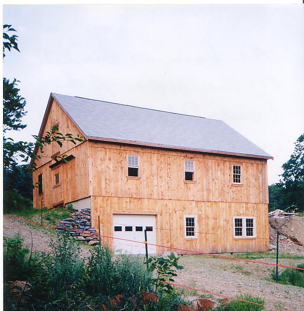

Easy is good. In the time it takes to make a set of concrete forms, grease them up, use them, tear them down and _then_ attach foam to the concrete you could have erected the whole greenhouse/w3tcompact/icons/smile.gif As far as losing the concrete as part of the thermal mass, I'm planning on a 12' X 18' greenhouse. The percentage decrease in thermal mass (under 10%) is probably a fair trade for the extra R-10 on the insulation.
I'm planning to use R-3 twin-wall polycarbonate for all of the skin, even the north side. It will be in a protected area (in front of the new barn) with full southern exposure all winter long. It's really and ideal location, with water and power. The only problem is that I have to tear down the old horse shed that is currently on the site.
I haven't done all of the calculations, yet. I suspect that I will be using two six inch risers and a six inch manifold on each end. I'll use four inch perforated pipe as runners spaced as closely as possible. The runners will be interleaved to cover as much area as I can.
The guy in the next cube is a thermal engineer. He'll be helping me to size the pipes and blowers.
I'm planning to use aluminium flashing as a UV/root protector for the exposed foam. It should start behind the twin-wall, cover the foam and extend 10 inches into the soil. That should take care of any grass roots.
