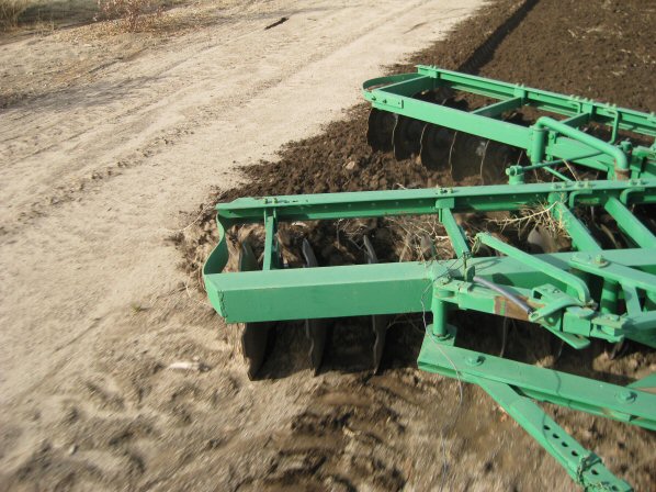

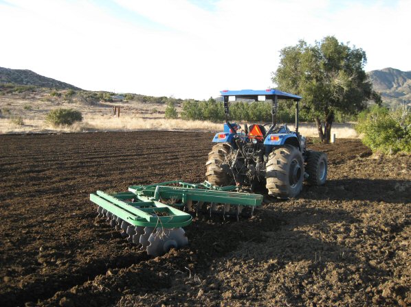

wolc123, I will ask again, would you please show some pictures of your current setup? Here is what I use, mine are old John Deere-Kilfer disks. Weigh in at a little over 100lbs per 22" blade. Usually cut 7"-9" deep when I disk, sometimes a little more if I end up going over the same place multiple times. I use them for fire & brush control and do not care if the ground is flat and or even. I typically use our old Cat D6 to pull the 12 footer and my Mahindra 7520 to pull the 8 footer.

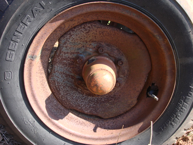

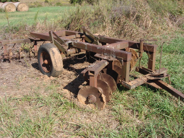

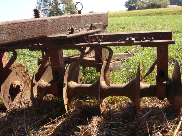

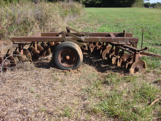

I finally pulled this old disc out into the light of day. It is a Series 166, as stated on the frame. I have not had a chance to actually pull it to see if the gangs will spin freely. The wheels are shot, all rusted out, with the tube showing. So it definitely will need new wheels and tires. The discs really look decent, except for one broken on the outside rear. I guess there is no reason not to pull it and see what happens, even without the transport wheels. What do you guys think about this and where would you start? What would you expect it needs to get it going?
And, do you think I have enough tractor to pull it? (70 horse Kubota M- 6800 4 WD with loaded rears). The owner basically will let me do whatever with it (he has no need for it as he has way nicer implements) He stops short of giving it to me but I can use it as if it were mine. He also has an old Allis Chalmers 4 row planter, but that is another up-coming thread.

If hes not giving it to you,...Id be sharpening my pencel, and figuring all parts before starting, Hopefully the blades turn and you dont need a pile of gang bearings, cuz even generic bearings are $$$$, Id pump em full of grease and see if they roll, Before I started tearing into it,.. Id see If he will pay for parts, or split the parts bill, If you end up rebuilding that, Its also a WHOLE LOTS a labor , And If its not gona be yours when your all done,....Iam just sayin,. Eric
   / Restoration of an old disc, any advice? #39
If he is not giving it to you and is not willing to pay for the parts, I would just leave it be. :( I'm sure that it needs new disk blades, those look like they are about warn out from what size should be on there,(probably 24" pans) and everything else that it needs, you will be into it for well over a grand and that is a lot of work and money to put into an implement that isn't even yours. I don't know what your ground or terrain are like, but I doubt that your tractor is going to pull that disk when it is disking earth up to the axles. Yes you can use the transport wheels to control that, but don't you really want to be able to disk to full depth?
Just my opinion, but from the looks and sound of the deal, I would just pass.
Just my :2cents: good luck with whatever you decide to do.
   / Restoration of an old disc, any advice? #40
Hey I do have that exact same disc. I would try to pull it and see what happens. Just set up your trial so that you go straight and turn your tractor to the left. If you turn to the right with the lift not working it will really dig in and put a big load on the tractor. The discs are almost gone so it won't go very deep but the angle of the axles is set very aggressive so you will be turning lots of sod over. I would try it out before I attempt to grease it. Being abandoned this long whatever grease is in there is dry and hard. If you try to grease later I would suggest to replace each grease fitting with a new one. Watch out for wasps they like to nest in the access holes. Just be sure non of the discs are loose or wobbly on the axle.
