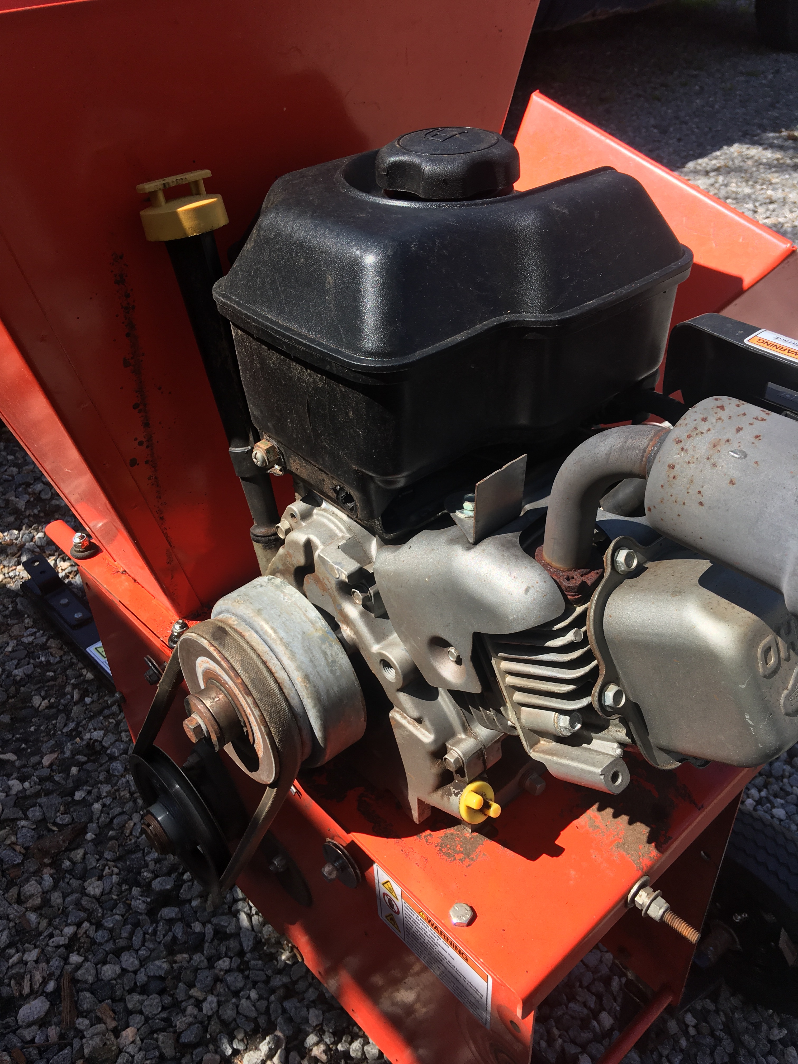

Hey Peter , I’ll see if I can get the clutch off tomorrow and measure the shaft . I’ll be sure to reply . The machine is somewhat of a novelty but when I’m trimming branches it’s kinda nice to throw them in the chipper rather than putting them in a pile for later . Love to get this thing working .

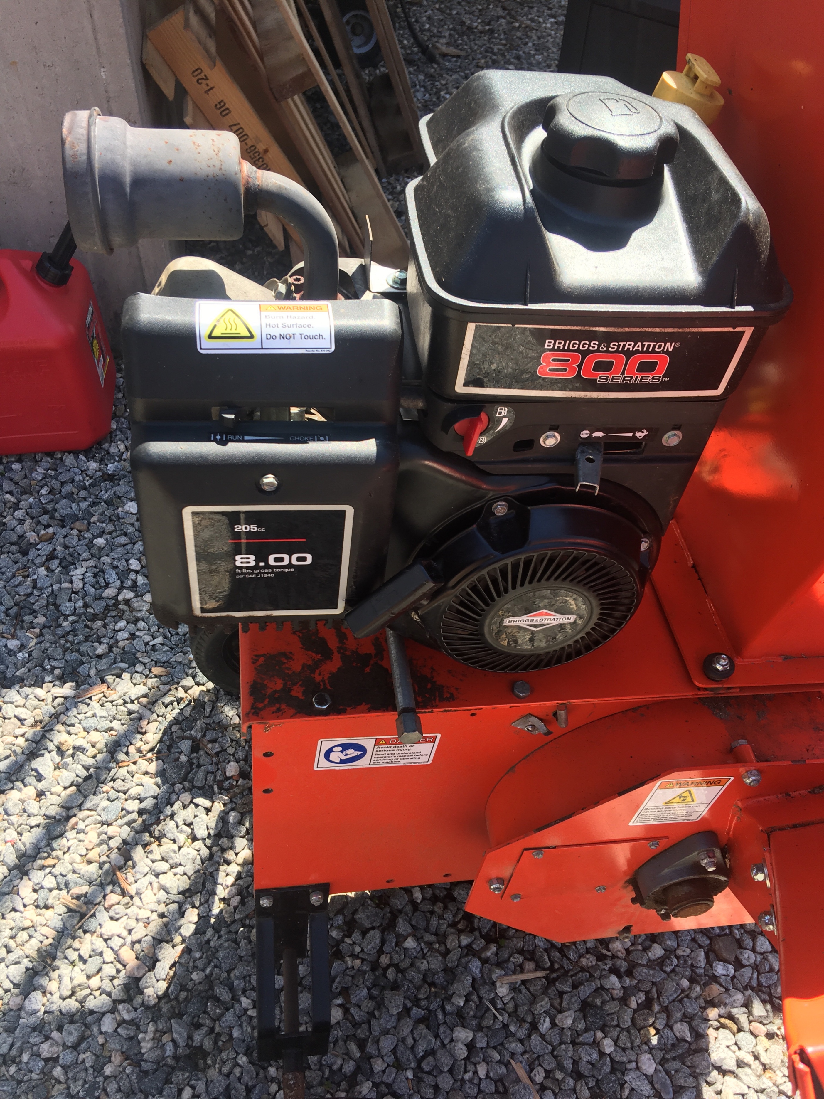

It’s an 800 series model #
1263 12 0141 B8
I think the code is
100 805 88
I live in East haddam ct .
Thanks all , you’re awesome with the responses !
Recommended Briggs engine replacement is a 15T212-0160-F8 1 x 2 57/64 crankshaft with 1/4 in keyway and 3/8-24 threaded List for $310 through the Briggs dealer network.

So I checked the shaft and it’s 1” . Length looks to be just under 3” . Based on that this motor will work and it’s a great price . Now my concern is the key way . It is 1/4 on my motor and clutch pulley. The amazon motor specs state 3/8 . Any way around that ?

I checked northern tool with the model #s given me and the same motor listed on amazon specs 1/4” for the key way . Am I loopy or is this more confusing than it should be .
/ Repower DR chipper shredder #32
Amazon may simply be wrong. Or they may have an oddball some 3rd party is trying to get rid of.
/ Repower DR chipper shredder #33
I think you are confusing the 3/8 listed as the keyway but they are referring to the threaded bolt hole is 3/8 From the specs I listed in my previous post it has the 1/4 keyway and all my specs came straight from the Briggs dealer portal website.

With the help I’ve received from everyone I’m gonna pull the trigger and order the Briggs from amazon . Worse case scenario I’ve bookmarked the info for the stepped key . Everyone along with this site is awesome ! Thank you.
