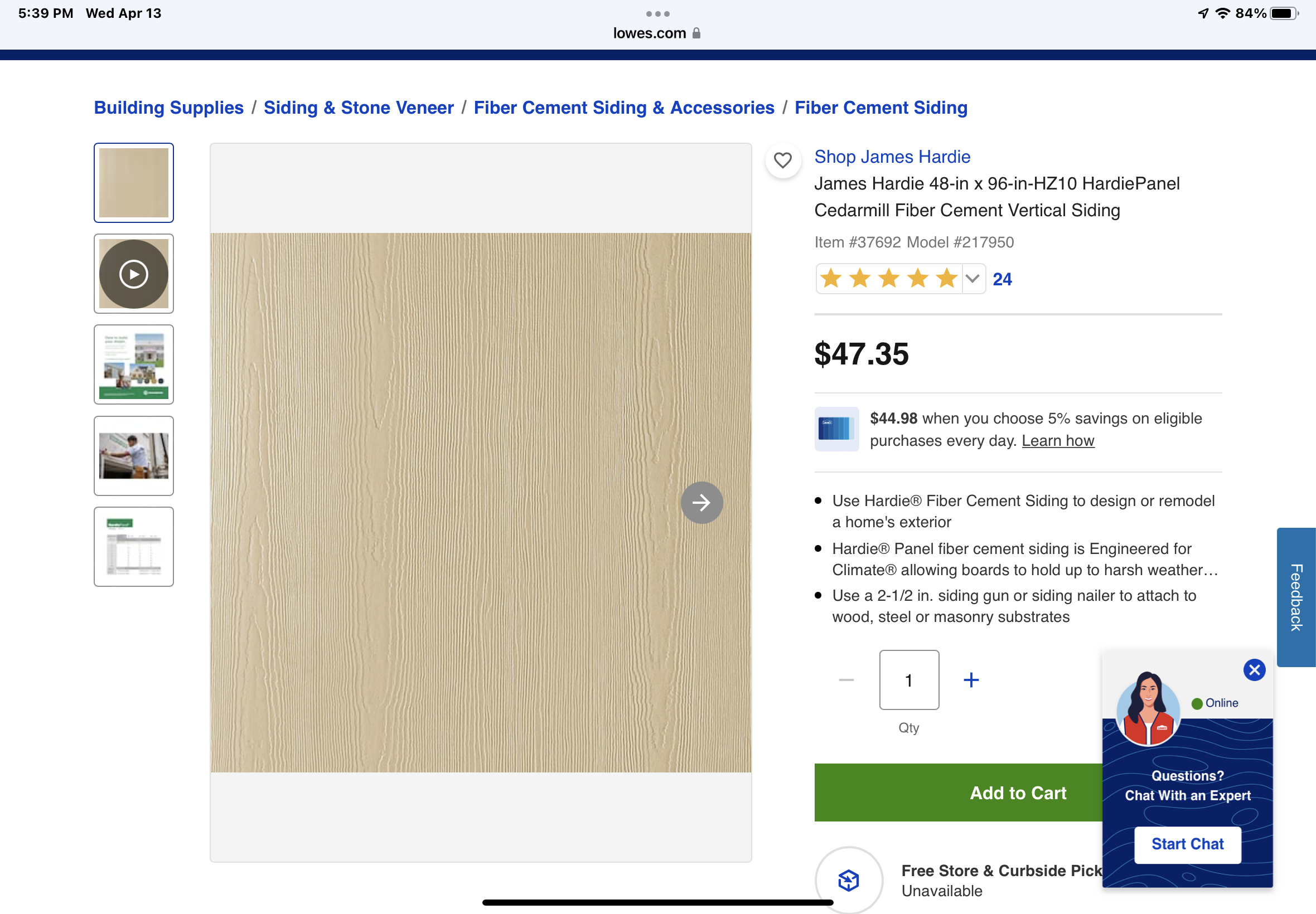

I would agree the lap siding would be easier for me to do by myself but I think it also increases the cost substantially.
/ Replacement Siding for Detached 2 Car Garage/Workshop
#14
If I'm figuring this right then the LP Lap siding would actually be a little cheaper and easier for me to do by myself
4'x8' sheet is 32 sq ft at $43.50 a sheet
8"x12' lap siding would cover 8 sq. ft. x4 would equal 32 sq. ft at $9.96 each x 4 is $39.84
Did I figure that right?
Is there any additional material needed to do lap vs sheet that would increase the sq. ft. price?

4x8 sheets heavy to work with. Lap siding easier for the solo worker. I've done both.
Any other Pros and Cons of the two? I would be hiring out the install so labor cost will be a factor. The 4 x 8 sheets just seem to be a ‘cleaner’ option. Fewer exposed seams or overlaps for long term maintenance (cleaning & painting) and a simpler install. Am I missing something?
Sorry if I’m hijacking the OP’s thread.
#19
The problem I see with the 4x8 sheets is lots of exposed nails. Around here they fill every nail hole and seam with caulking. With Lap the majority of the nails are hidden and should make for a cleaner look and less caulking
