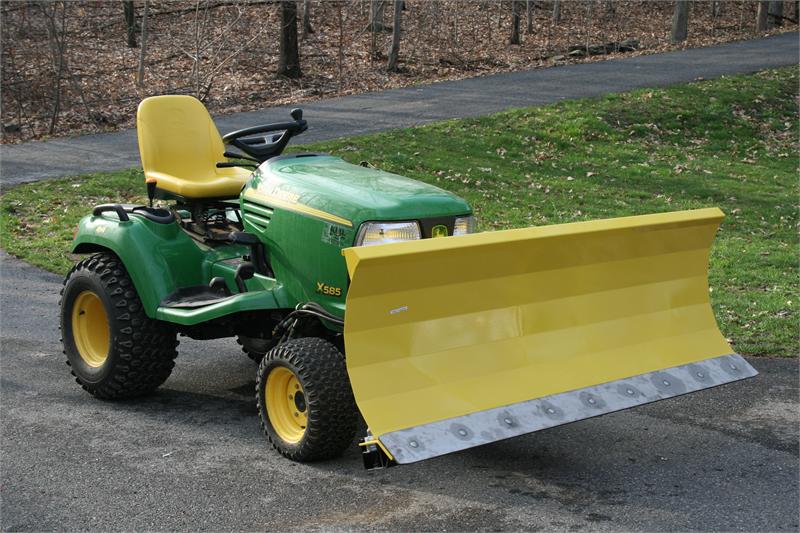

I don't think your tractor would be able to lift that blade in the link. That is a heavy duty truck blade.
It is only a 72" blade and it is made specifically for the JD quick hitch. They show this thing mounted on some much smaller X series tractors.
/ Replacement Blade for JD 54" Front Blade #7
it does make an X585 look small huh?
I doubt that the X series will be able to push much with it, but the 2520 is a much more substantial tractor and I have weight and chains. The most frustrating thing with the 54 blade for me is my circular driveway. When I turn, the wheels are outside of the cleared path so they start to ride up on the snow and now the blade is not level so less snow is being cleared on the inside of the turn so now it start riding up even more. I end up doing a lot maneuvering instead clearing the circle in 2 or 3 rotations.
The 2520 is 51 inches wide so it does not take much of an angle for the blade to get narrower that the tractor.
Oops! Missed that, and was going by pic alone. Too sleepy, I guess.
