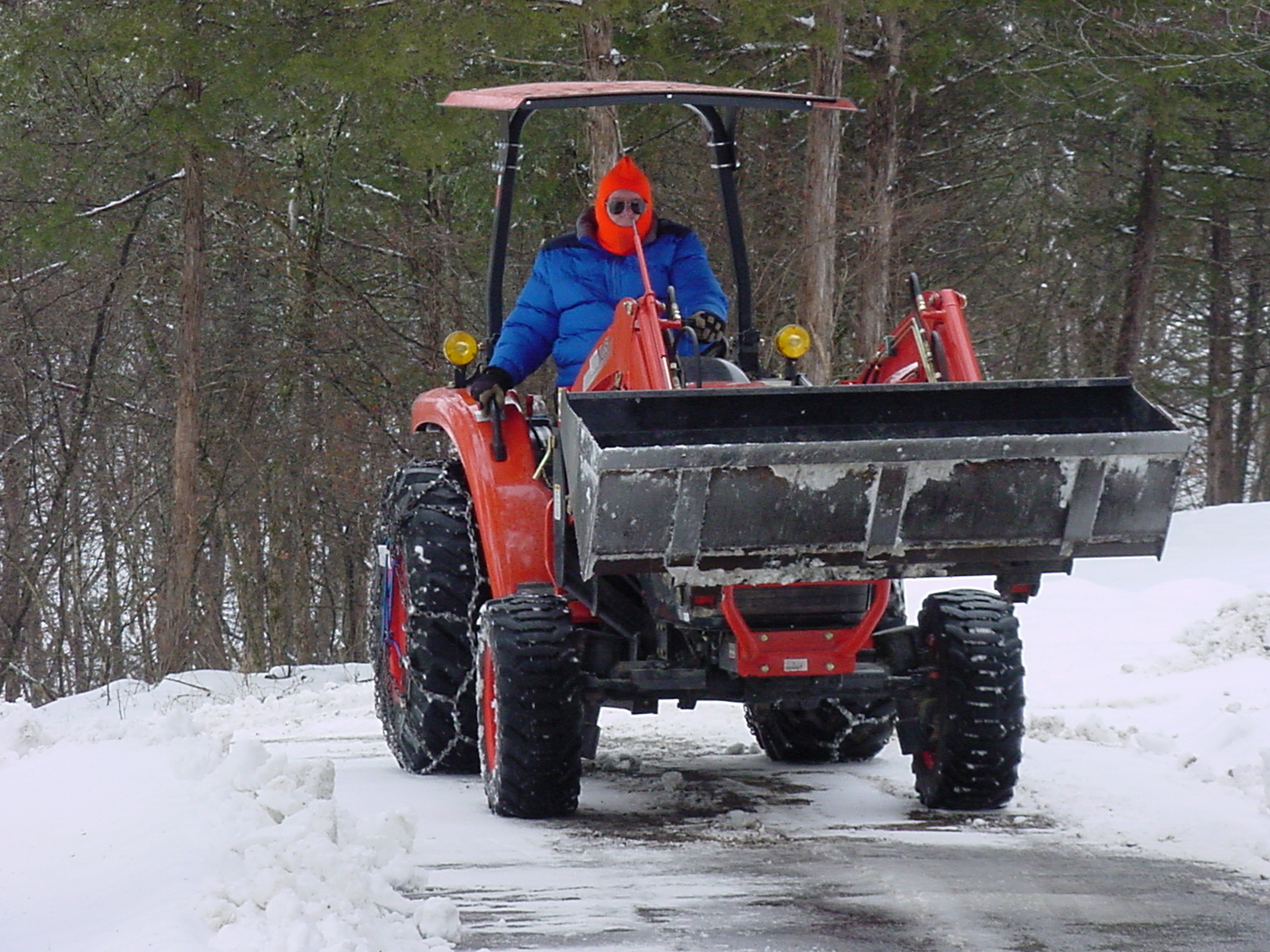

We use chains here on my R4 tires to go up and down my icy hills in the winter. Chains are not fun to put on and get adjusted but they make a world of difference in icy conditions.
