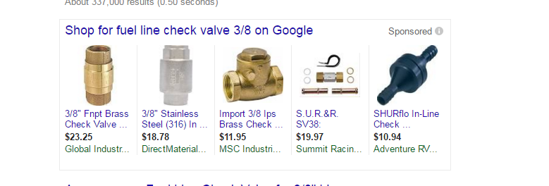

If it was my tractor I'd speed that $80 on an electric fuel pump instead of a $80 seal. To correct fuel bleed back one could also install a fuel line check valve similar to one in photo.
